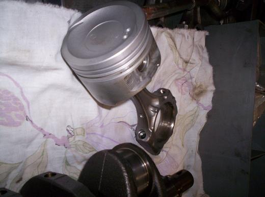

  4. Yeah they are the stock pistons. Came up realy clean. We used chevy solids they were the right size. The lifters seem to be common size in Kmotors as these are the same size for 4 and 5k.

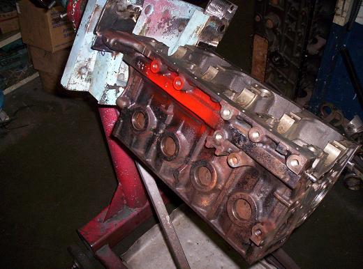

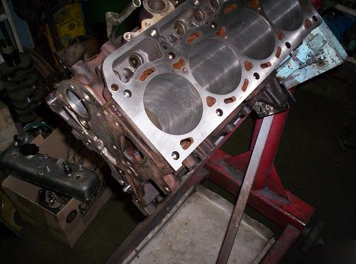

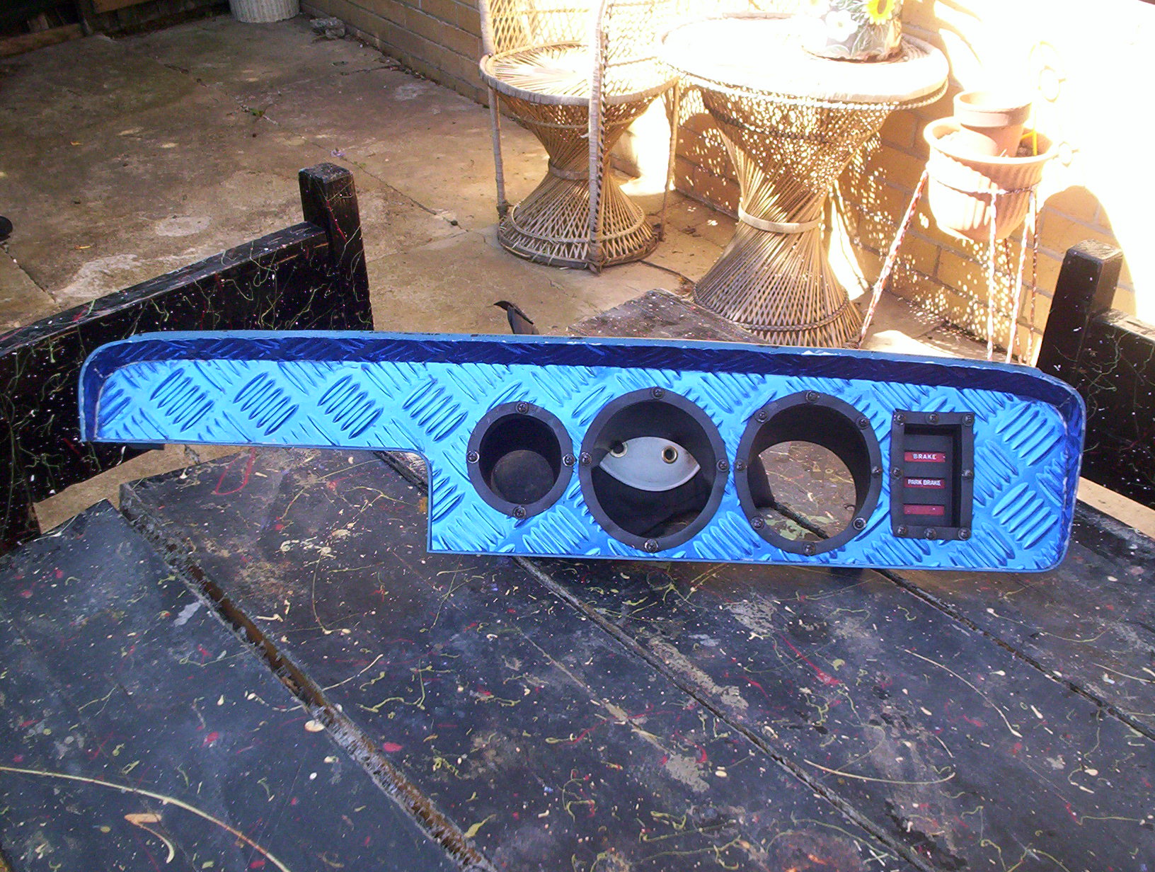

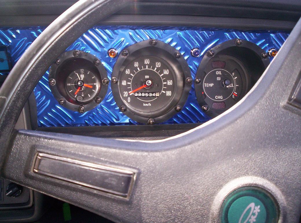

  5. A few picture updates The instrument panel installed indicator and hi beam The block is going to be RED the honed block and cleaned piston

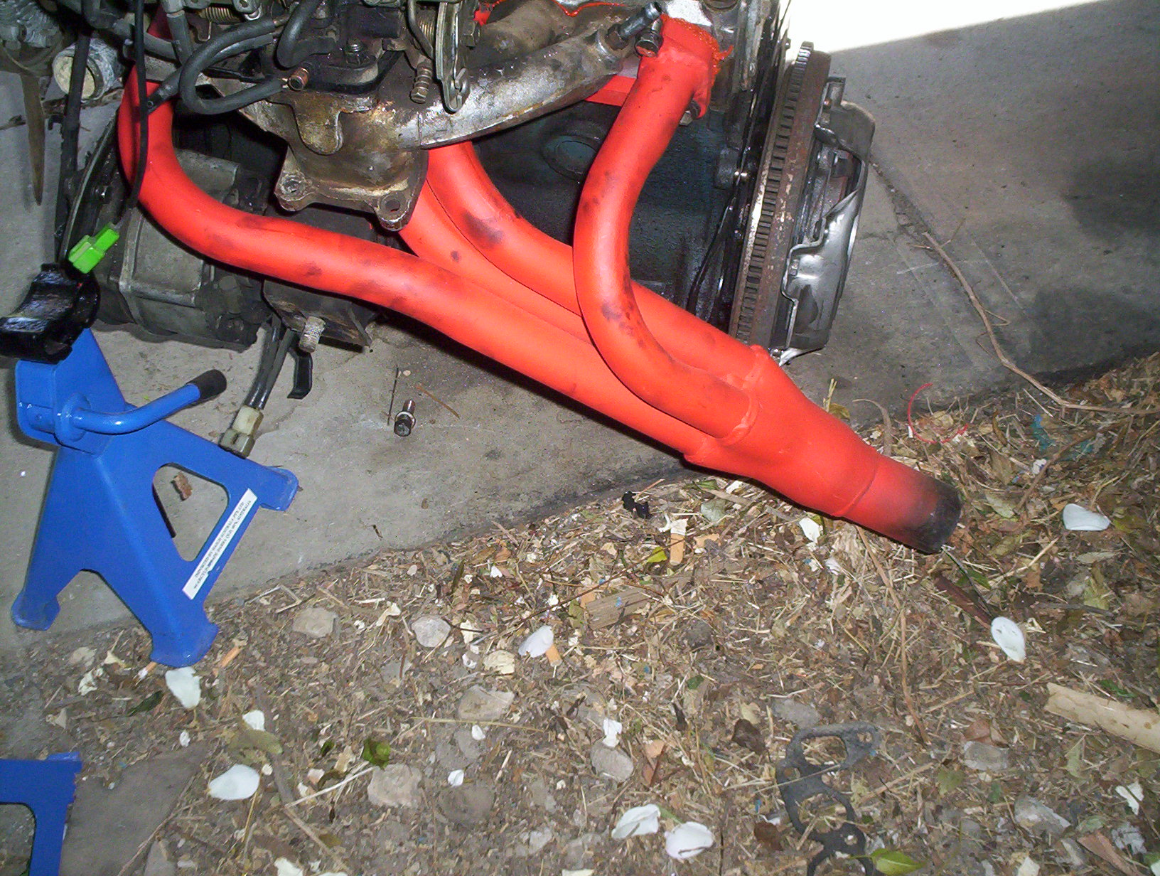

  9. Kanga's on the ball. We're going to run twin su's I don't have exact specs forthe motor yet I will put it all together and post it about mid JAN To be honest I'm hopeing for 140 to 150 HP With the extractor paint I have had mixed result's Cooking them after painting helps. Take all the shelves out of the oven and shove them in. Start at 50 and raise the temp 50 every half hour to 300. after that the car will bake the rest. It never hurts to try,

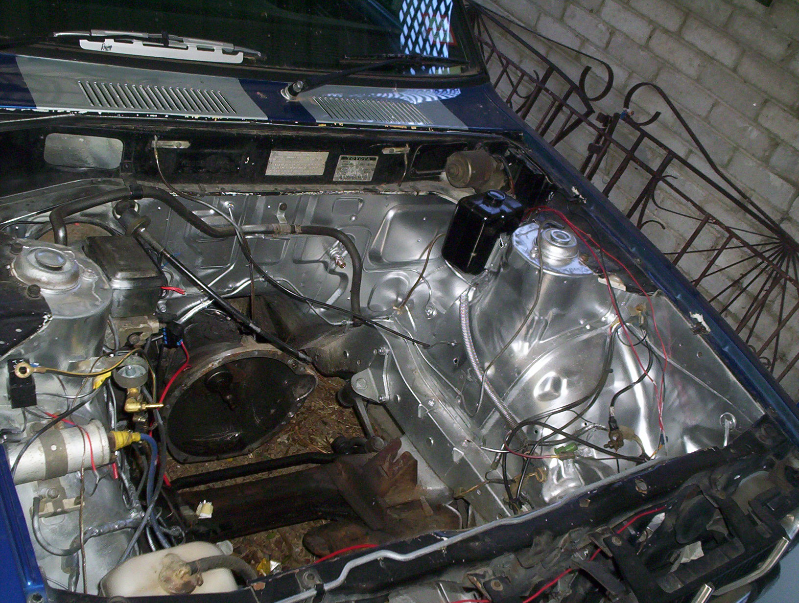

  10. I used VHT 1200 deg paint on the extractors Same people do paint for blocks at 600 deg I don't remember the brand in the engine bay it was a hi temp paint.

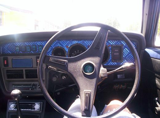

  11. Yeah! I just cleaned it as best I could washed it with prepsol and used cans. Anything was better than how it looked. I'm not holding my breath on it lasting. After I took the pic of inst panel I put a rubber edging around it. A blue led in a chrome holder for hi beam and 2 yellow led's for indicators. 5 blue lit rocker switches where the radio had been for the neons in and under the car. I will try to get a pic during the week.

  13. Instrument panel Extactors Engine bay

  15. G'day guys and girls. I haven't been on lately as I've been trying to get the cars finished for christmas. I've finally sorted the smoking problem with the Mercedes and cured the auto problem at the same time. It seems the vacuum modulator on the auto was stuffed and was sucking the trans fluid straight up into the manifold. Now thats fixed it gets new injectors and hopefully i will have 220KW of power again. Craigs Rolla now has a bright chrome engine bay fire engine red extractors,blue under car neons, blue chercker plate instument panel,blue neons in the instument panel and blue washer neons that flash with the indicators. The 7k block and crank are back from the engineers, so its about to be painted and the bottom end assembled. The heads weren't ready yet. Hope to get them early in the week, if so it may just be ready for the Bar-b que Well thats about it, stay safe and keep on rollin Bill
