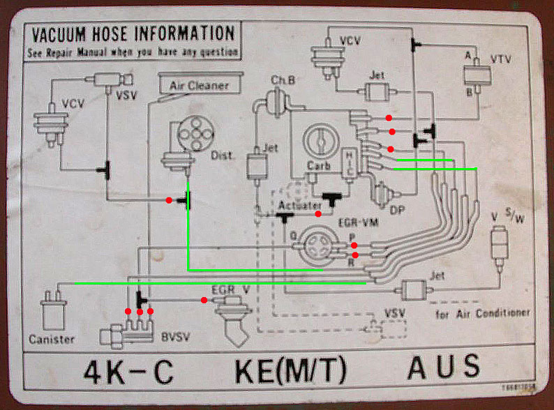

AI have a 1981 ke70 that has a ke55 carbie on it and i need to reinstall the original carbie, but i was wondering if anyone can supply me with detailed photos of where all the anti-pollution pipes attach to the original carbie. As many photos as possible would be great.

Thanks for the diagram, are the green lines the only ones you need open? Where they join the carb is the lowest green line the lowest pipe on the carb as there is also thick gasket? with a pipe sticking out under the main carb body.
Thanks Rob
The pipe sticking out with the thick gasket is for the PCV. this needs to be hooked up to the PCV on the engine (head).
You're right, I kept the green lines and blocked the rest.
Unfortunately that was a few years back and I soon moved to twin SUs, so I can't remember which line went where on the stock carb!
