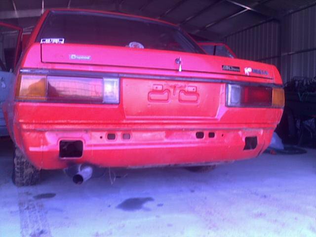

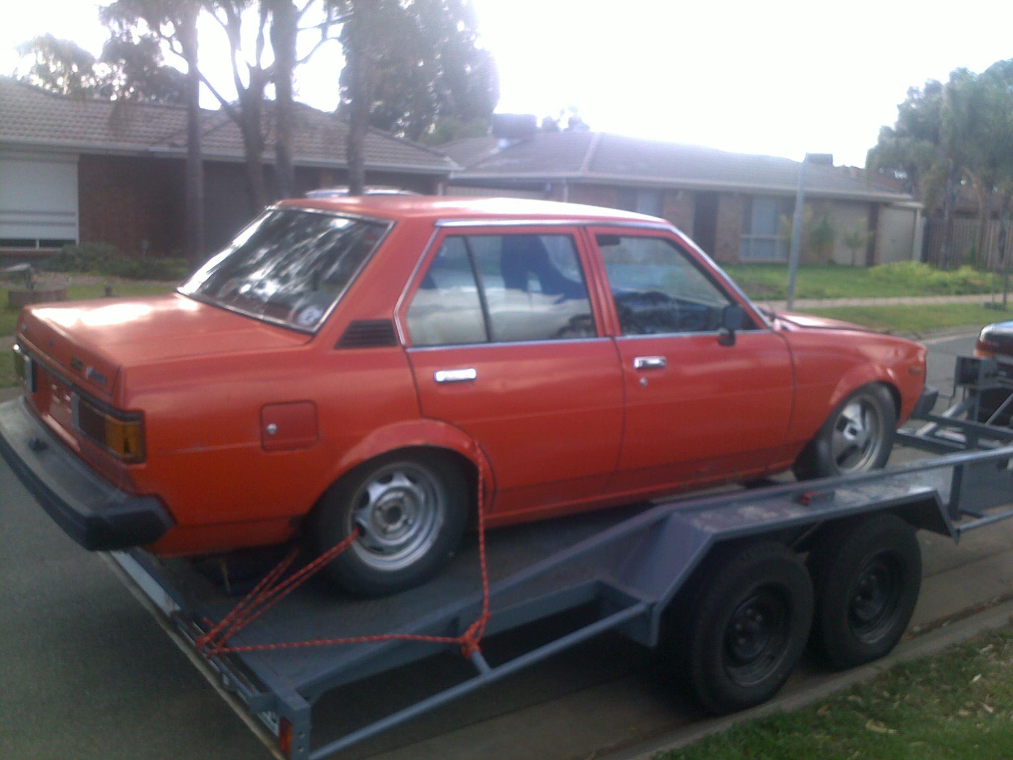

well i sold my ke30 during the week and went and bought this
the plan is to have a go at drifting and in my opinion this is a great car to learn in as the body isnt the best and it can't be regoed so it doesnt matter if i dent it :laff:
the best part about it is it's already set up for sliding with the suspention consisting of ae86 front struts, new shocks and vl springs, ae86 vented disks and calipers with braided lines and corona control arms. whilst the rear end has new boge turbo rear shocks and falcon springs making the car stiff as f**k
the drive train is pretty much done with the exeption of a cracked piston ring which is as simple as a rebuild to fix
sporting a pretty much 4k with the exeption of a acl head shim to drop compression and soften the punch of the sc14 blower that pumps 16psi of air and fuel into the combustion chambers, fuel is fed into the blower via the 45mm sidedraught webber
the power get's to the wheeks via the k50 5 speed (which currently has stock clutch until i can afford a new 1 after the engine rebuild)
then into the locked ke70 diff
interior atm is all stock besides the fixed back sparco race seat and 4 point harness but i plan on stripping it all out this weekend coming and only leaving the drivers seat and dash in it
plans for it are of course rebuilding the engine and putting a decent size cam in and getting a set of extractors for it, stripping the interior and getting a decent set of dished rims
anyway thats enough for now heres some pic's
thankyou for looking

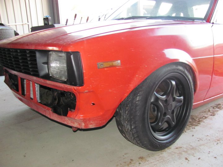

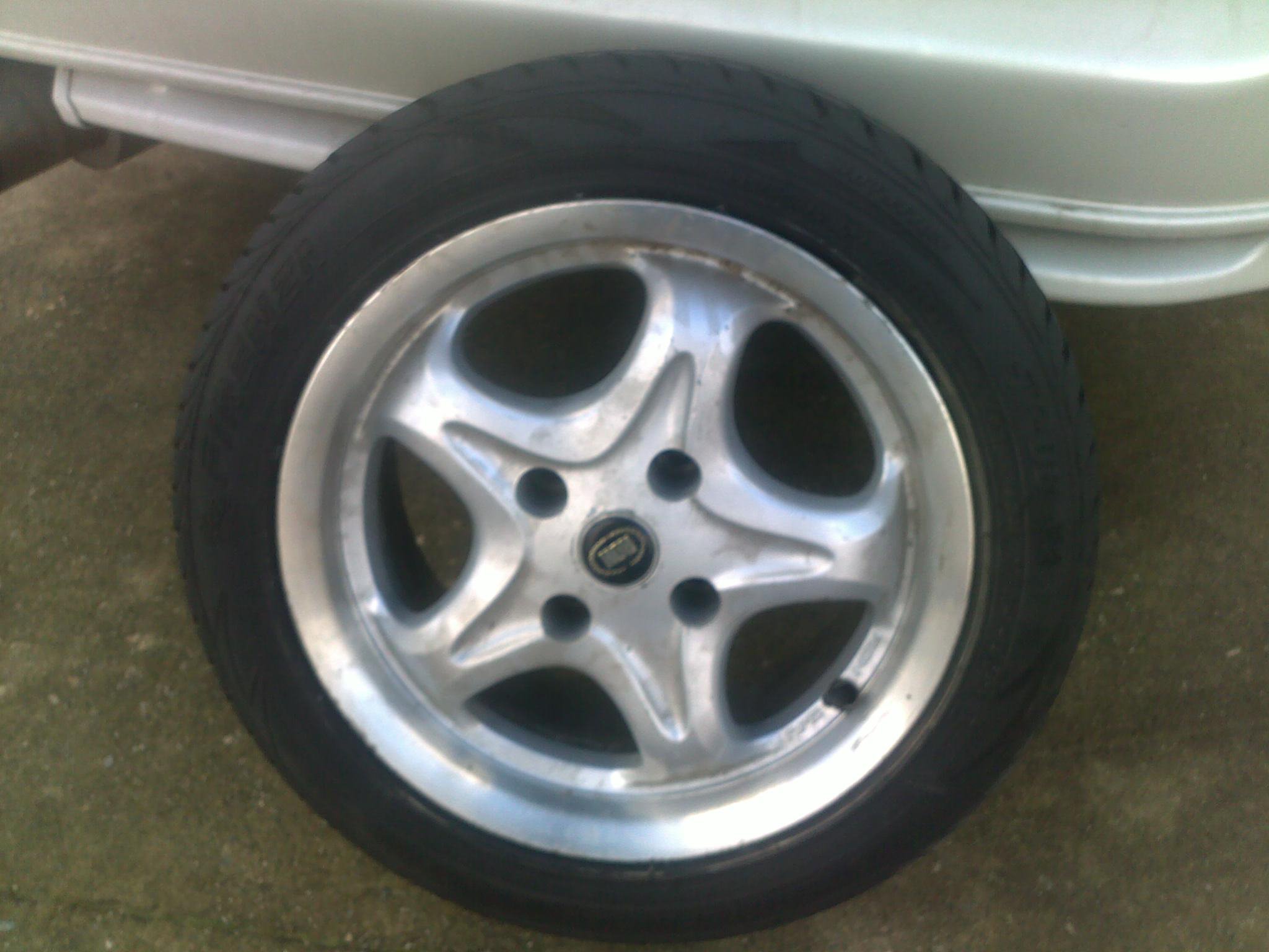

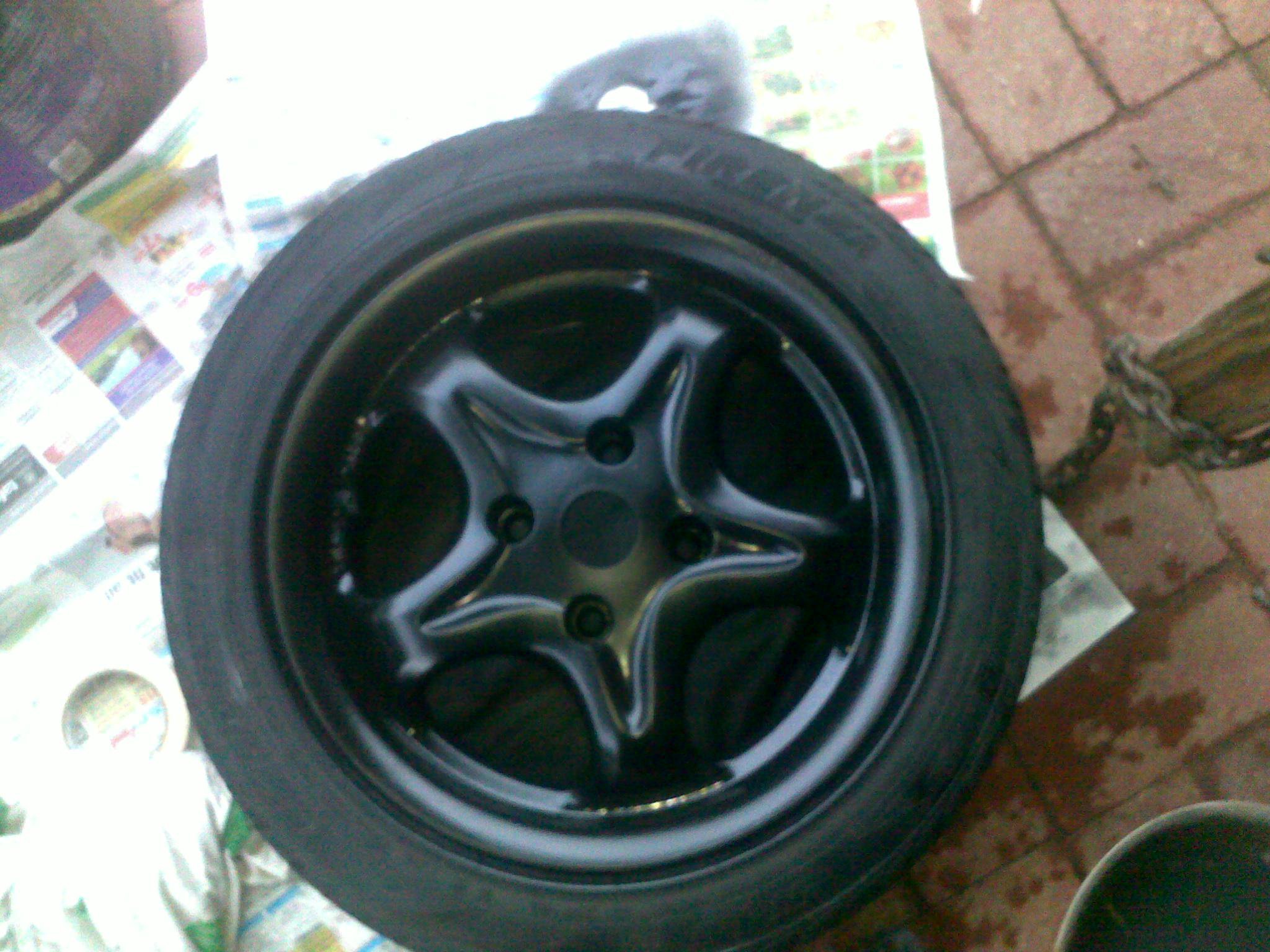

bit of a update... i picked up 2 15x7 roh rims not really drift but better than the celica rims and i got them cheap
didnt like silver so i painted them black

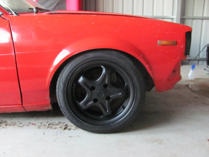

they look ok on the car and will do for now
also i took the bumpers off and painted the grill headlight surrounds and parker lense's black

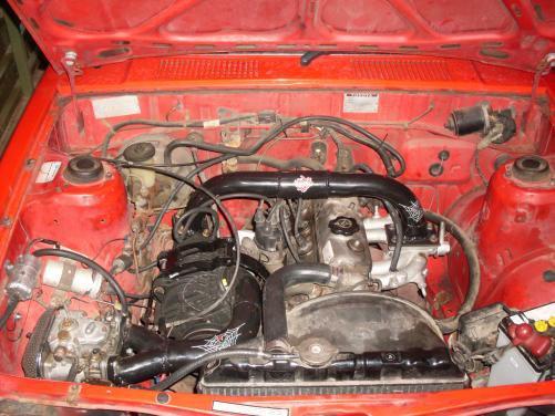

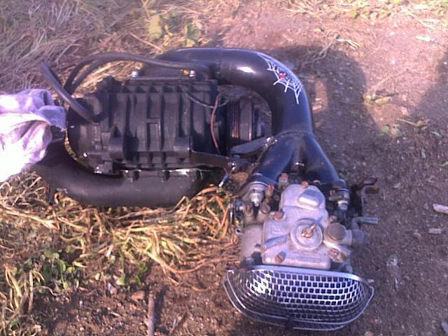

also heres a pic of the blower

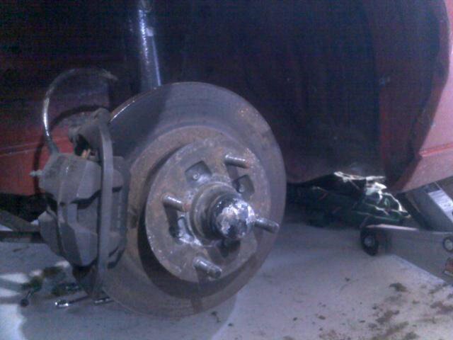

and ae86 struts and brakes
brakes should look alright with a little paint :wink:

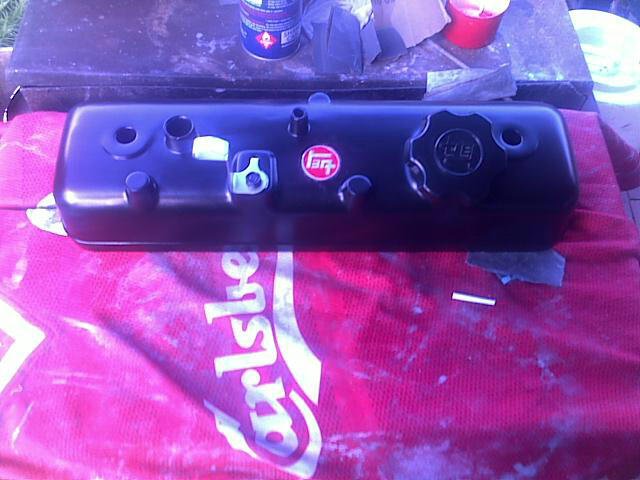

got bored and painted my rocker cover
Hey mate, loving the blown K engine. Any chance of getting some pics of the setup, particularly around the engine mount, the lower mount and timing cover.
i would but its pulled appart atm coz i need to rebuild the motor the top mount is a modified a/c bracket and the lower mount is made from scratch.... once i get it back together ill post some pics for u
No problems, any chance a shot of that top mount? I have a lower mount for my SC12, just need to work out a top mount.

yeah ill get a pic when i go out to where the car is as itsat my bro's 40 mins away from my house
