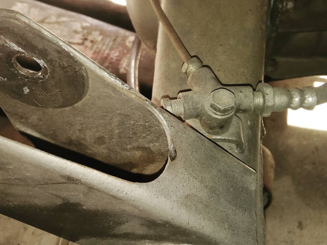

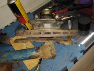

As a matter of interest in pedal feel adjustment, I went through some parts boxes to see what I had lying around to play with to adjust brake feel.  I found I had the JDM disk style and ADM Drum style brake valves and splitters, so I stripped and cleaned them up.  Inside I found the spring area was very much a holding cell for any muck thats travelling through the lines.  Both devices, the disk and drum valves were full of contaminated crud when I opened them up, so I cleaned them both up and bagged all the bits for storage in case I use a disk rear end some day.  I also had a spare ae86 brake booster of unknown condition connected to those bits, so I stripped the Master and lines off it, and I wire brushed all the corrosion and scale off of it, masked it, etch primed with this intensely great PPG Protec Etch pro product, and then painted it satin black with my touch up gun.  Result looked so good I really hoped it was working, so I looked up all kinds of test procedures, and it passed them all.  A bit surprising since it looked like it came from a halfcut that sat on Fukishima Docks for 2 years.  That's now been wrapped up in a soft old shirt, bagged and put away for a rainy day, or if I ever buy a ke70 again.  After all that the pedal felt completely decent after the rear brakes were adjusted, so I didn't fit any of it, but at least I know what I have now, and its stored properly, and ready if needed.

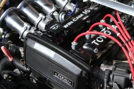

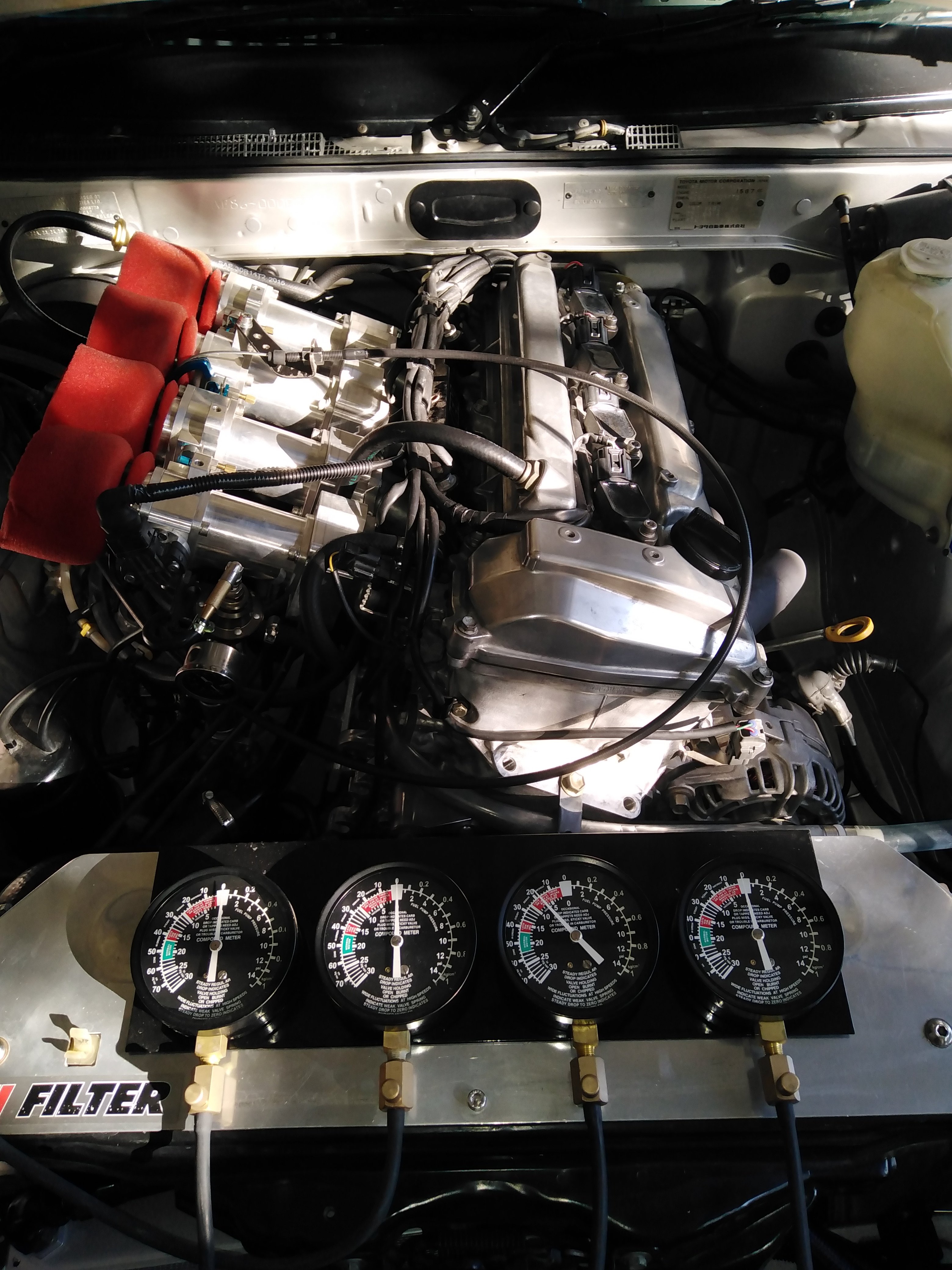

Engine wise, I'm very happy with it.  It really appreciated the new plugs and some road tuning after, the ones that came out had some pitting on the centre electrodes, they were Denso, so likely the original spark plug for the engine.  When removed they were not fouled, they were that nice even olivine grey colour you get when god loves gasoline.  Their condition was even too, with all cylinders fairing fairly equally.

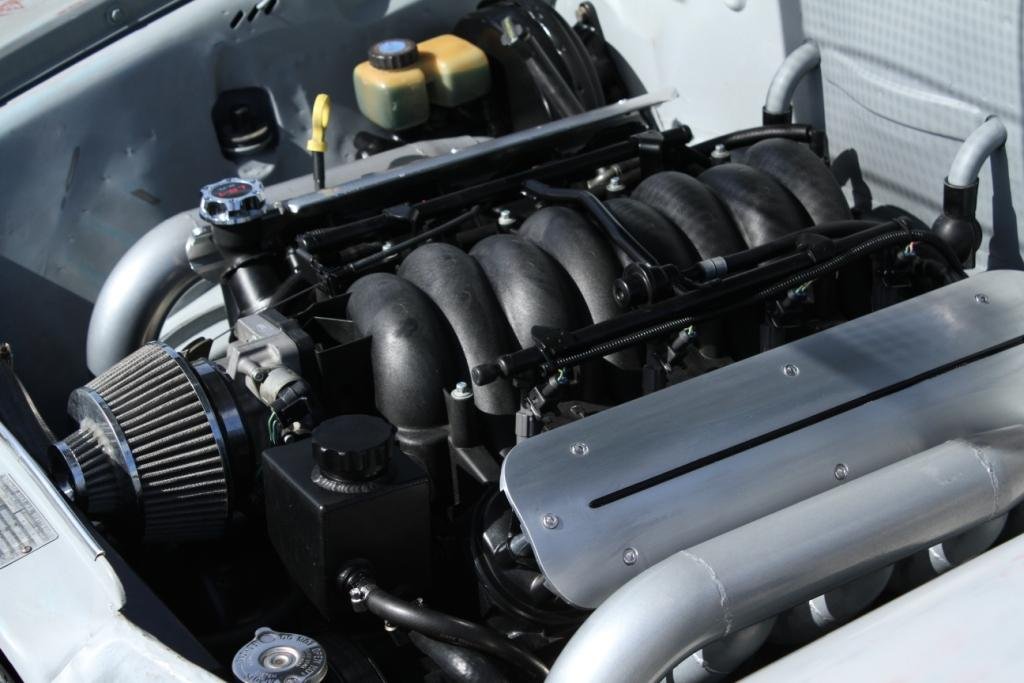

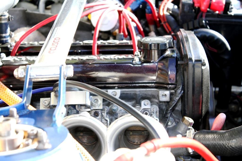

I made a global fuel correction between the 2 phases of the engine as the ports 1 and 4 have the slightest bend in them, and the ports to 2 and 3 are straighter right through, so I added 1 percent fuel to cylinders 2 and 3 as a test and found idle afrs to be more notably more stable.  I dont know if its just anecdotal, but it seems to work and feel correct, its only 1 percent.  I had tried as high as 3 percent but found it made a couple extra pops when you went to overrun, but it sounds clean with the 1 point addition, and the torque is strong feeling along with it.

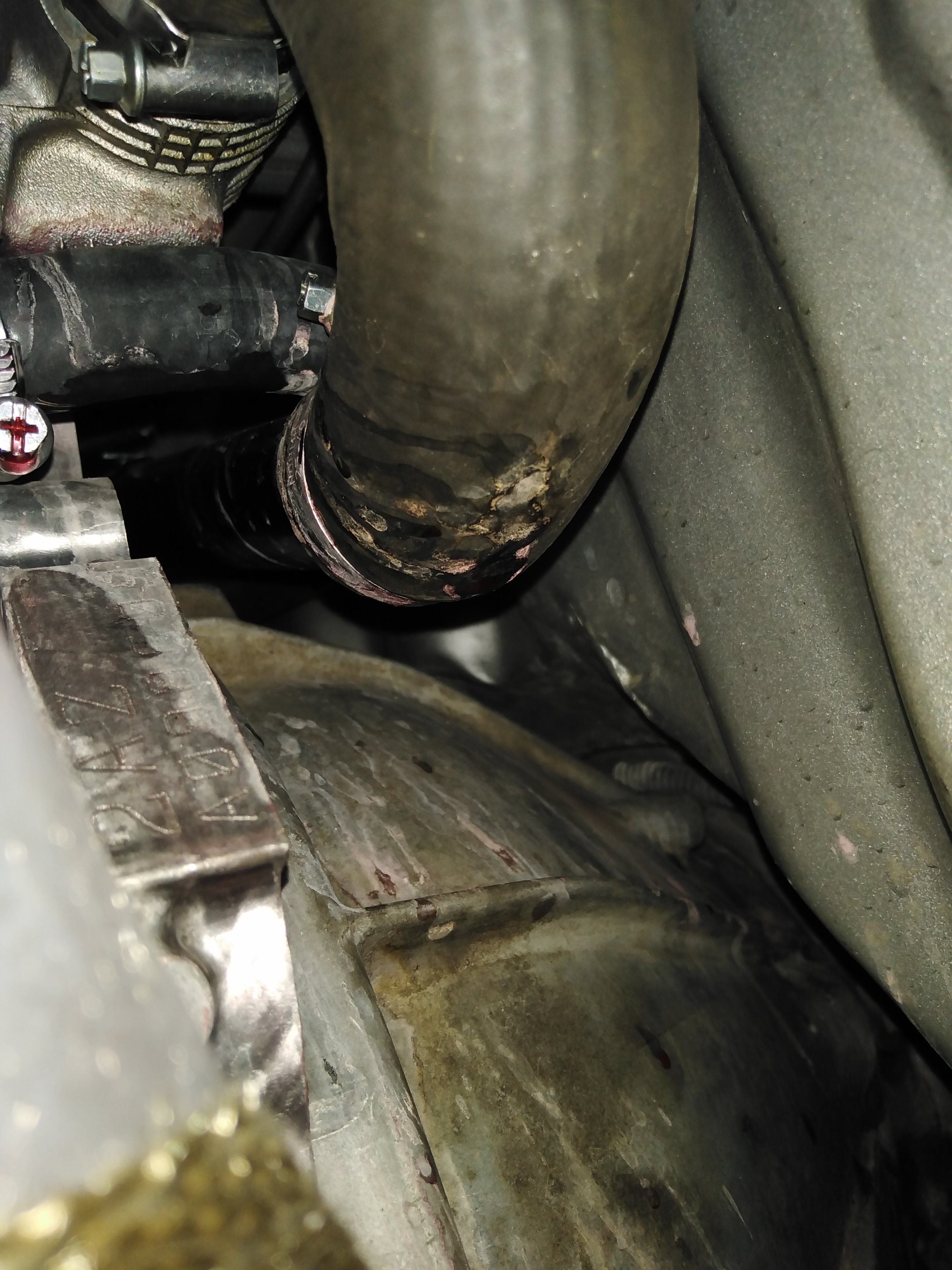

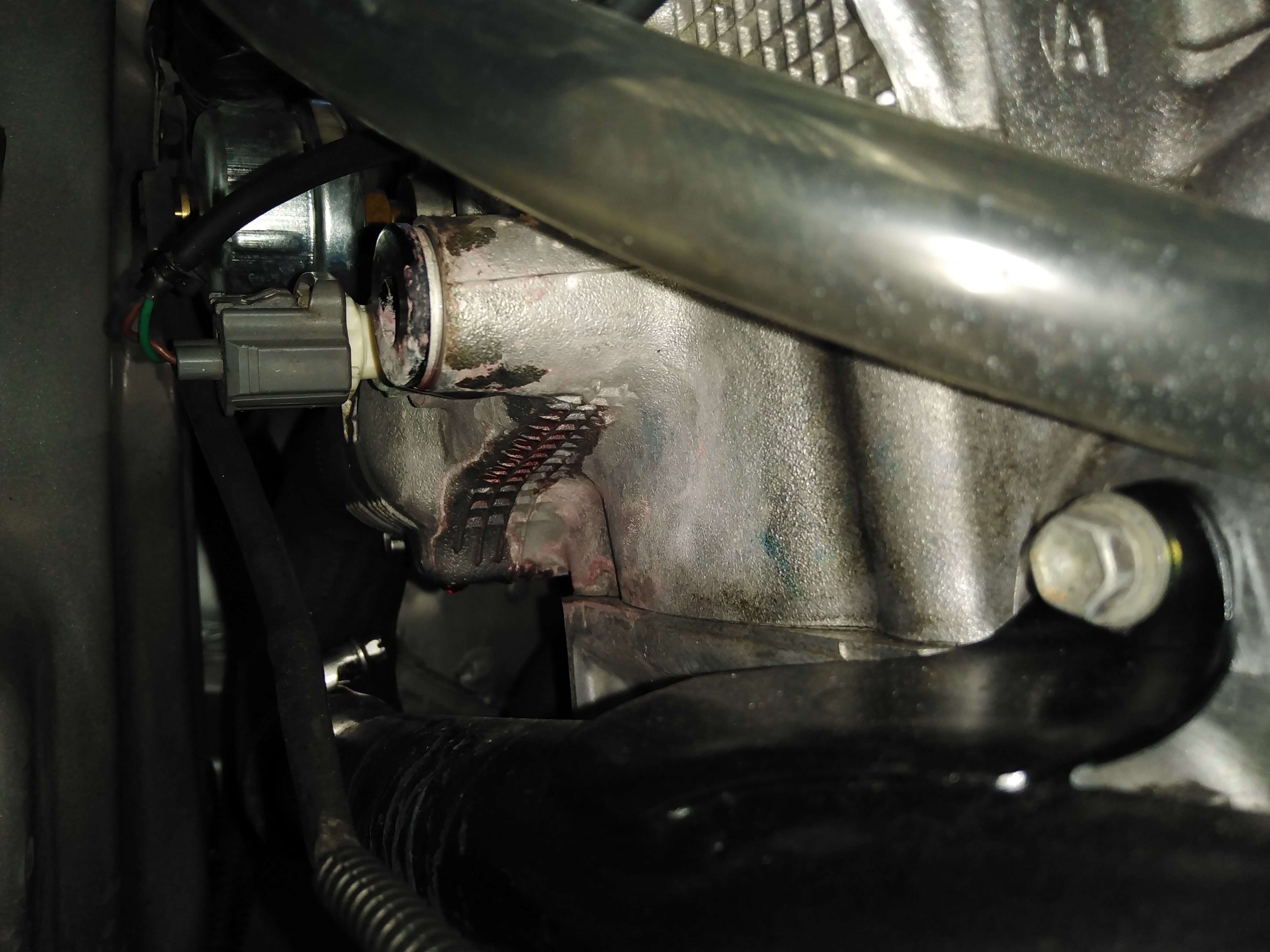

Here you can see the salts left behind by the coolant leak.

This was the real culprit, this thing wasnt tight where the heater pipe lived before removal for rwd.  You can clearly see the trail of the leak.

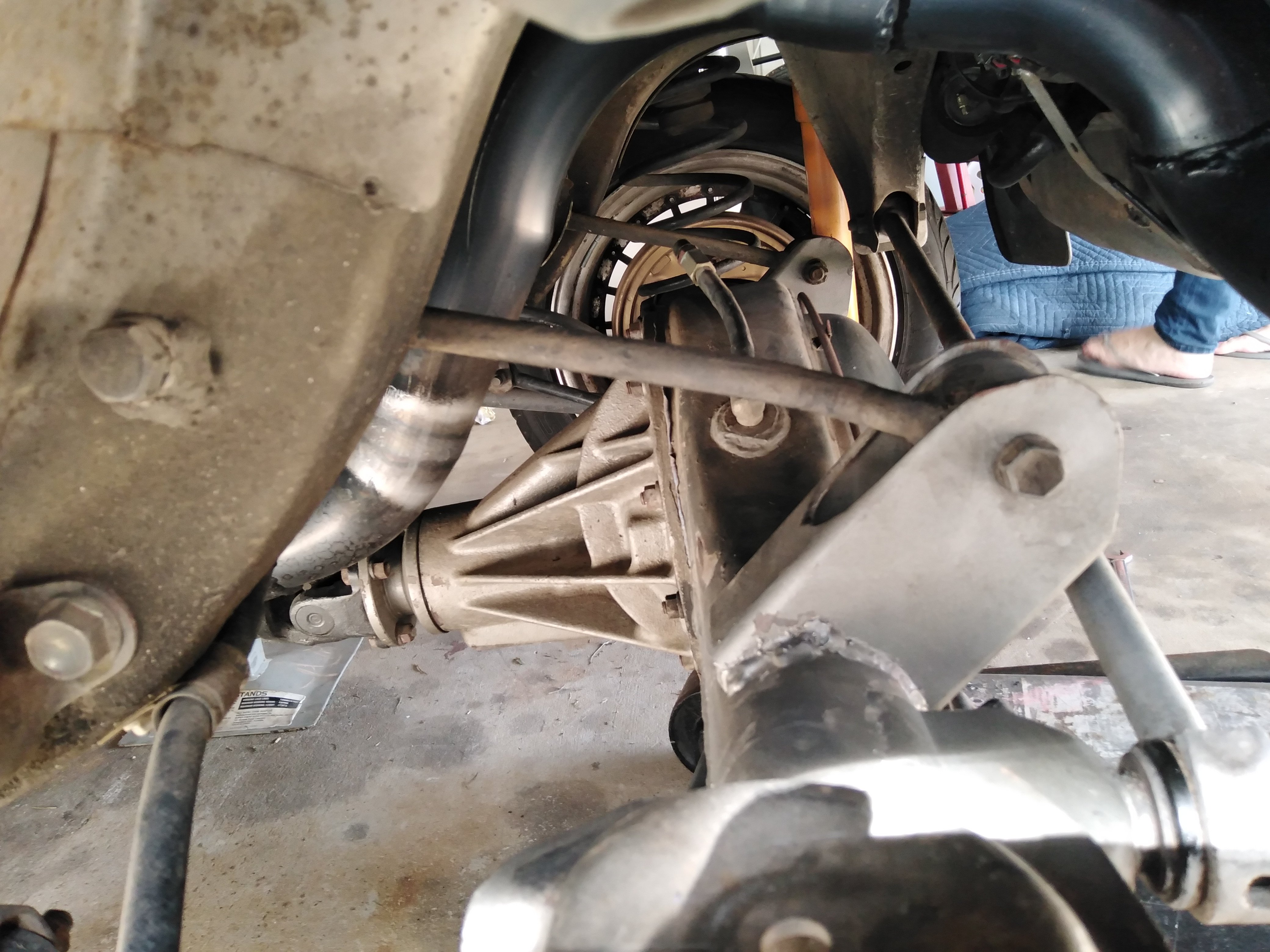

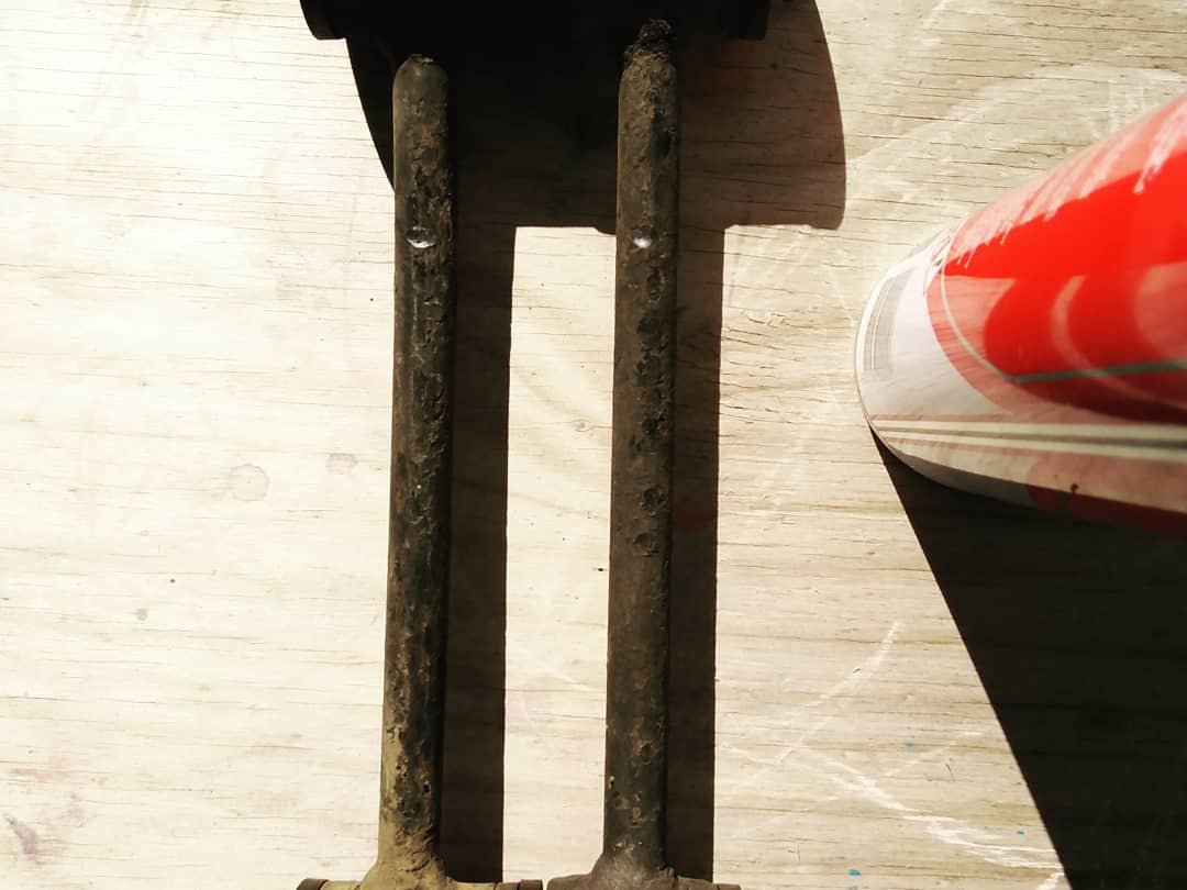

When I lowered the car, i did not realise the custom top mount brackets were in need of clearance, as they both hit the arms and kinked them.  I've since put straight arms in and clearanced them properly.
You can see the tell tale marks here on the brackets.
And the 2 bent arms in situ awaiting removal.

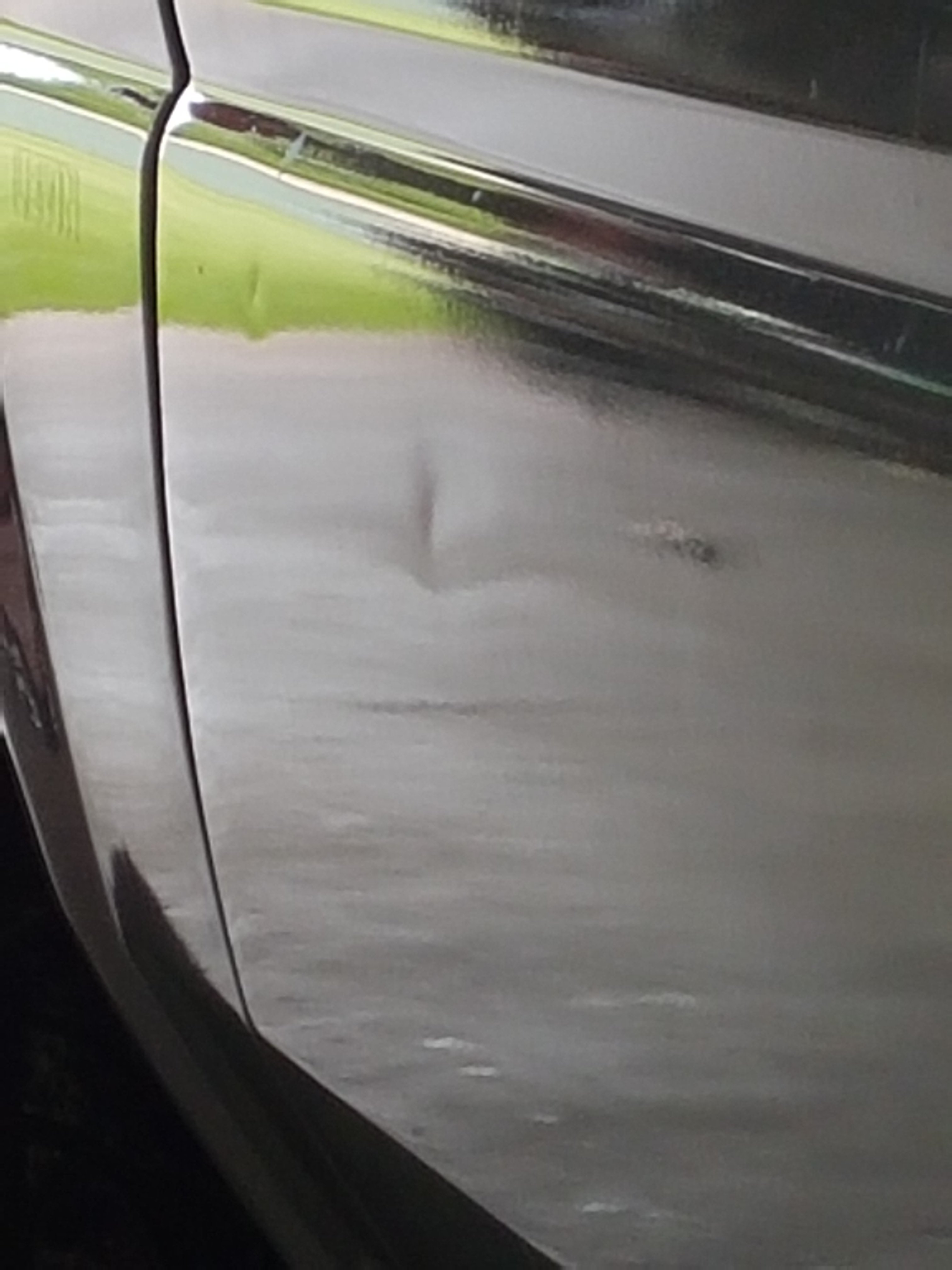

Dent from a Junkies Kneecap.

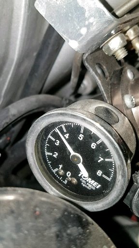

2azfe needs this much fuel pressure.

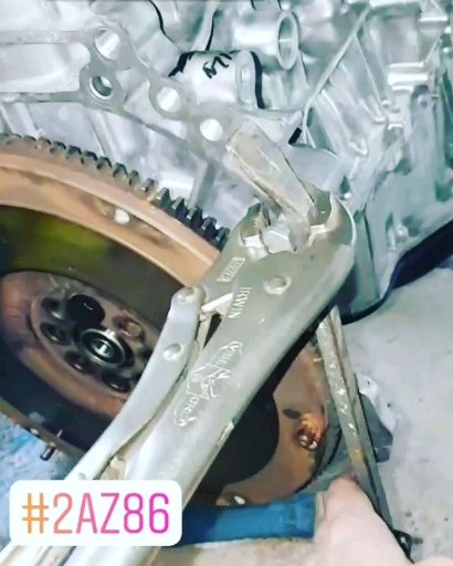

My little flywheel locking rig.

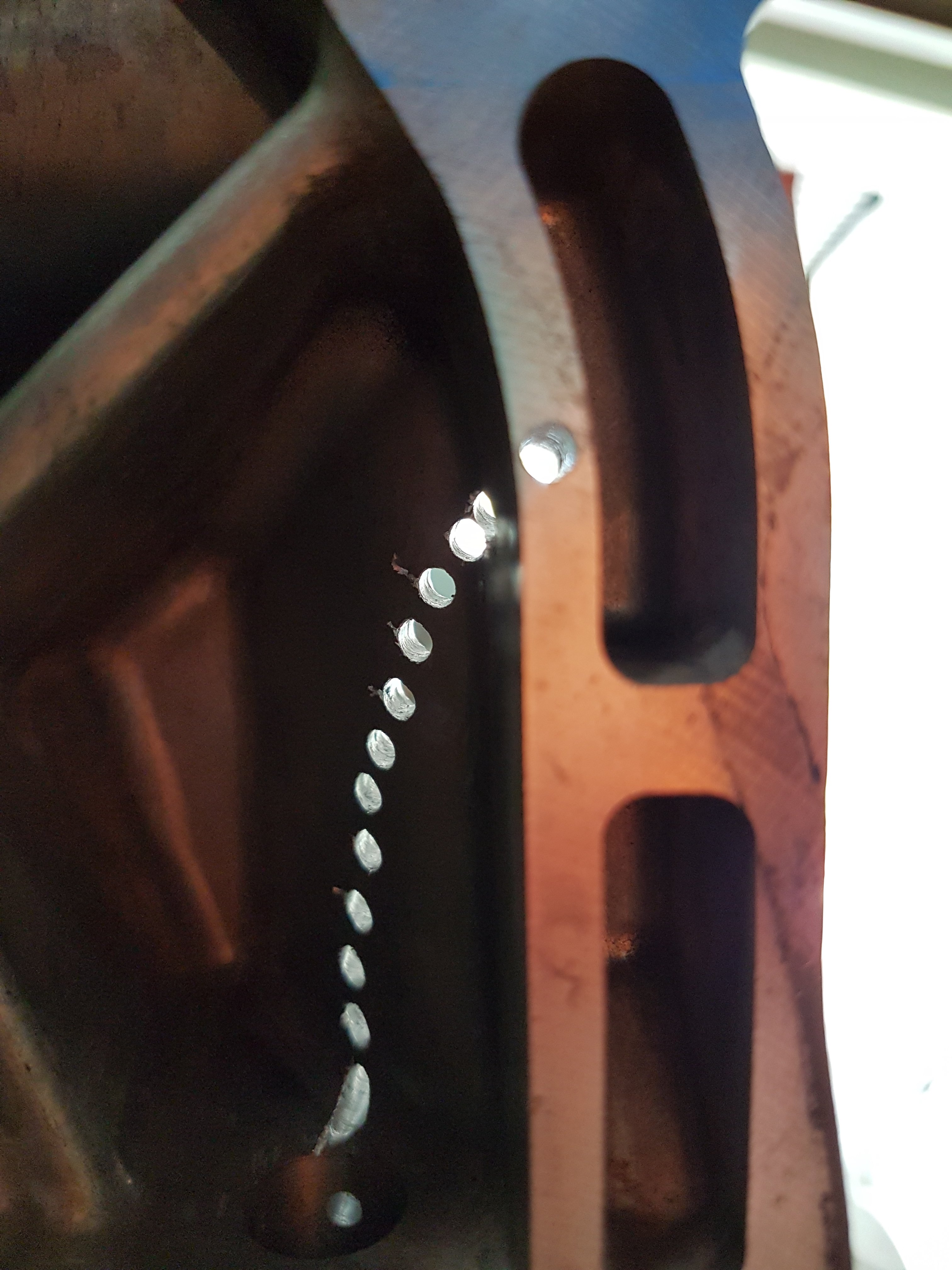

I was particularly proud of the one hole that pierced the alloy rib all the way through.

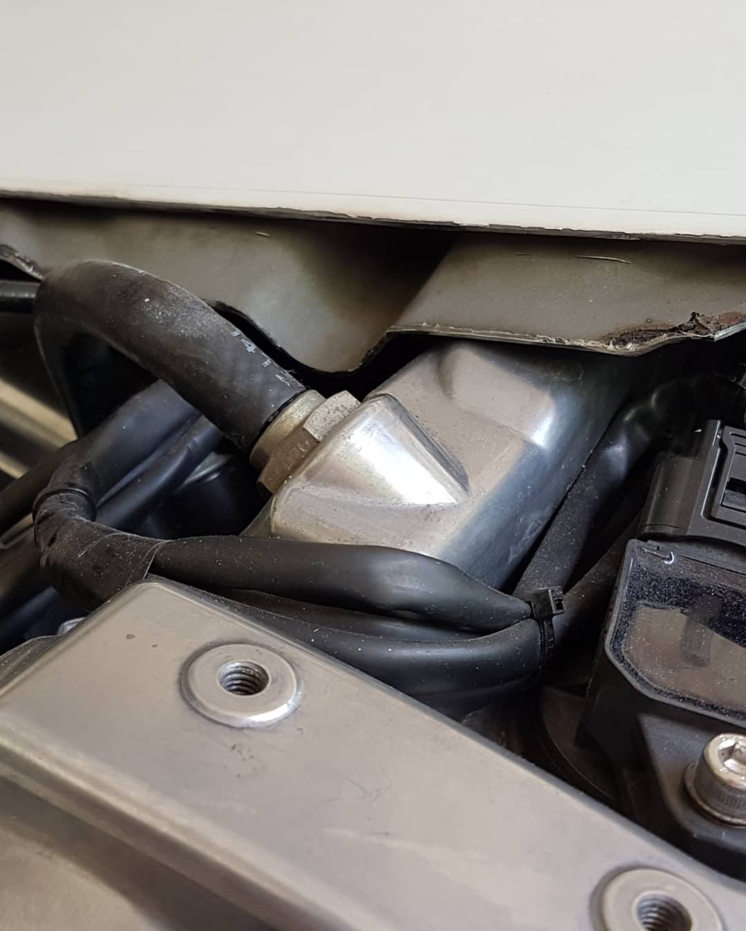

You could say bonnet clearance is not quite a thing.

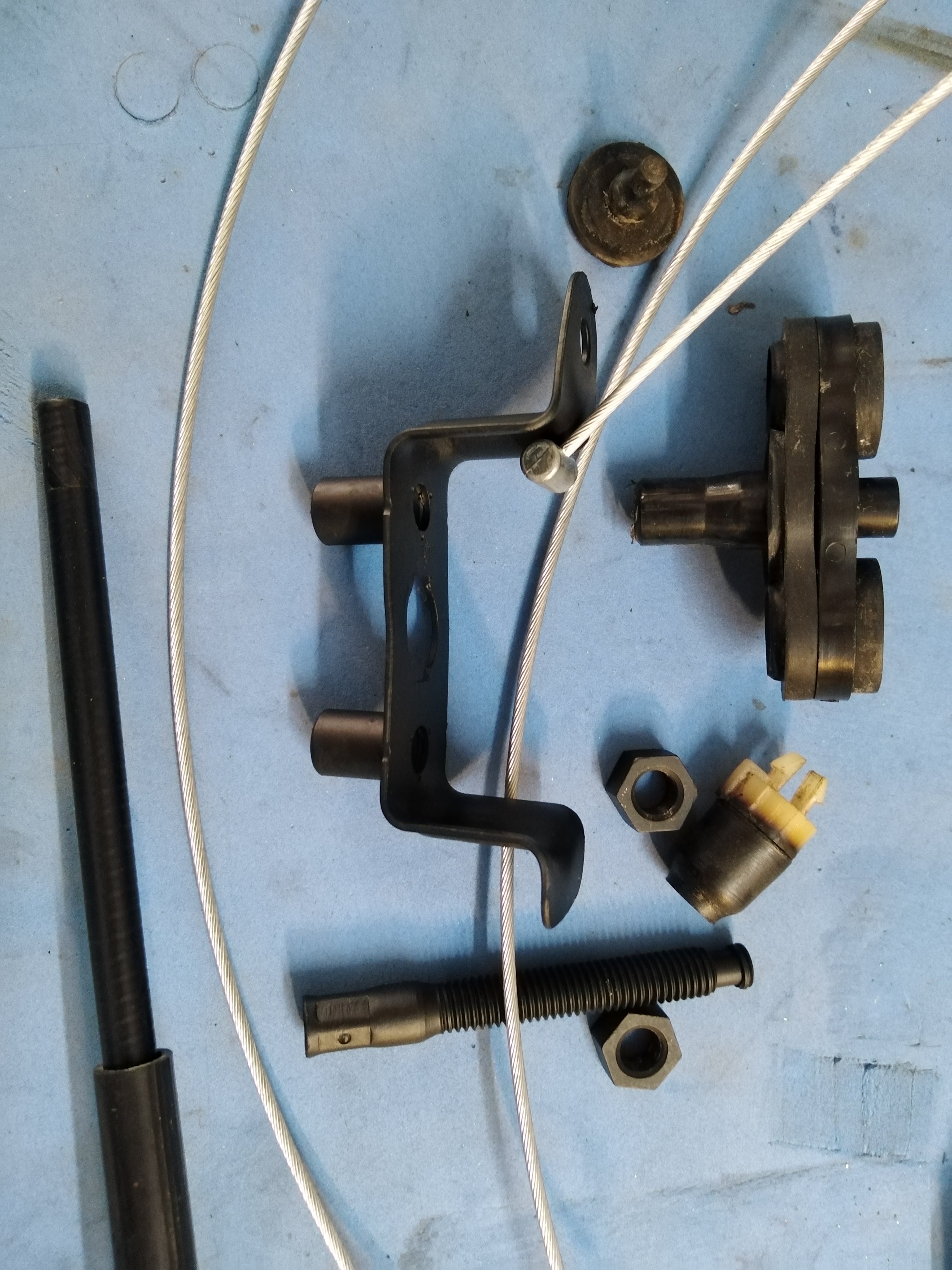

So the Venhill kit arrived, and I fabricated a new throttle cable.  I ripped an old one apart and wire brushed the threaded adjuster and nuts.  I used a Genuine one from an ma70 because it has Teflon inside the adjuster.  I etch primed the metal parts, scrubbed all the plastics clean and cut the firewall end off of the old ke70 cable.  I cut, pulled and drilled the ends out to suit the 7mm cable housing for the 2mm Venhill wire.  I then super glued the adjuster onto the cable housing, and posed it up to find the length of the housing.  Once established I ran the inner wire through about 400mm extra and then cut both with the angle grinder.  This gave me spare wire to sort to length.  Before cutting the ke70 cable up I measured from the pedal clips shoulder to the end of the cable, 147mm, that is the magic number of extra wire vs housing.  I marked this point and finished off the cable by ensuring all the correct bits went on in the correct order and orientation, then I soldered on the cable end for under the dash.  I did the birdcage technique to ensure a strong bond that cant pull off.  Very happy.  I also found a couple of adjustments to make to the itbs, which also helped the throttle return as crisp as possible.  Once I adjusted idle, all was good.

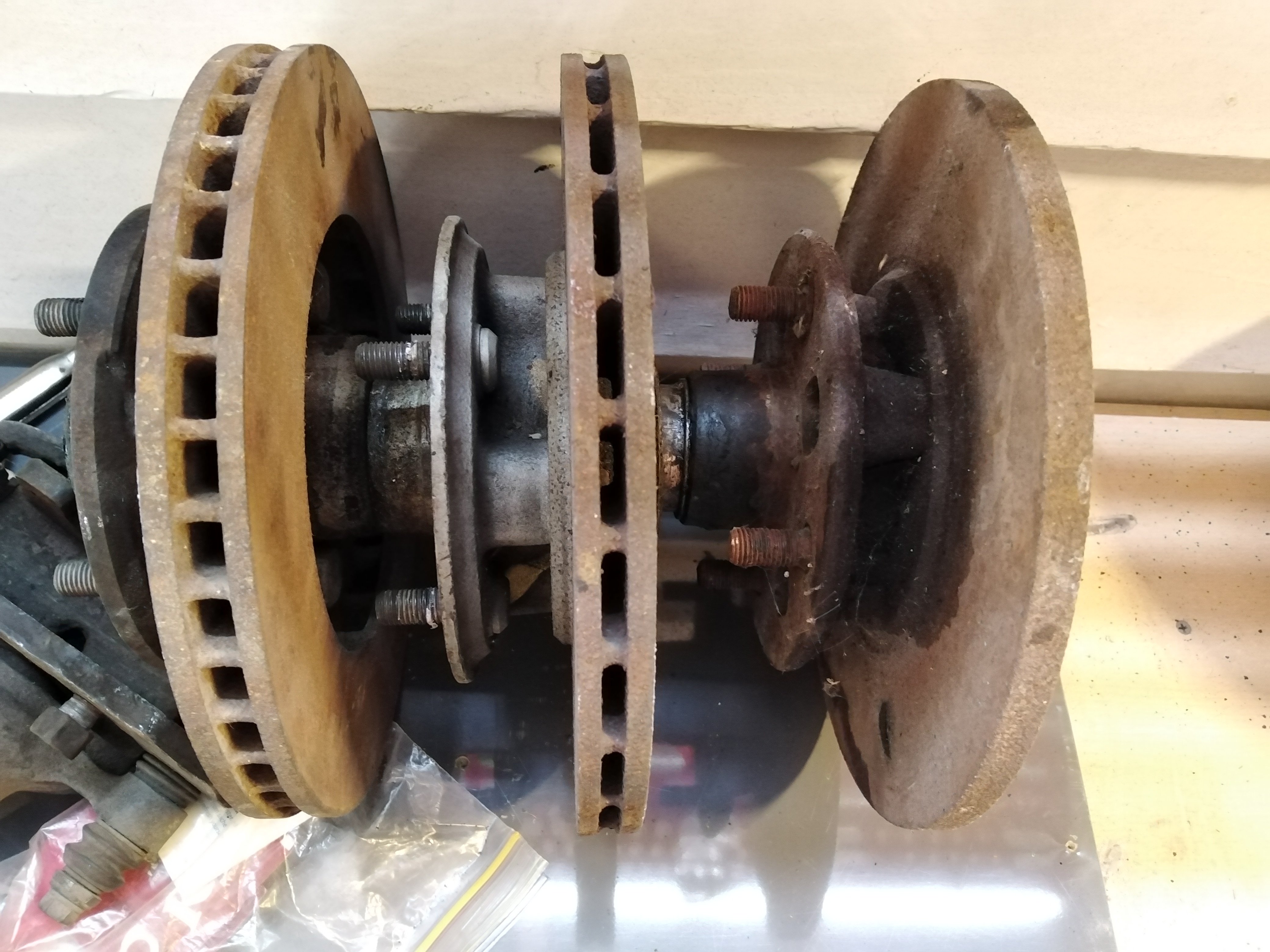

Been researching a brake upgrade.  I have these 25mm Liteace rotors that seem really well vented and only make the hub 600 grams heavier than the ra40 solid rotor.
I weighed ma61 hub with rotor 6.1kg, ra40 hub with rotor 6kg, and the YR39 hub with rotor 6.6kg.  They all give the same 37.5mm clearance from the wheel face to the friction face of the rotor.  This seems standard on the Toyota hub and rotor designs of this era to clear a single piston calliper.
As for the hubs:
They are all about a 95mm bearing set width, across the middle from inner seal to the face where the grease cap presses in.  This is guess what the bearings require to cover the stub axle.
The vented rotor types have more offset space from the strut, to allow for the thicker rotors.
YR39:
about 70mm from inner edge to wheel face.  About 21mm from wheel face to the rotor mounting face, leaving 49mm from inside edge to the rotor mounting face.  Rotor is 45mm thick and leaves 4mm approx from rotor face to inner edge.
MA61:
about 72mm from inner edge to wheel face.  About 32mm from wheel face to rotor mounting face, and that leaves 40mm from rotor face to inner edge.  Rotors are 26mm thick overall, so that leaves 14mm inside.
RA40:
about 60mm from inner to wheel face.  About 33mm from wheel face to rotor face, leaving 27mm from rotor face to inside edge.  Deduct the 16mm thick rotor assembly and you get 11mm from the back of the rotor to the inner edge.  The snout is obviously longer on this hub, as the wheel is set 60mm out, not 70 or 72mm.
Ill firm these up when I get some vernier callipers to measure with.  Mine broke.  At that time Ill make a spreadsheet that's useful.
One thing that's obvious, the ra40 hub gives less offset than others, and if I use the ma61 or YR39 hub, I end up with 20 or 24mm more front track respectively.  My front guards wont enjoy that, it might mean switching back to a stock length LCA from the XT130 LCA.
I guess if I was dead set on 4 piston callipers, Id be trying to use the YR39 rotor on the MA61 hub to maximise the distance from friction face to wheel face, which would be around 49mm with that combo, but it pushes the inner rotor edge just past flush with the inner hub edge, which means you need a more complex bracket that steps back.  This isn't a deal breaker, but I'm tempted to make a set-up that's so oemish its not funny, with cost, and ease of service and parts collection being the priority.  I noticed the zze122 has the same rotor dimensions, so I might try and investigate those callipers.  Being Corolla platform the master cylinder change wont be too much, and to make the drums work I might just need to go to the bigger wheel cylinder size.  Using a single piston later model calliper it should be cheap and easy to obtain and have easy parts availability.  I also wont need to do any real trickery with the bracket which keeps cost down and also means I can use the stock hub and rotor combo from the YR39.  Should be an easier thing to find for people, rather than a combo of multiple things.

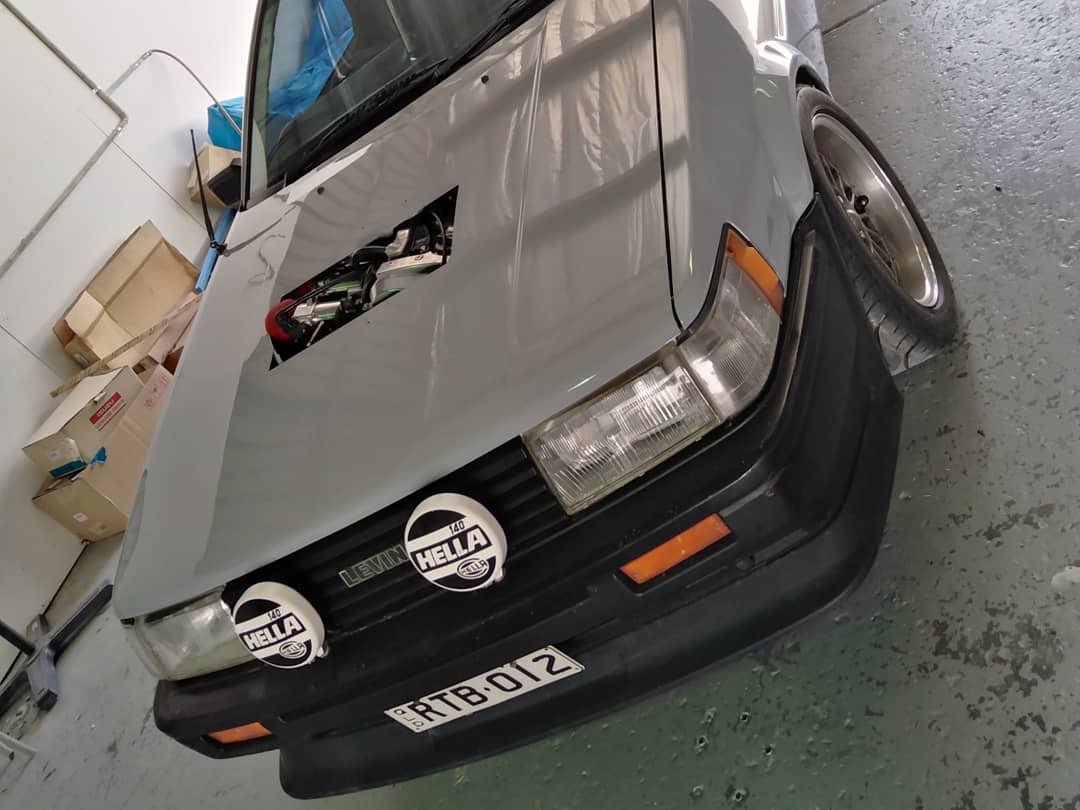

Pretty happy with it, didn't try to make this bonnet perfect, its a bit rough and it has a hole in it, so just asked them to beat it as straight as possible and paint it all one colour.  Door looks fine, and the window reg is like on a brand new car.
