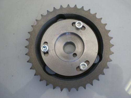

November 19, 201115 yr comment_566918 There is a mob in Norway that does EVERYTHING for K engines. Adjustable cam gears with a timing cover thats got a bolt on cover to get access to the gear adjustment. Edited November 19, 201115 yr by SLO-030 Report
November 20, 201115 yr comment_567046 Have an engineer drill three more holes, 3o'clock, 6o'clock, 9o'clock such that they give you 5deg, 10deg 15deg then one tooth difference. Datsun's had three holes to pick from and we used to drill the 4th. That Norwegian gear looks lovely! Report
