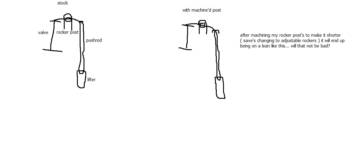

quick question.. by shaving my rocker post's it will end up making my gear sit on an angle like this.. will that not be bad?

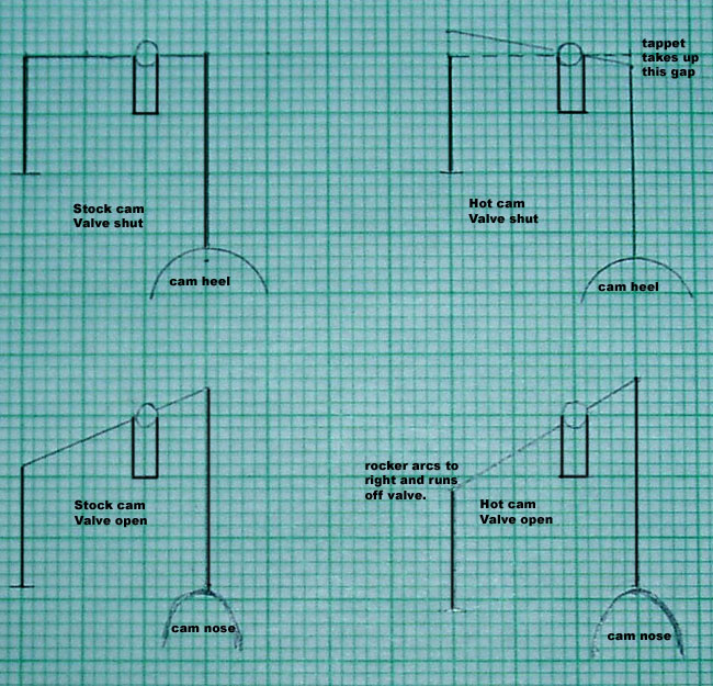

No, it will be the other way around. Say, stock is horizontal rockers, then a ground cam will make them lean down towards the cam side as you've cut the base circle away. So you trim the rocker posts and that lowers them to horizontal again. I'll draw it in a moment.
OK, lets look at this. A cam is ground for more lift by cutting away the heel, as they can't add to the nose as easily. The lift is the ratio from the centre to the heel versus the center to the nose, so by cutting the heel distance smaller you have increased the lift.
So as soon as you fit it you will have giant tappet gaps, for if the pushrod sits on the ground-away cam heel the rocker will face up in the air. So you reset the tappets to get the rocker horizontal, which has effectively given you a longer pushrod. In actual fact the ideal rocker sits aiming upwards slightly in stock trim, its not horizontal.
Now when it opens the valve, the cam nose sits in the same spot, but your longer pushrod means the rocker will move down through a greater arc and open the valve more. The worst thing is that it will wipe off the inner top edge of the valve and wear badly. The other thing is that if you consider arcs and tangents, the horizontal pushrod move slowly per degree to start with, then speeds up as it moves further per degree in the middle of its arc, then slows down again towards the end. This is easy on the valve. You lose that geometry by cutting the cam heel out.
One solution is to trim the rocker posts lower, the other is to cut a hot cam from a billet, not from a cam already made.
This really only applys to pretty hot cams, rather than road/sports grinds.

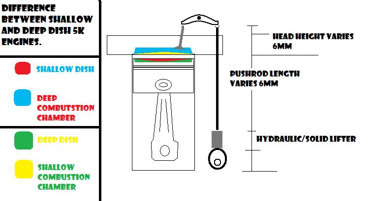

Shit if where drawing pictures. Here's one I made a while ago!
