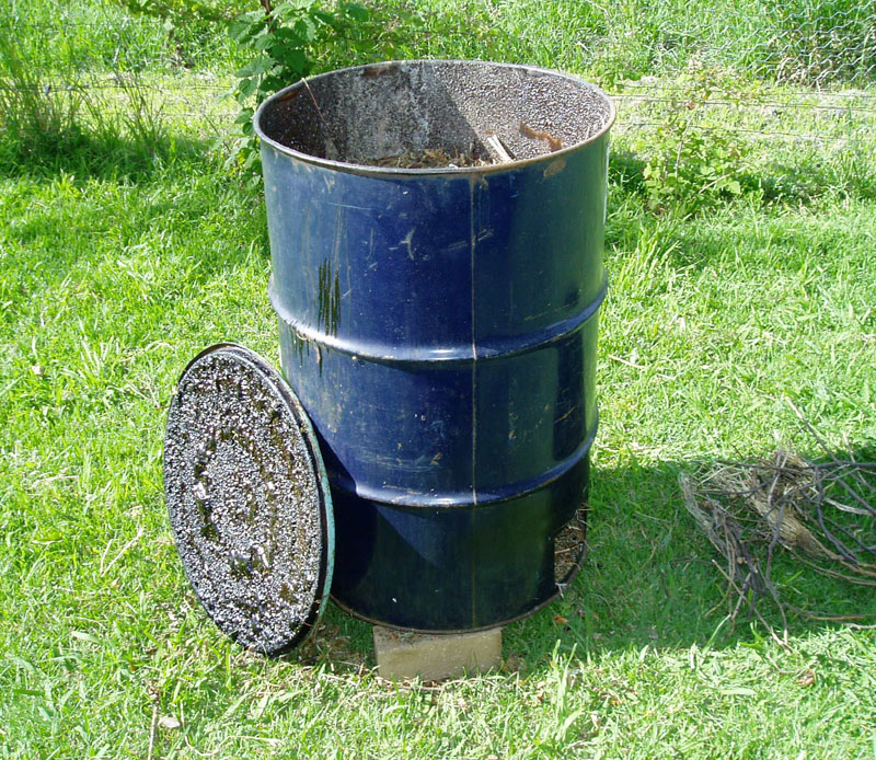

You get a $10 drum with a lid from the local apple juice factory & cut a hole in the bottom. Throw in 3 bricks and a coarse steel mesh cut to the circle. You get this- Its been used becasue I never took photgraphs to start with... :bash:

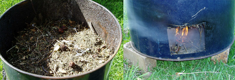

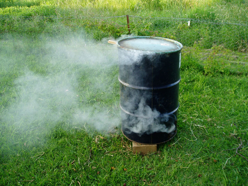

You pack all the shrubbery in the drum, stick the lid on and start a fire underneath. Note how full it is...
Edited by altezzaclub
Away it goes.... Then the neighbour but one comes over complaining about the very strong tarry stinking smoke! So you put it out. At 10pm he's back, because it didn't go right out, even though you hosed the shit out of it... so you go out & tip the drum out on the grass & hose it again!

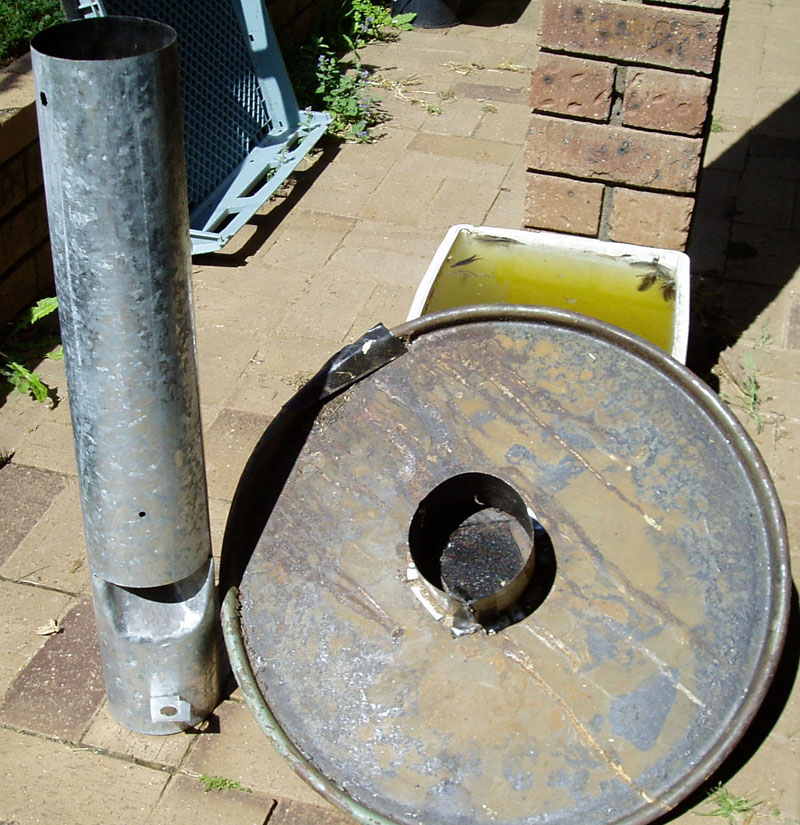

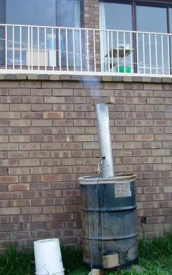

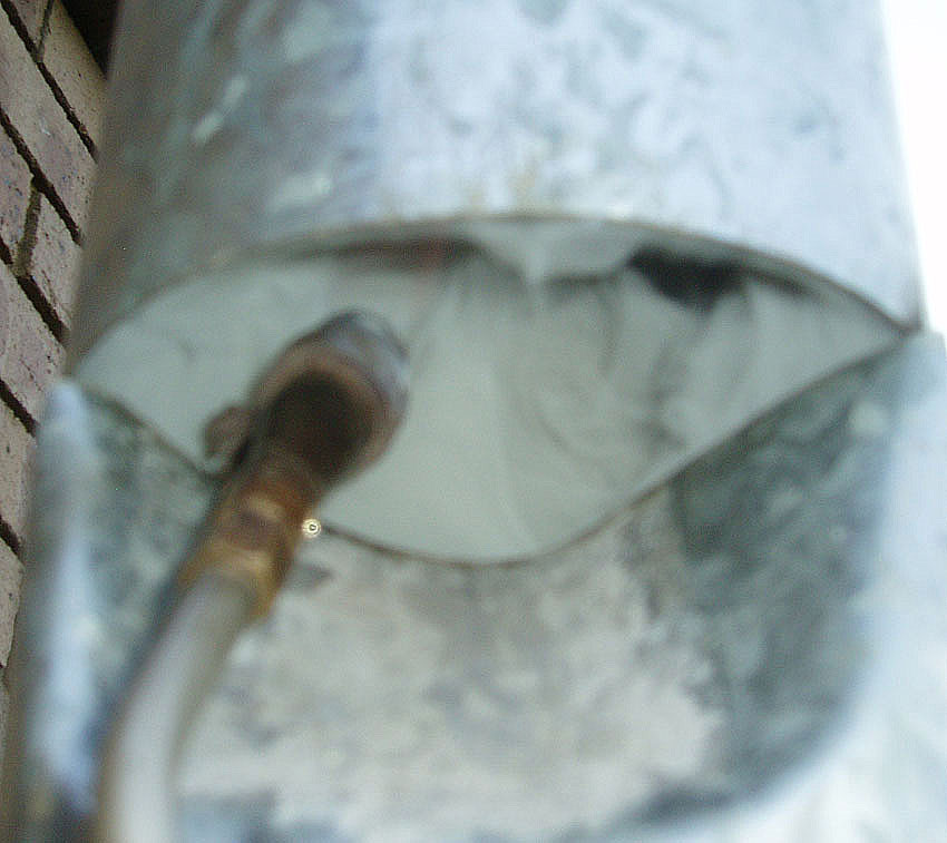

Counting that as a fail, you pay $20 for a crappy piece of tin tube and flare the base. You cut a hole in the drum lid and fit a fine "anti-flashback" mesh to it, then rivet on the chimney base, subtly modified so you can slide the rest of the chimney on and off. A hole drilled in it takes a length of Corolla brake pipe that is cross-drilled and hooked up to a rubber hose on a gas line.

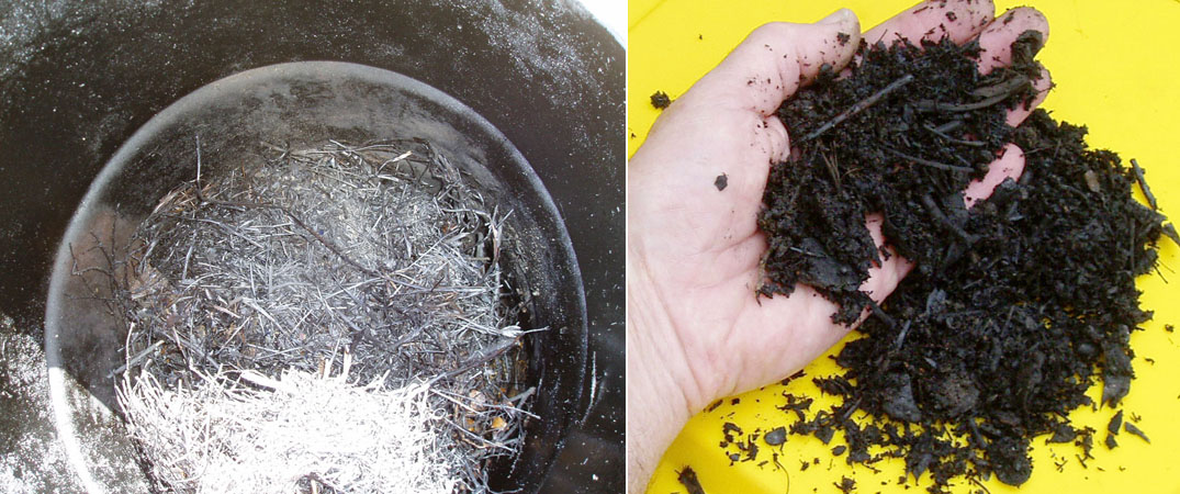

When that particular neighbour is away you do another run, a good thing as the draught of air blows the flame out all the time... However, this time you get charcoal, fine soft grassy charcoal and gritty little twigs. Note how full the drum is.... remember how full it is to start?

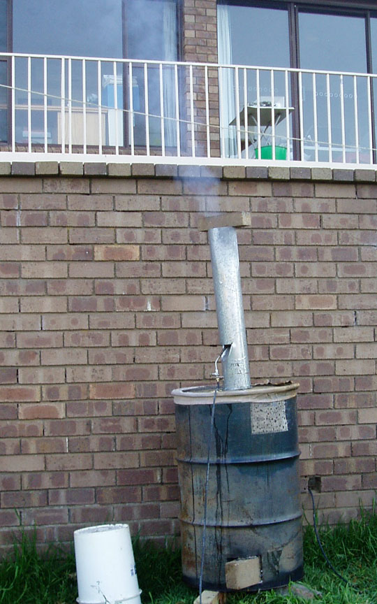

Ok, the brake line is too pissy, so you swipe an old gas soldering iron off a mate and hook that up. Unfortunately the daught still blows it out, and there is a problem of the flame not setting fire to the amazing amount of smoke you find in the chimney.
However, by carefully throttling the air entry (one brick in hte hole) and the gas velocity in the chimney (another brick for the top) you can get the smoke down to a civilised level!

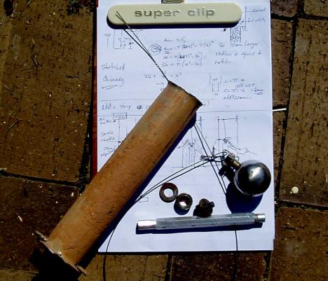

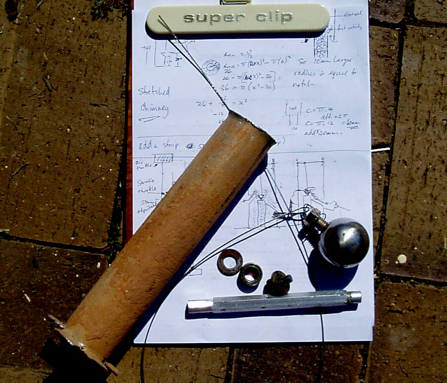

However it is still unstable... so onto today's project.... A smoke throttle!
I was looking for a 50mm diameter cone to drop over a bit of exhaust pipe, but could only fnd this steel ball. That will get suspended on the bike brake cable wire which is drilled through the alloy bar, so I can wind it up and down 50mm. The smoke will come up the exhaust pipe and the ball will let it out to mix with the air going in the chimney cut. The cross-drilled brake line is going back in through the side of the chimney AND the soldering iron, so I hope they keep each other burning.
I was planning on cutting the chimney off again above the vent, then splitting it wide down its length and adding a 40mm strip of steel to make its diameter bigger. Then re-fitting it so I had a draught going in all around the edge, but all that seemed like too much work! It also worried me that the velocity in the larger chimney might be too slow to mix well... Any combustion engineers on here?

Yes, its an addition to the compost.. If I burn the woody stuff I get the minerals only as ash, the carbon and the volatiles go out as CO2. If I compost it the woody bits stay whole and very slowly (over years) rot down and give off the CO2. So this way I lose the volatile organics but keep the carbon.
