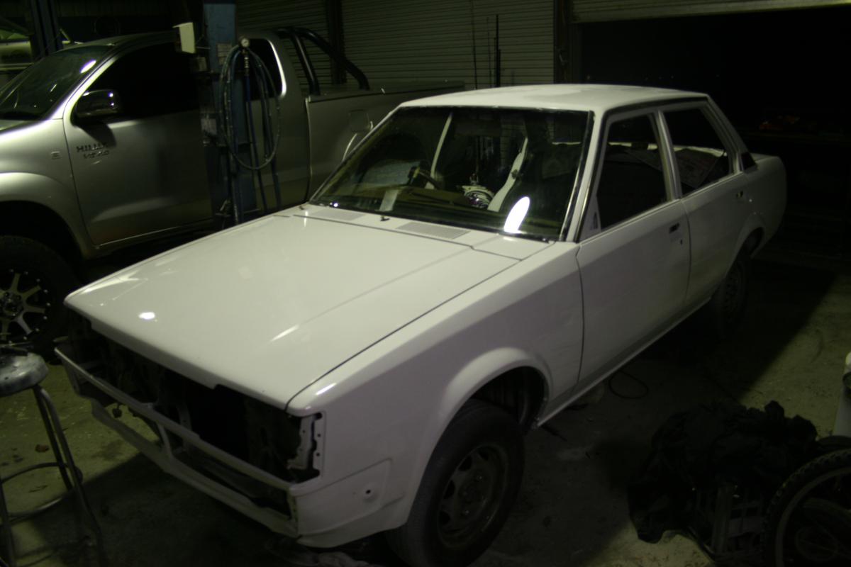

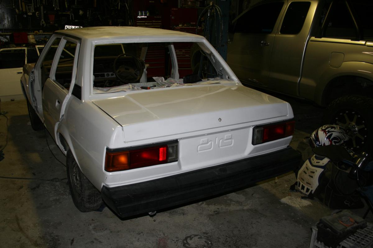

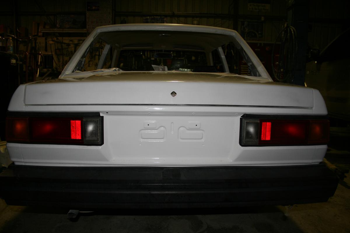

ke70 is now has a fresh coat of gloss white, just in the process of cutting back and getting the car back together.
will be half cut shopping after my exams finish next week. Also ordered some black molded carpet and a boot rubber which should arrive this week.

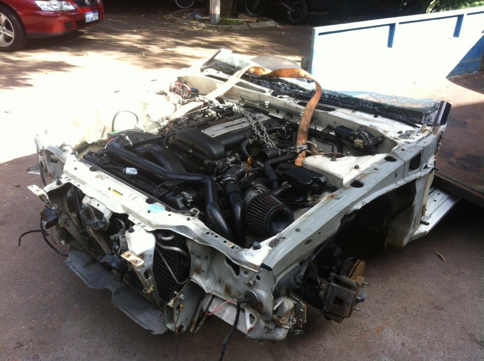

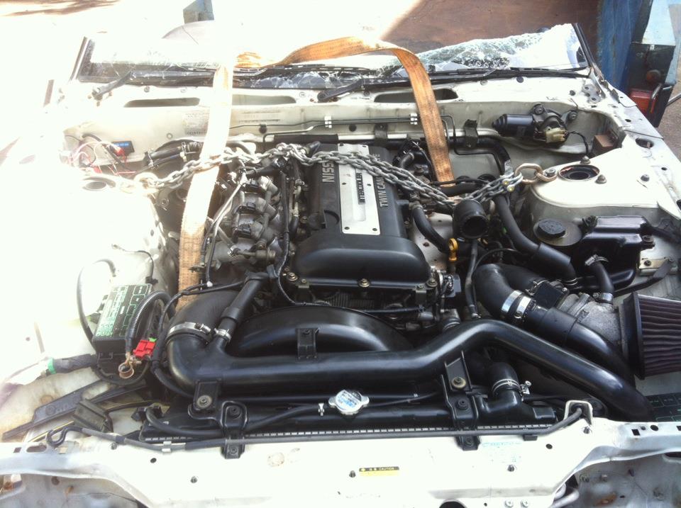

how much did you end up getting the half cut for ? and where from ? i m looking at doing the same conversion but I'm going to use the s13 front end aswell and make it work..
cheers mate
picked up the cut for 3k. from jpc
with the s13 front everything seems to fit perfect. ive elongated the back bolts and bolted up the crossmember but I'm still going to move the engine a further 35mm forward as there is plenty of room in front and it will give more firewall/clutch master clearance and a better gear shifter position. the only problem is the mounts for the control arms sit about 30-40mm to far forward which is the reason for the castor issues. the plan at the moment is to shorten the originals and reshape them to sit in the original corolla position, but ill speak to an enigneer before going ahead. the only other issue I'm having with the s13 front is the springs don't fit as they are too big, easy fixed with coilovers
