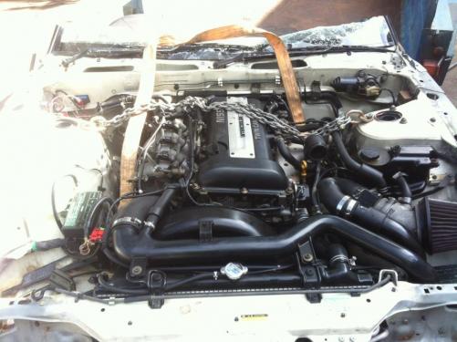

  • Today i decided to do a bit in the engine bay. Got rid of the maf and replaced it with a pod filter adapter, 3-2.5 inch silicon reducer and a piece of straight 2.5inch pipe. Also got rid of all the eg

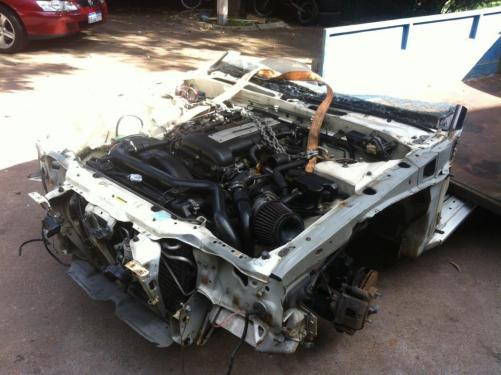

more engine photos for no real reason

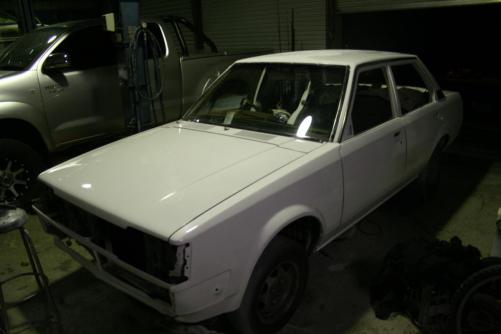

got some stuff done on the rolla today
got some 15s off a friend to see how they would fit, will be using smaller tyres on the final product, but it gives me an idea of how things would fit
