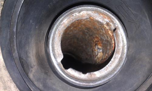

So FINALLY got the tie rod off the rack end, geez what a mission! :)
Got it off with visegrips on the rack end and pipe wrench on the tie rod. Wrench scratched up the tie rod tube pretty bad. Might replace it just cause it is out. Attached a pic below for peoples reference.
Thanks for the tips everyone, much appreciated.
