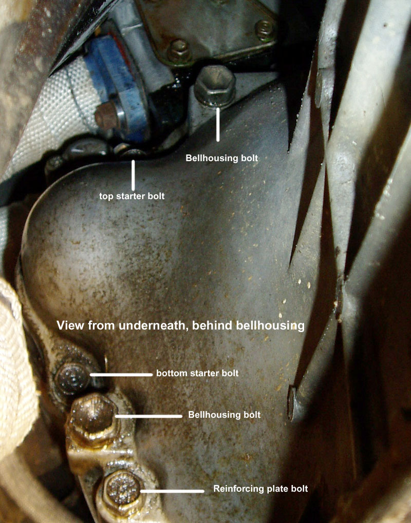

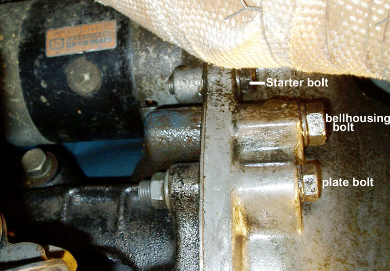

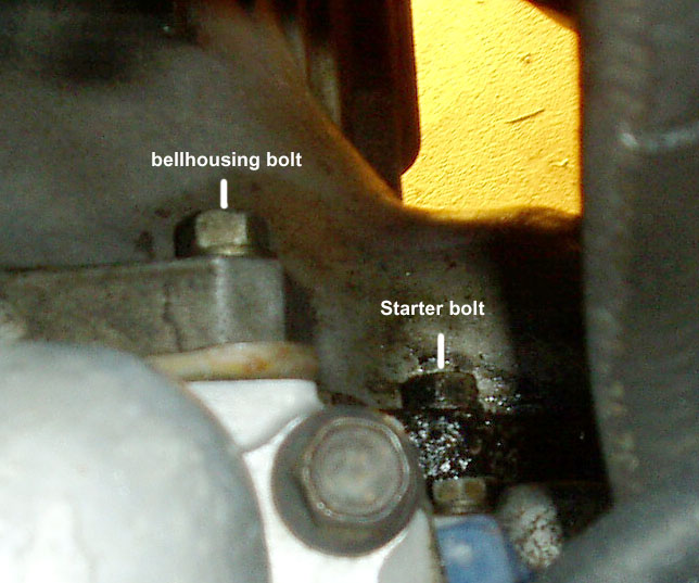

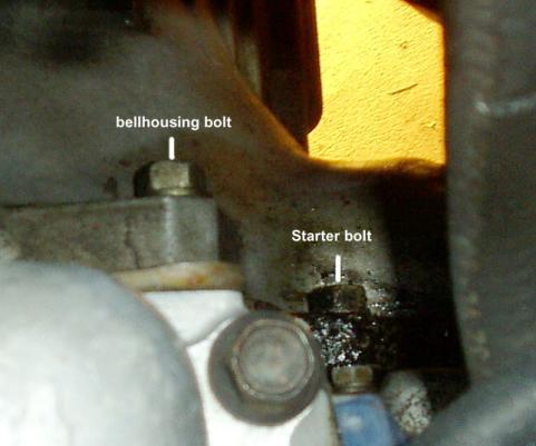

OK, here is what mine looks like. There are no nuts, the short bolts go through the bellhousing and into the thread of the starter motor.
The top one I get by putting a 14mm ring-open spanner on it, using the ring, and hook a 17mm ring spanner onto the open end of the 14mm by its 17mm ring. This gives me more leverage and I can swing it a small amount from the driver's side towards the passnger's side. ie clockwise when looking from the front of the car, anti-clockwise if looking from the back of the car. You could get a long socket bar and a 14mm socket in there I reckon.
Then we have pictures from underneath, where you will have to swing a socket on an extension. From underneath you will looking at the bolt from the back of the car, so it undoes anticlockwise.
Is yours the same? Which bolt & why won't it come out?? Head smashed? Too tight to turn? Can't grip it?

Pretty much the same.. took out the button bolt but can't take out top bolt.. its very tight to turn every time try to turn it sleep out..
