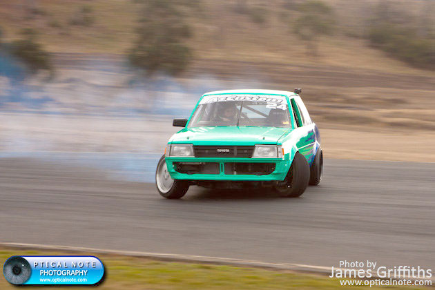

I've decided to build this and sell my ute. What I want to achieve is a track car (drift) but still able to fly somewhat under the radar on the street.
My plans are coilovers built diff, must be powered by a v8 was leaning towards ls but would like something else if I can keep the costs near that price.

Well, its all very straightforward- bluntly, its not going to work!
Look up lLoyd's build, he has done everything you want to do. You can PM hm and have a chat, but I can't see you using a car like that as a daily.
Seeing I do 1000 or 2000km trips every month or two in mine, I can tell you than some things are to be avoided- mainly
Low profile tyres, anything below 60series just crashes into potholes and whatever on Aussie's pathetic roads and destroys rims.
Low hard springs, for exactly the same reason, after 6hours in a car you really feel it, it pounds you to pieces!
Noisy exhausts, which always come with modding cars but deafen you after hours of a droning roar.
If you want a drifter, you can do it with a 4AGE and still manage to get that on the road legally. It won't be a good drift car, and it won't be a good road car, but it will be the sort of compromise young guys put up with for 6months before they flog it off.
The black window trims look good, I must get on and do mine!
Cheers for the reply but I don't think I worded it very well. The 71 won't be a daily ill just drive it every few Sundays. The exhaust won't go past the diff so I'm not worries about noise lol. What I meant by discrete was under the bonnet and no cage for now!

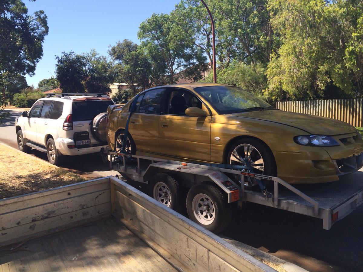

Thanks for that spencer but I'm actually picking up a vx clubsport tomorrow that a mate of mine hit a light pole in side on :/. I didn't really want to go the ls1 route but I picked it up for a good deal.
So I've started taking apart the clubby and the rolla will get the ls1 along with the t56 and the commodore brakes. Won't be a super quick build but I'm hoping to have it finished by this October for power cruise.
