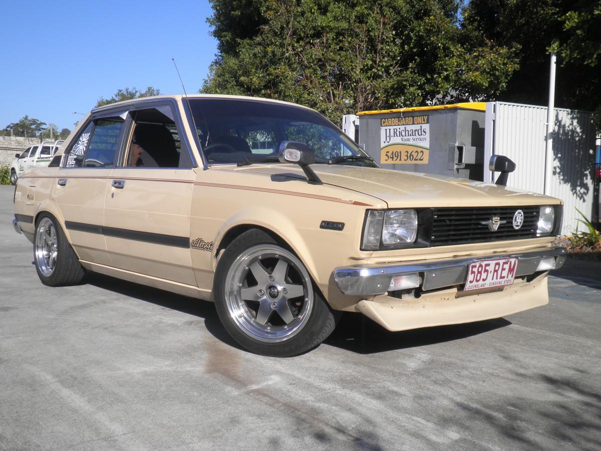

B.L.Z.BUB Posted August 16, 2012 Report Posted August 16, 2012 (edited) This is mine. 15 x 7 +5 running 195/50 all I had to do was lip the guards. I have an adjustable panhard rod to center the diff though. Edited August 16, 2012 by B.L.Z.BUB Quote

Paul Posted August 17, 2012 Report Posted August 17, 2012 Those springs probably wont even take the car low enough to warrant lipping the guards, will probably still be way high. I personally think the 8's may be a bit wide. You may never need bigger than a 195 tyre which 7 inch wheel fits perfectly, unfortunately the grids don't appear to come as a 15X7. I personally wouldn't buy those springs, save money for something a bit better like second hand coilovers for the front and short stroke shocks and lower springs for the rear. Those spring will not make the car low enough to look like the car in the photo you posted. Quote
