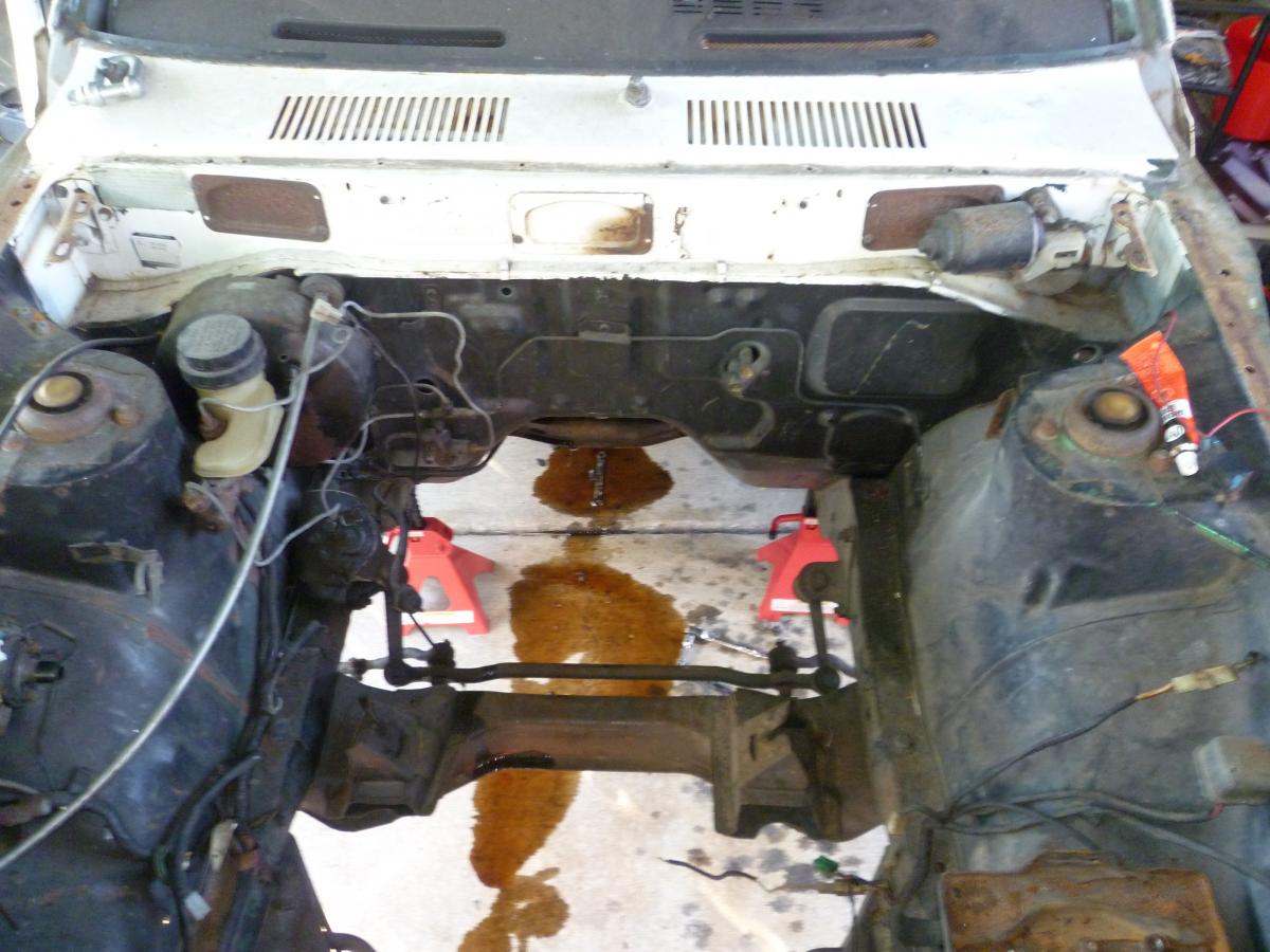

so far have pulled engine, box, front struts, and diff. most of the car was apart when i got it with the majority of interior parts there,

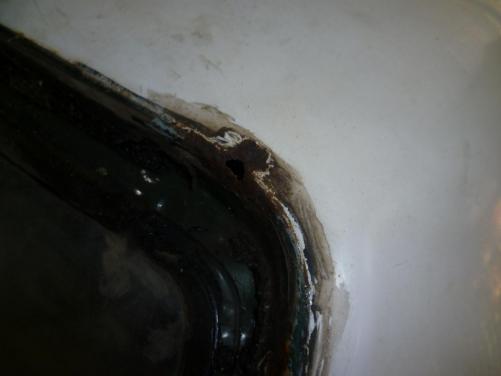

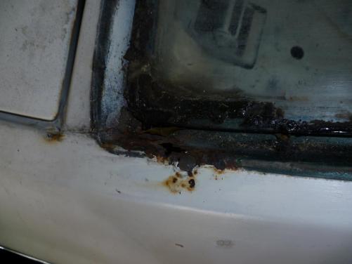

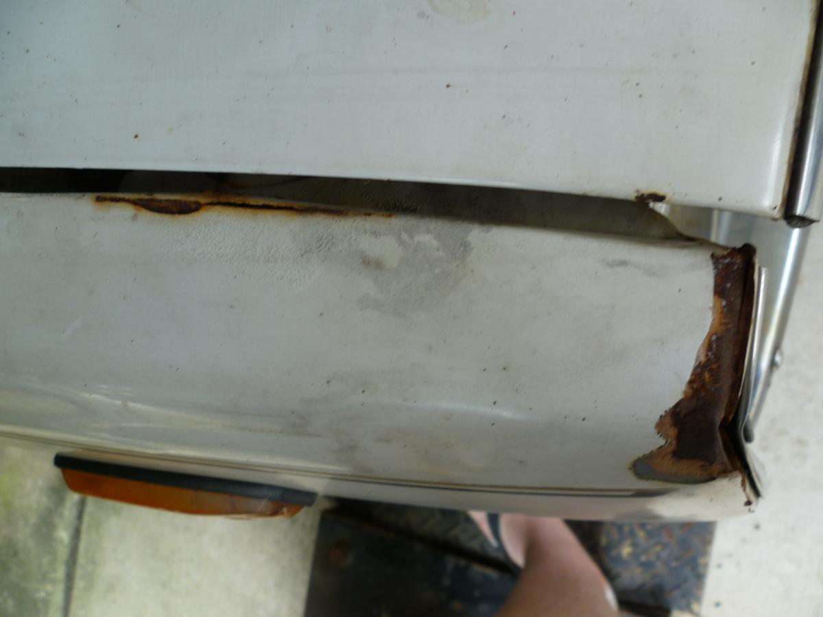

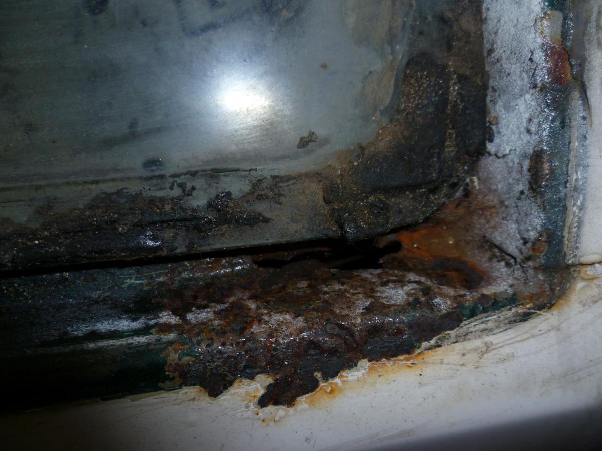

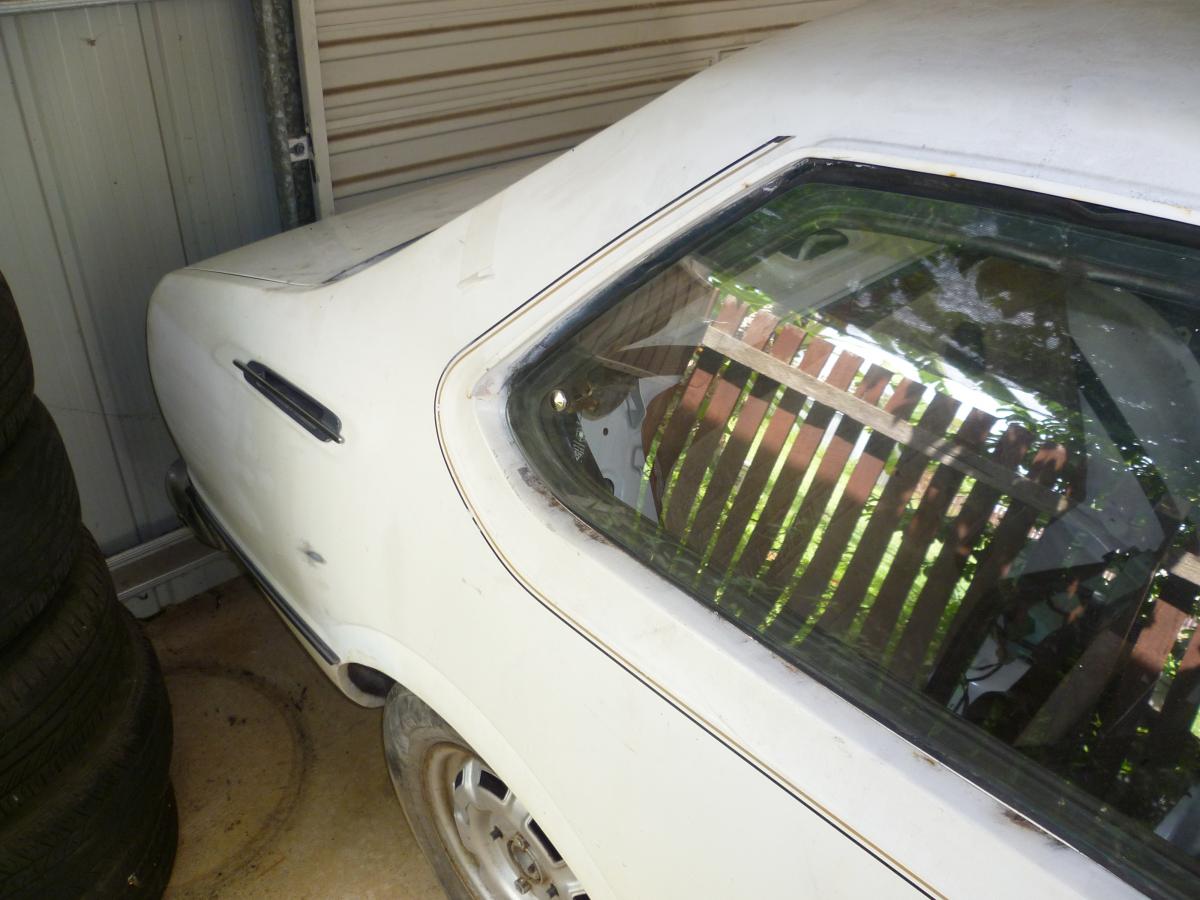

there is very little rust which I'm happy about, 3 small holes in 3 corners of the rear windshield, a couple of small strips around the boot seal have gone, some in the spare wheel well and a bit of surface rust here and there, nothing major.

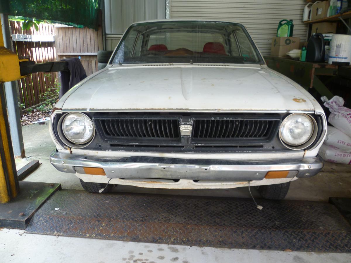

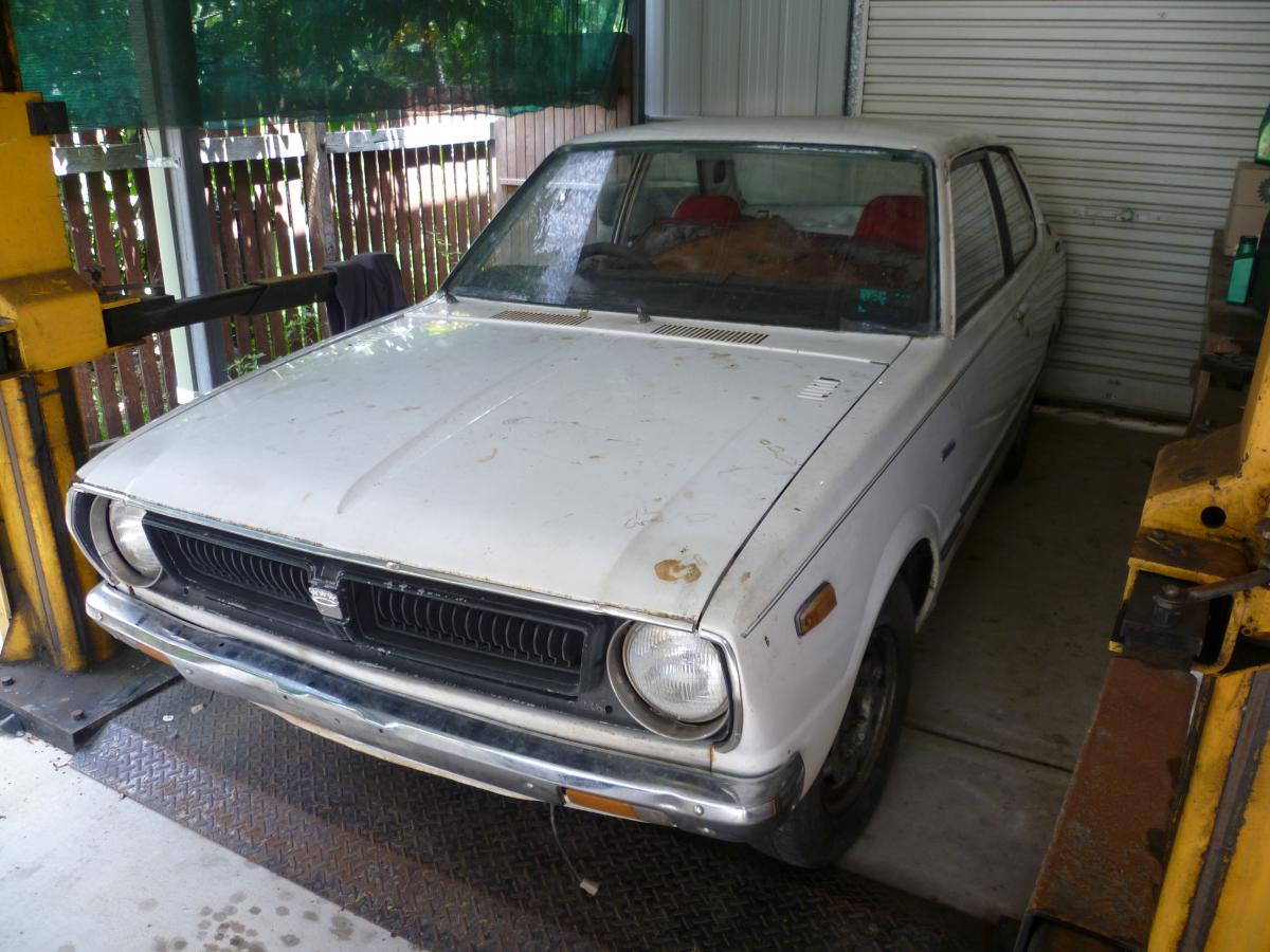

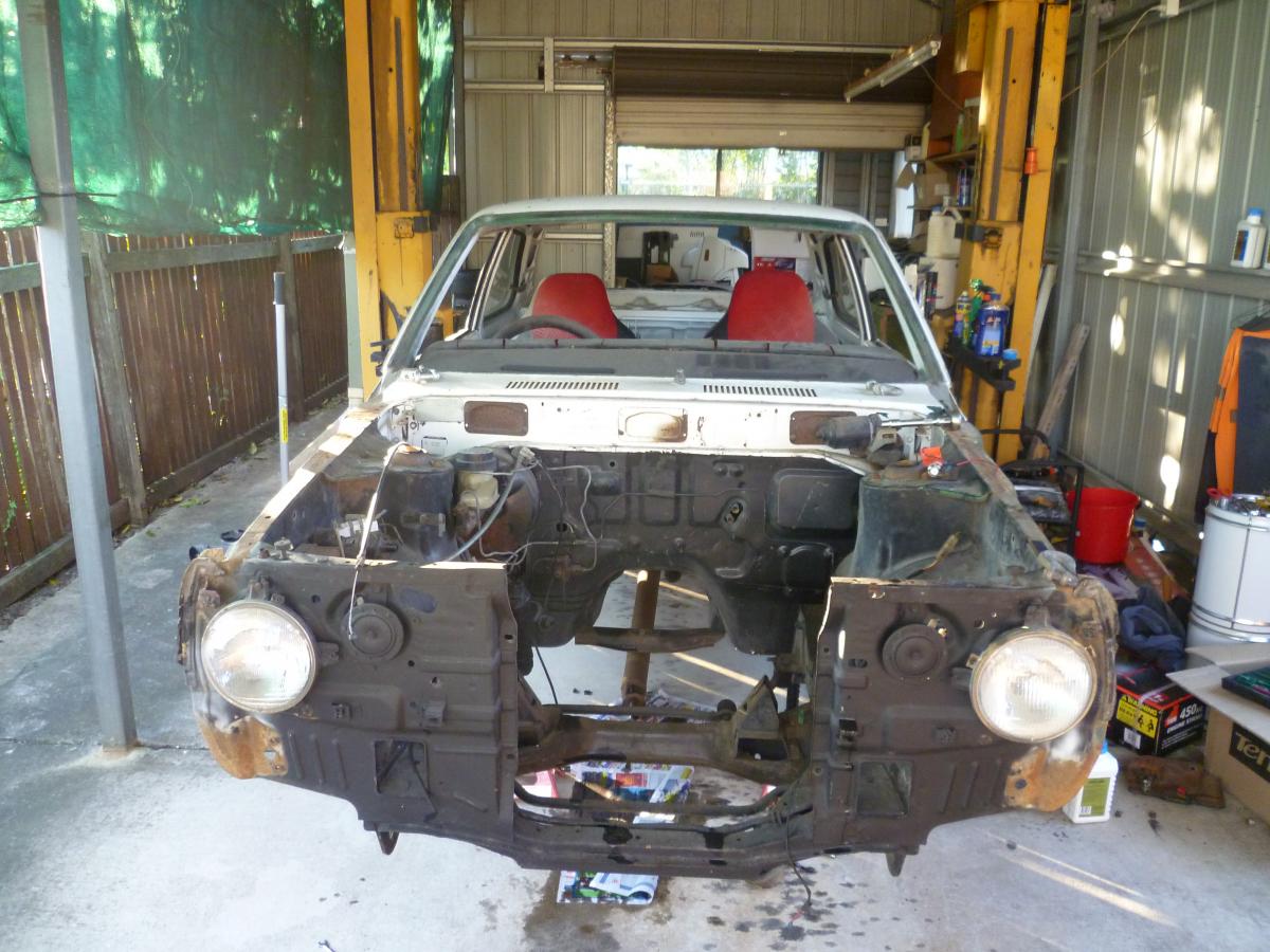

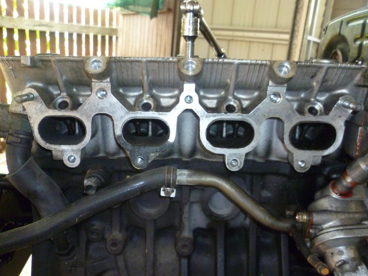

now for the pics, starting with how i got it to where its at now (no pics without struts and diff yet only pulled them out tuesday)post-12384-0-47699300-1345109413_thumb.jpg

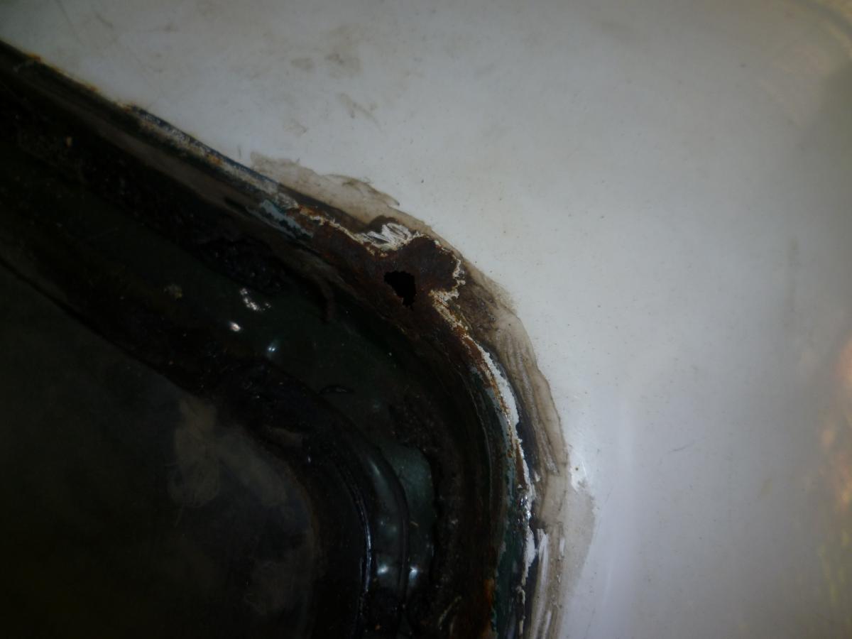

the rust spots

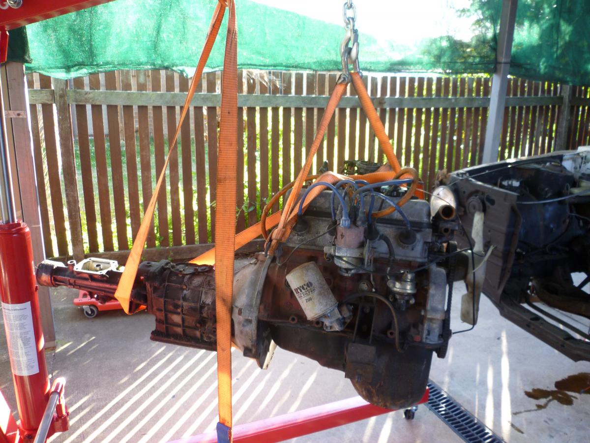

removing the 3k

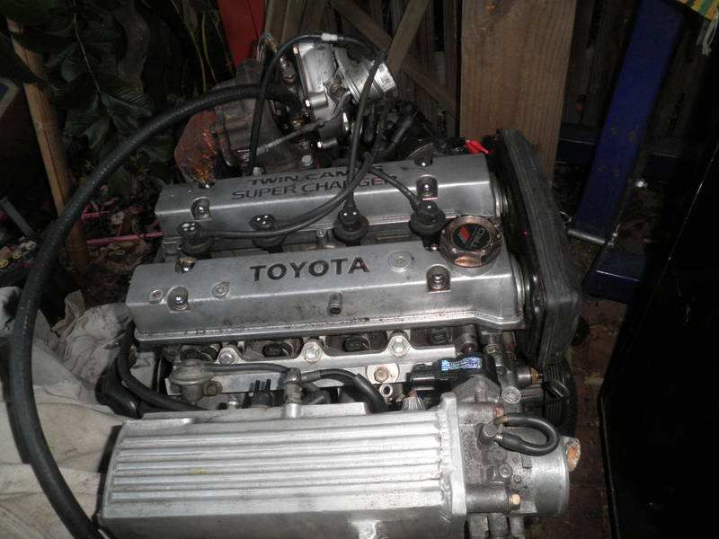

the 4agte as we got it

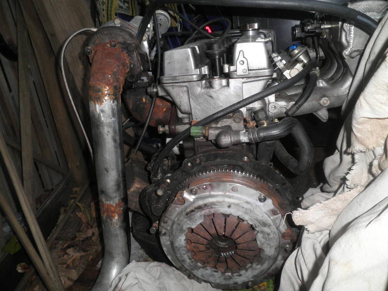

stripping
