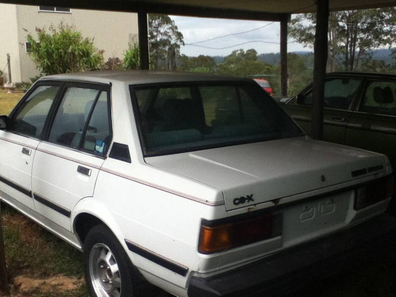

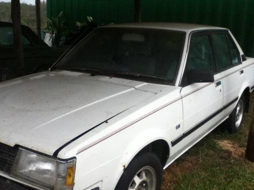

Here are some pics of the ae71 If that helps at all.

Here are some pics of the ae71 If that helps at all. Nice :y:
