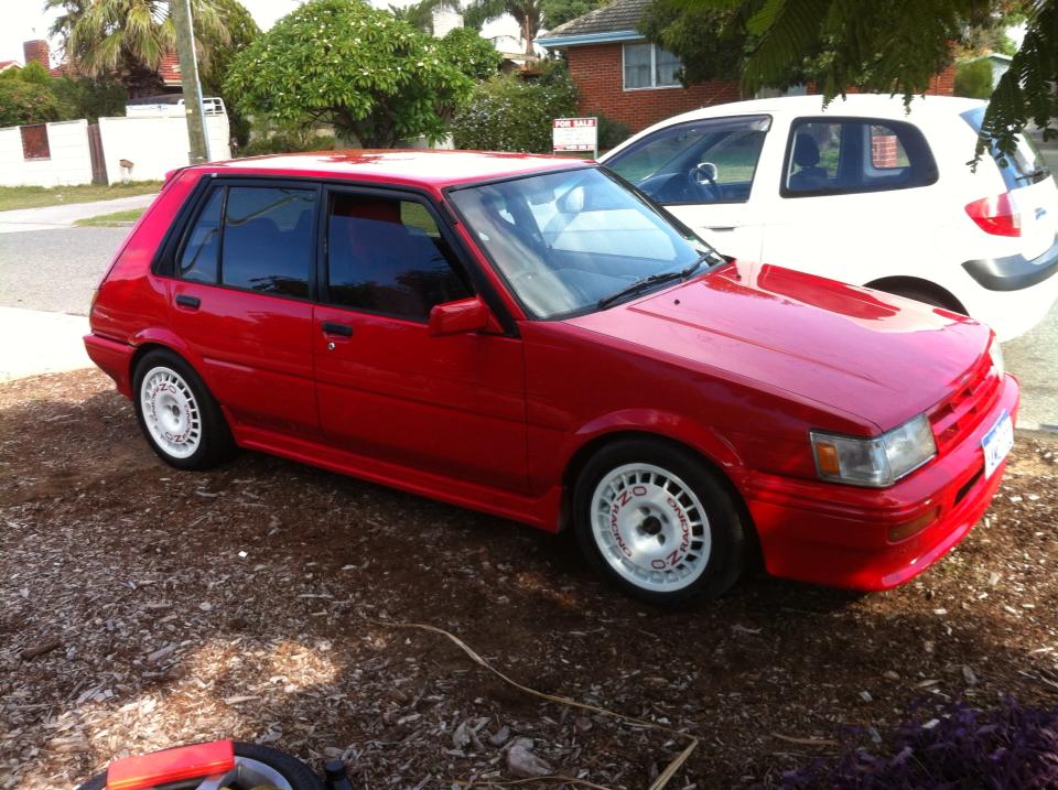

After owning my white 4age ae82 and loving it , I sold it for the same amount I bought my new Red Lebo spec 4agze ae82 (2500). I had previously raced my white one around Barbagello and was 6-8 seconds off the Wrx's and Evo's, I wasnt loosing that much time in the corners even tho I didnt have semi slicks and was suffering badly from body roll ( kingsprings ) , on the straights however is where is was losing huge chunk of time. So hopefully this will counter some time lost on the straights and when coilovers, sway bars go in will be quicker in the corners.
Starting to slowly un-leb it
Intercooler went black for my stealth
New Oz-racing wheels
Was suffering heat sink from extractors near my radiator so wrapped them
Dem wheels!
