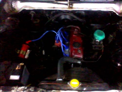

Had check all that u had suggest...run it this morning to work..its totally jerk to off when running...the engine off when i try to accelerate..it jusz run when i adjust dizzy timing to higher...please help..

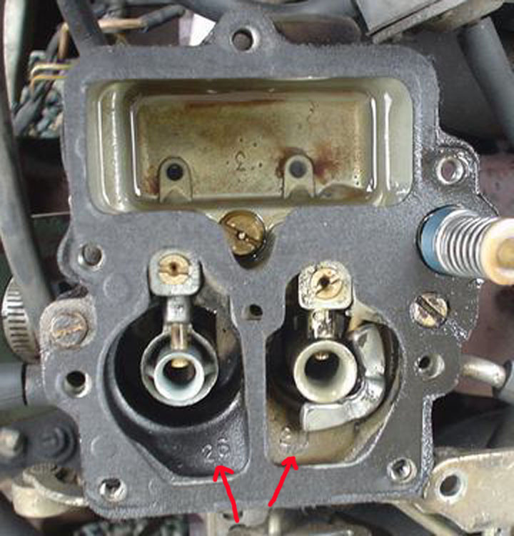

When you check for petrol squirting down the throat, read the number off the choke in each throat. Should be 27 to 33 or so.

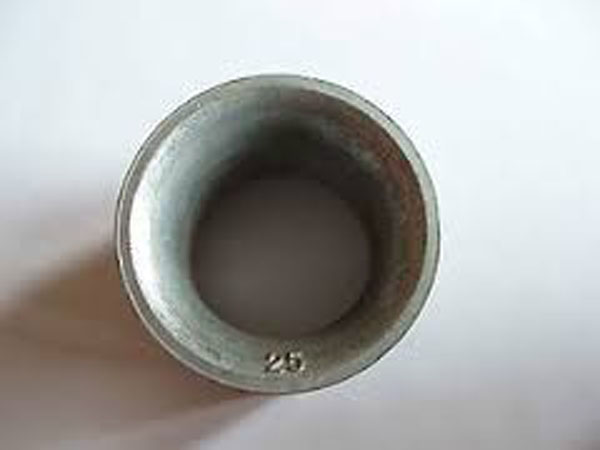

Some carbs have the size stamped on them, so you can see the number when you look down the throat.

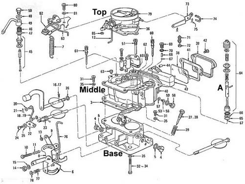

The chokes (also called "venturi" becasue that's the effect they have) can sometimes be pulled out by themselves to measure the diameter of the hole, or sometimes are part of a larger fitting. You just pull the carb to bits.
You can measure the chokes one way or the other, or you can find out what the Nikki came off and Google that specs of that carb.
If the hole is too big it will not give enough air velocity at low revs to pull fuel in properly, and if it is too small the low revs are great but it won't rev so high. (it gets 'choked')
