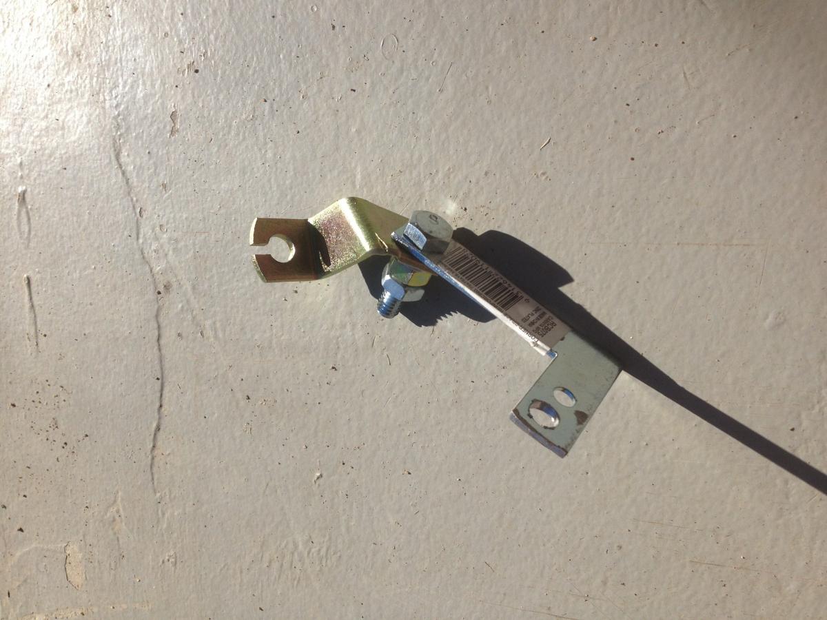

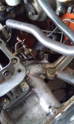

I have a pic here. Just fit my 32/36 webber from eBay, i alao have this fitting that came with it but have no idea what its for....? but how does the accelerator cable hook up? Is there a thread someone could link me too where someone has had the same problem and made a peice up ? Thankyou
I think you can bolt the throttle wheel from the aisan onto the weber, but you might want to check that...
That throttle bracket looks like it may bolt to the top of the rocker cover, and the swivel adjustment to get the angle right. Looks like a little trial and error,

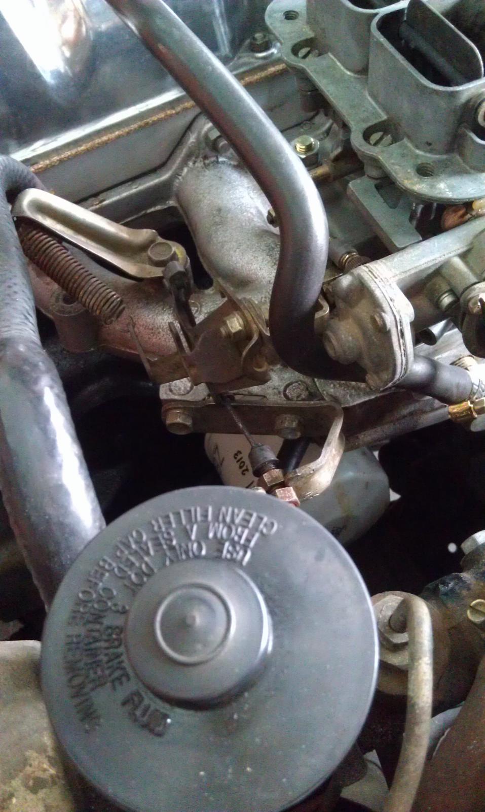

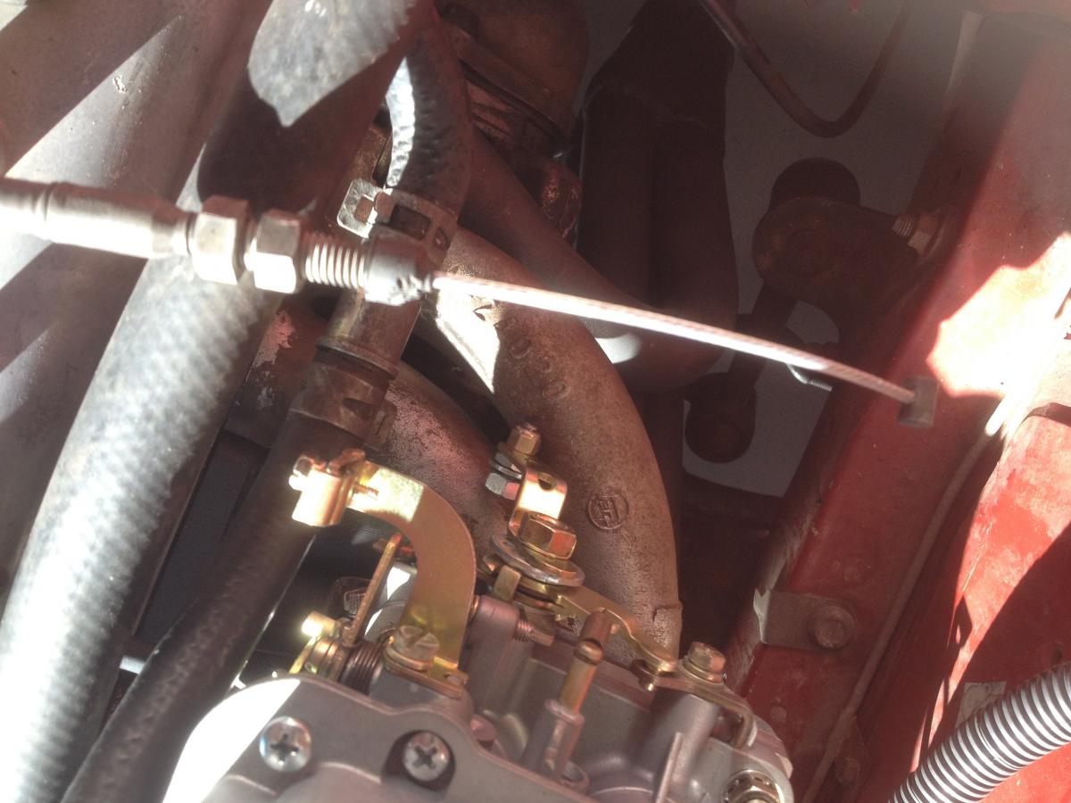

This is how I setup the accelerator cable for the Weber on my 3TC:
The lever was from a T18 Aisan carburetor, but you could use one from a K engine.
that gold bracket goes under the nut on the mounting stud on top of the carby base in the corner with the small notched part down to stop it rotating
then throttle cable connects to slotted end
hope that helps its hard to explain and can't find any pics on the net for you
