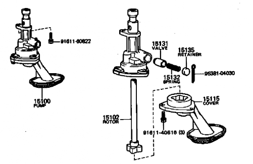

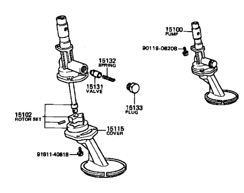

springersrolla Posted October 21, 2013 Report Share Posted October 21, 2013 (edited) hey lads, been thinking bout this build and a mate was saying to me about the bottom end to see if i could get my hands on a high volume oil pump. after a bit of research/remembering, the t series gerotor and k series are apparently the same. I toyodiy.com this and cross reference a t18 with a 3t to a ke70 with a 4k and the part number is the same, as is the pickup/bottom plate with strainer http://www.toyodiy.c...LMESN_1501.html - t18 3T http://www.toyodiy.c...EMDCQ_1501.html - ke70 4k i then got on the brd racing website cause i remembered they did a hv oil pump suit 3t. brd quotes - High Volume oil pump - $169.00 Fitment: 2TC, 3TC, 3TEU, 2TG(E), 3TG(TE) 25% more flow Over Stock. Modified To Deliver The Oil You Need. Better Than any "Over the Counter" Oil Pump From your Local Parts Store! http://brdracing.com...2tc_3tc_oil.htm curious to see if anyone has modified a oil pump to increase flow, and whether anyone has played around with this setup before ?? cheers Edited October 21, 2013 by springersrolla Quote Link to comment Share on other sites More sharing options...
