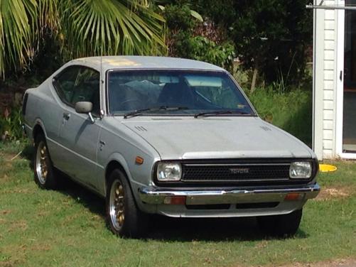

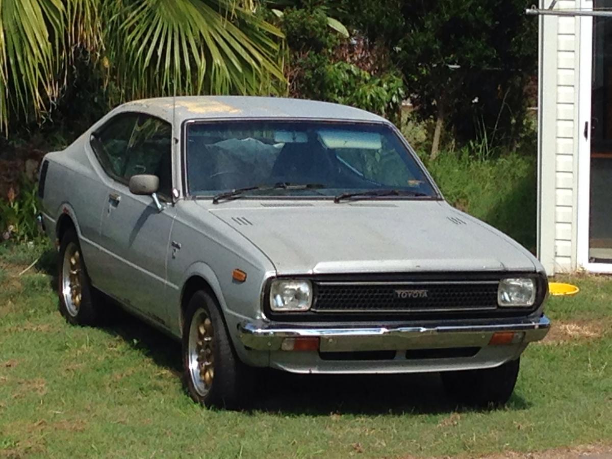

+1 for a coupé if you can find one. I like styling elements of the both the KE35 and the KE55 so my work-in-progress has bits of both.
Look for a car that's been parked out of the sun and rain and has never been driven by a YOLO!
