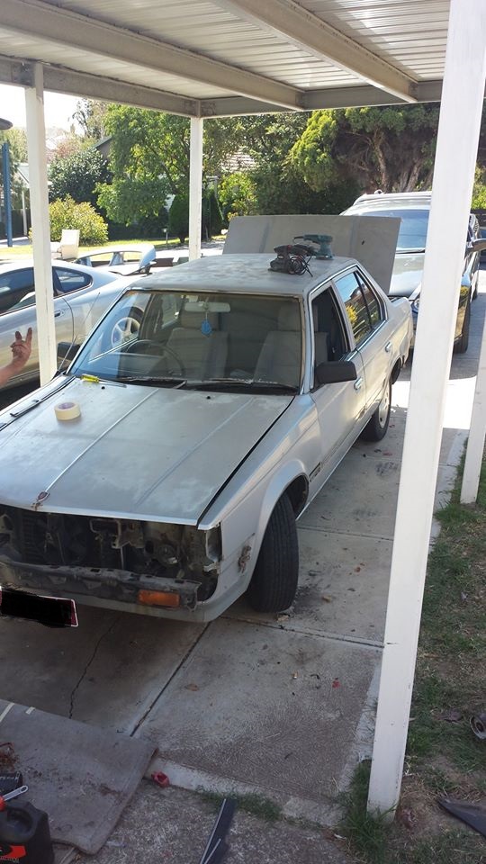

Hey guys recently bought my third rona!
I paid 200dollers for it body is super straight no filler in her at all!

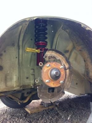

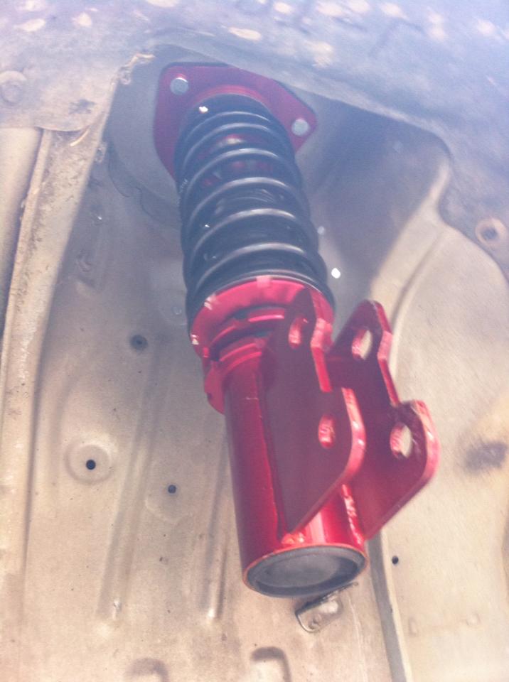

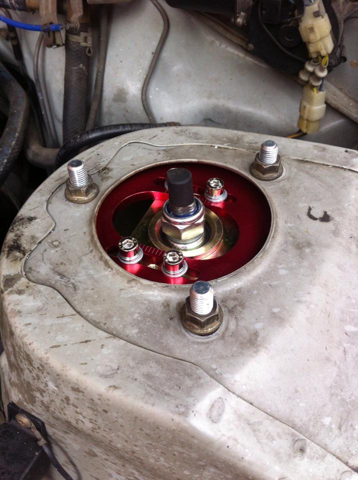

Then suspension... s13 lca coil overs tie rod etc.. But from what people say the s13 set up is shit? but its the cheapest option..
been told BC AE86 is probably my best option keep it toyota they say cost abit more but will it be worth it????
......weld on front kit, cut standard struts and weld kit onto spindle, drill couple holes in your strut top,
full AE86 BC kit and be done with it for around $1200 thats rear shocks and springs

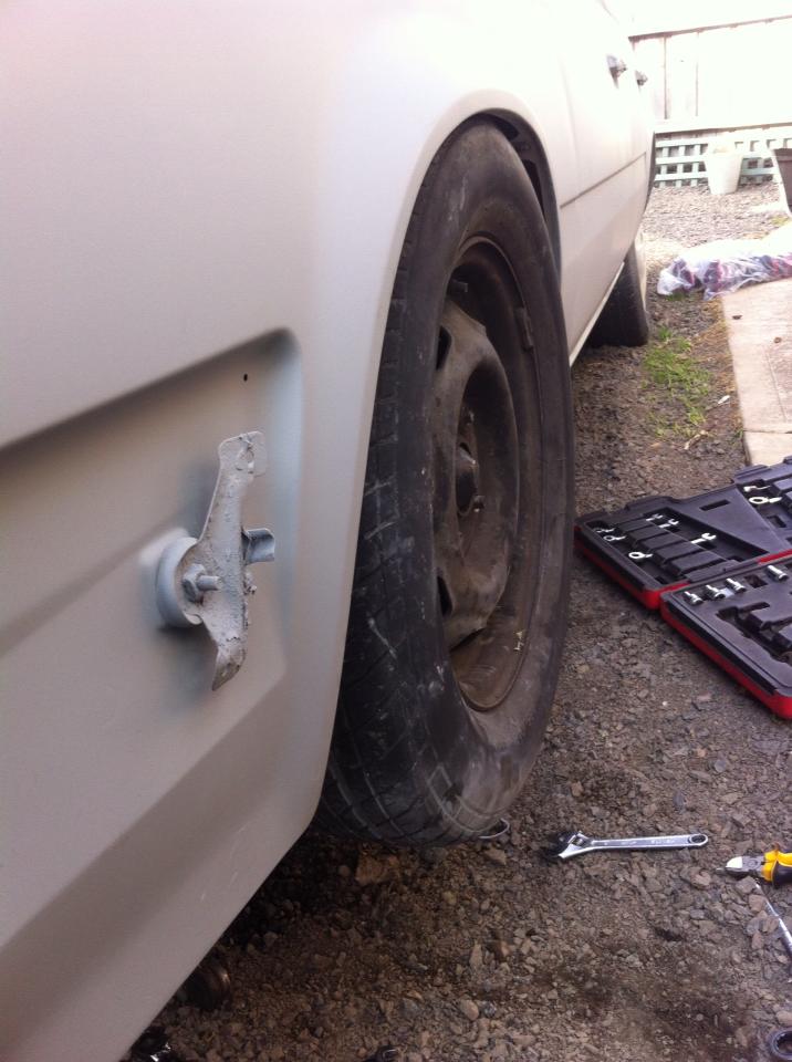

RA60/MA61 calipers and rotors bolt on the front. Cheap and way better than stock.
I was gonna put them on my XT130 struts so I am guessing they will fit on the ST. What calipers does it have on it now?
it has factory breaks on it atm, was going to go with the s13 front end set up and use the sr turbo breaks n hubs but
everyone tends to diss the s13 set up for some reason so I'm just gonna go with the 86 coils..

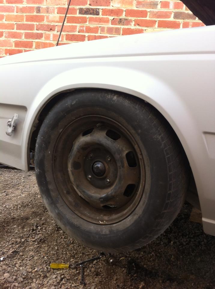

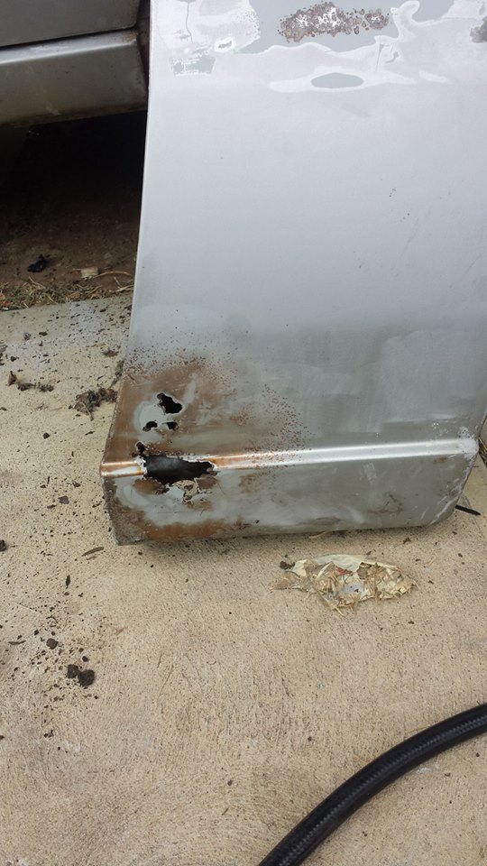

So i had a bit of rust on the front driver side quarter guard so i thought stuff bogging it up ill replace her with a new one!
And look what i happen to found!!! damn i was in this car driving it around I'm guessing theres more inside the car!!!

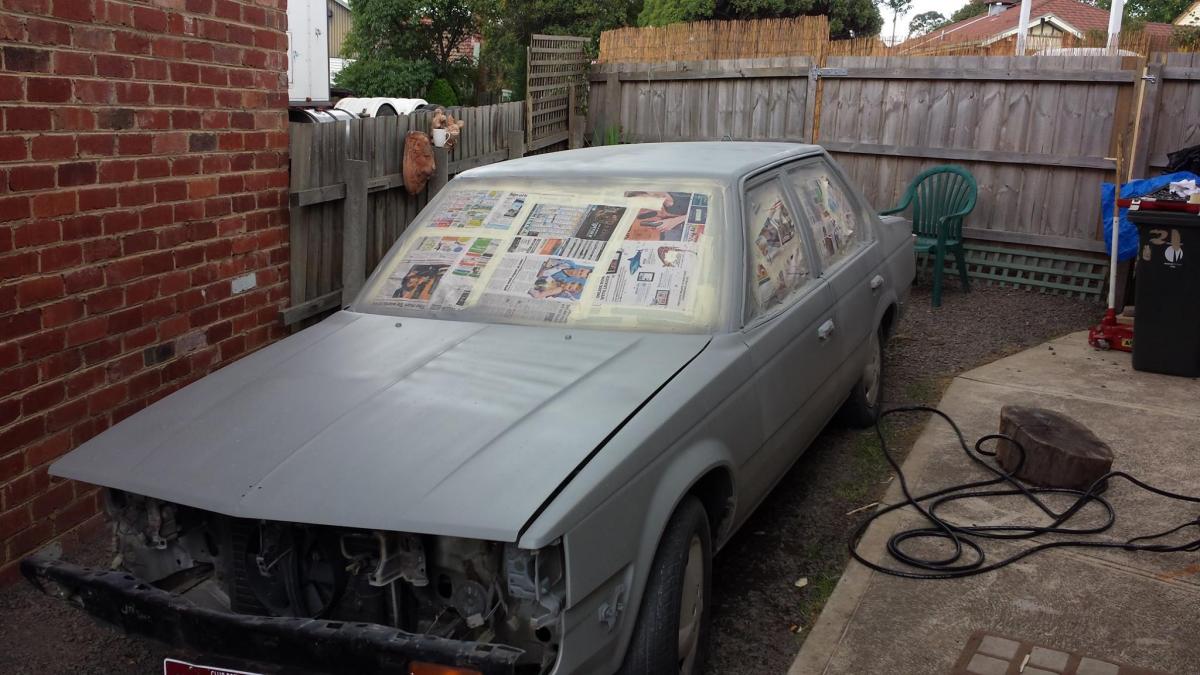

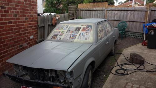

Car is almost fully sanded and ready for primer!!!! can't waitttttttttt!!!!!!!!!!!!!!!! till shes nice n clean

Why not just shorten and coilover sleeve your stock struts?

Ive already got all my s13 gear man ready to go! just need coil overs

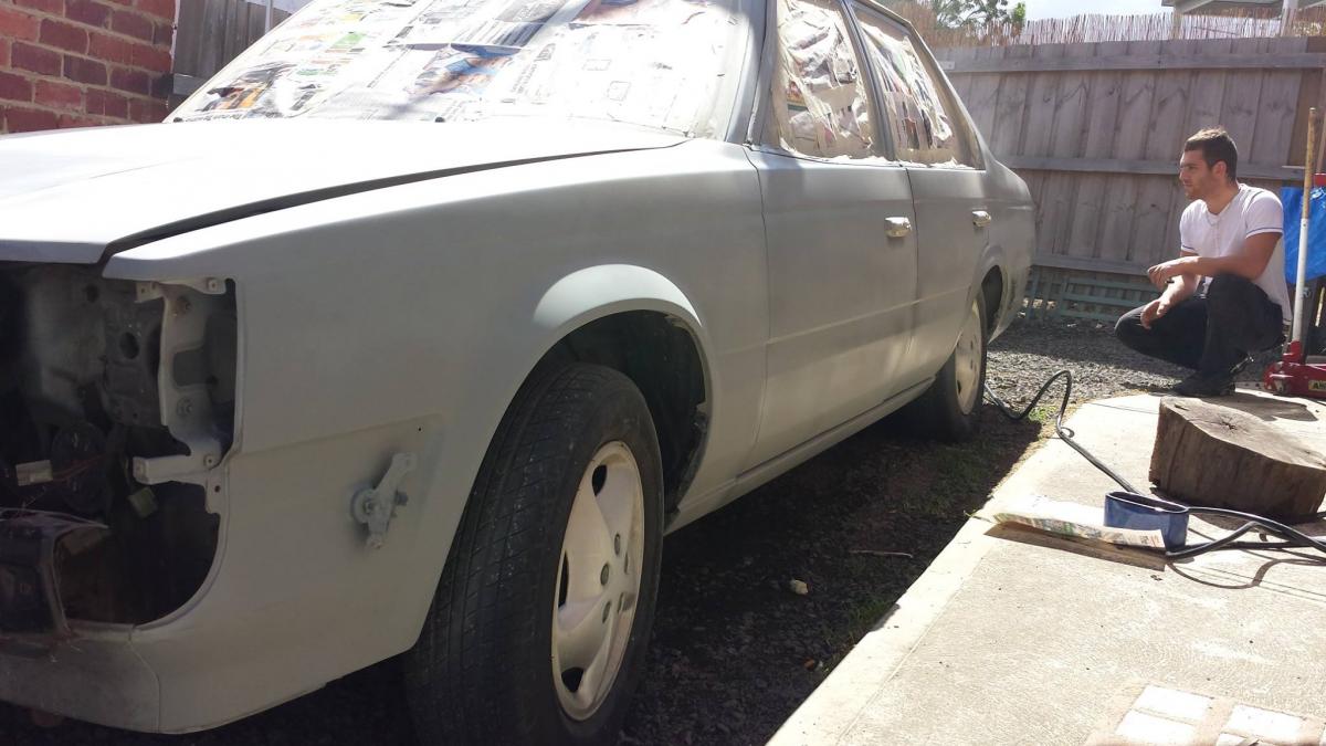

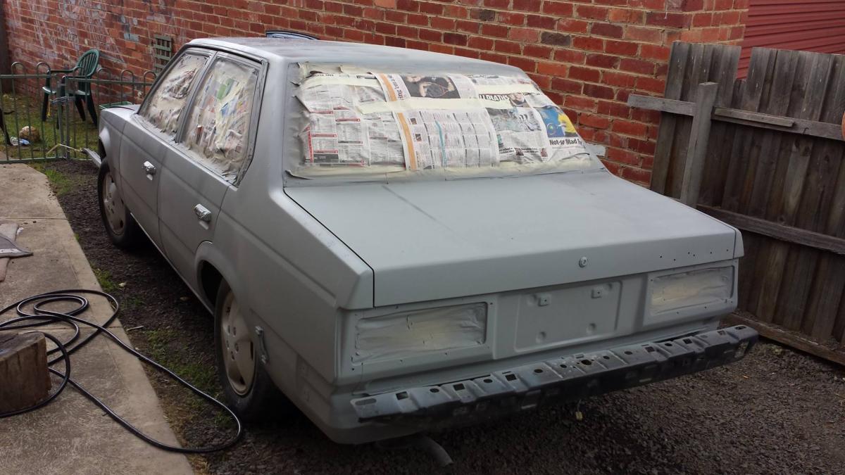

So time has came,
car is finally in primer! woooooo!

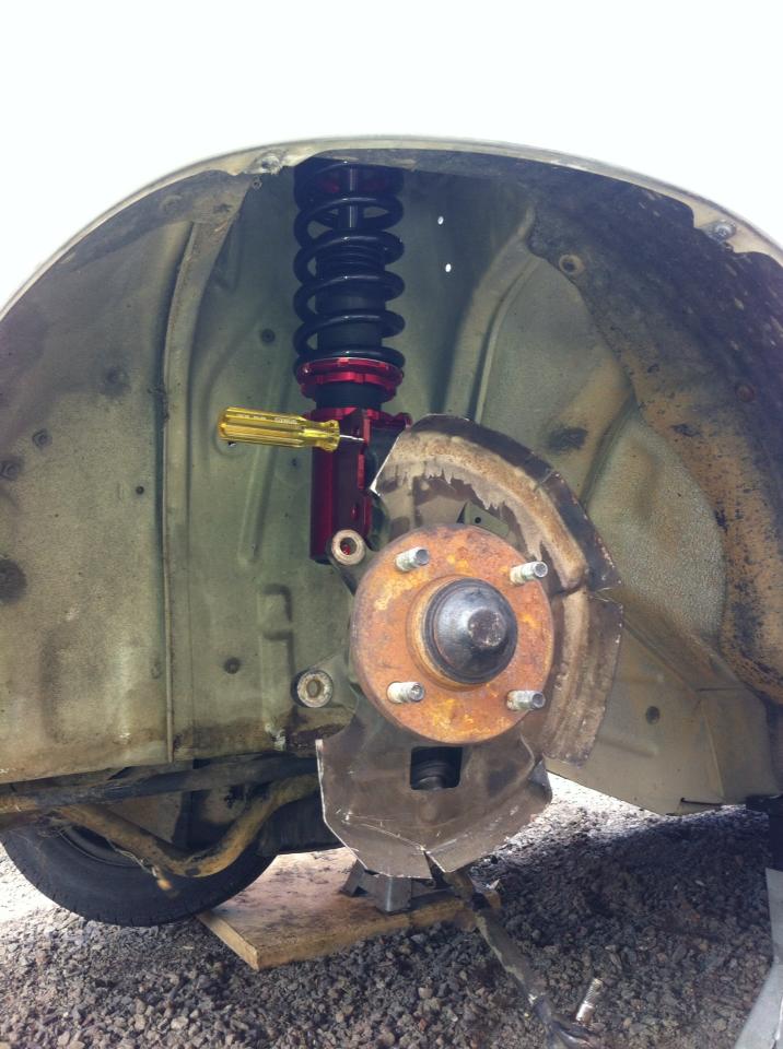

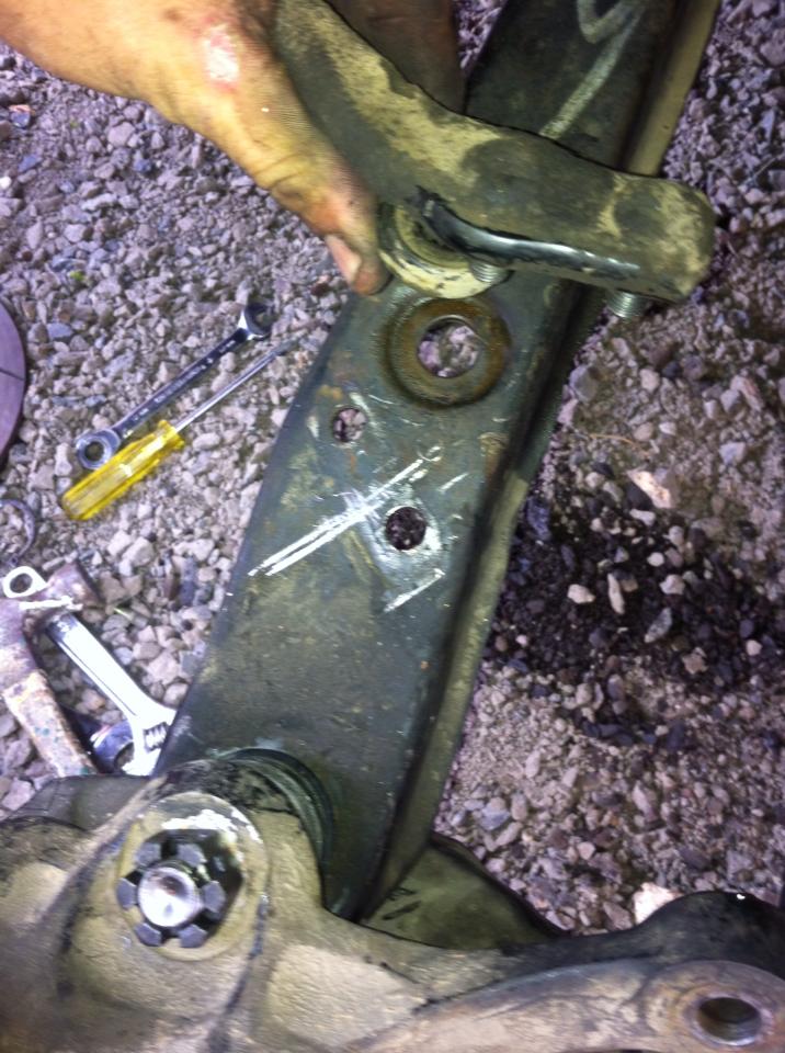

S13 front end is now in just needs minor adjustments!.
