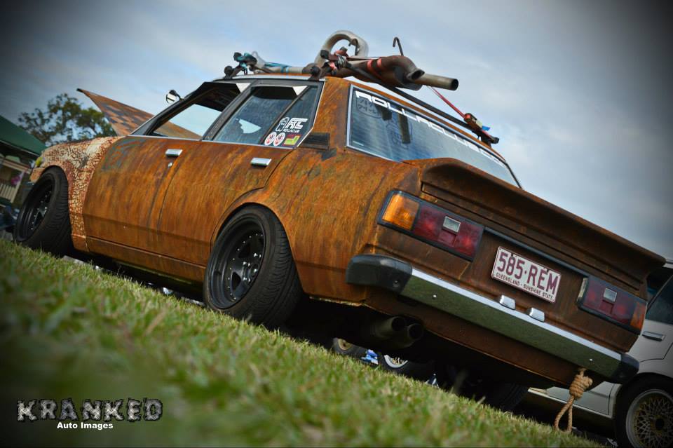

Also If you know, I'm a bit confused with tyre stretching, I don't want it to be unsafe and everything but i would like it to fit nice in the rolled guards.
Is it unsafe or illegal to run 195's or something on 8 inch's
Are they 15x8 +0 steelies from ebay? i was thinking of getting a set of them to save a heap of money. That looks quite nice, I'm just not sure if any shops would put them on for me?
They do pop off the rim easier than than they should, according to a rally mate who owns tyre shops. Halfway through a corner with the outside front wheel loaded up, the tyre rolling underneath and you hit a sharp little pothole or hollow in the road... I'm not sure at what size they get to be a problem, these guys say a 15x8 can take anything from 215 to 245, so a 205 would probably be fine.
