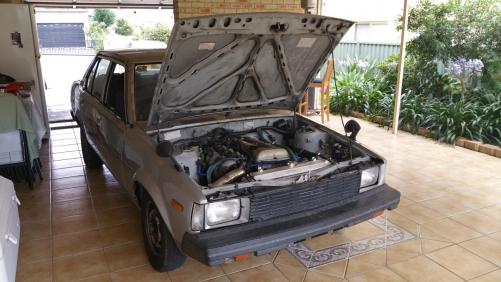

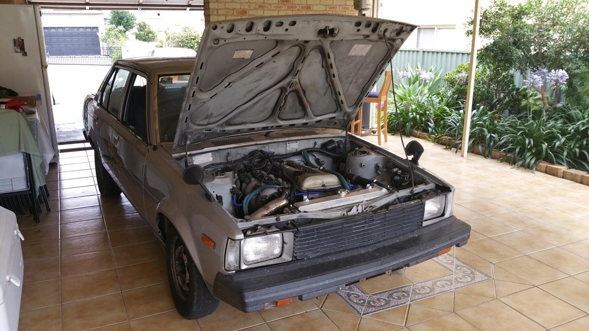

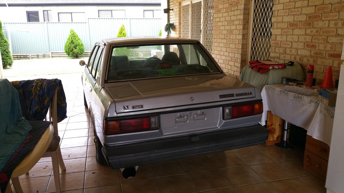

New member new weekend toy! I have always been a Toyota fan starting off with a Toyota Sportivo then 2x Lexus is200 now this. Found this bargain on AE86DC and could not resist to pick it up. Has some rust spots which i will be fixing shortly.

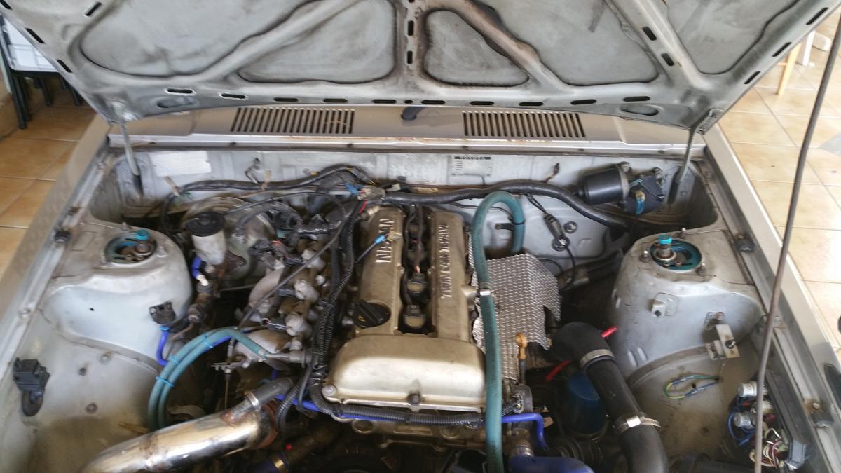

KE70 w/ sr20det running gear incl. gearbox (unsure if red or blacktop)
Stock 180sx ecu all electrics work except speedo/tacho
T28BB turbo + Front Mount
Hilux diff - 4:11 diff gears (apparently)
3" Tailshaft
Big fuel setup - Surge Tank + 2x external fuel pumps
Oil cooler + Oil Filter relocation
Exedy HD clutch
Initial plans
Get rust spots repaired (only minor)
fix up interior and engine bay
find some new wheels
put rego
Future plans
not much is really needed as happy with its state.
maybe a 2871 turbo and supporting mods
respray + shaved engine bay
all feedback is appreciated :)
If anyone knows how to wire dash to stock 180sx ecu that will be great!
