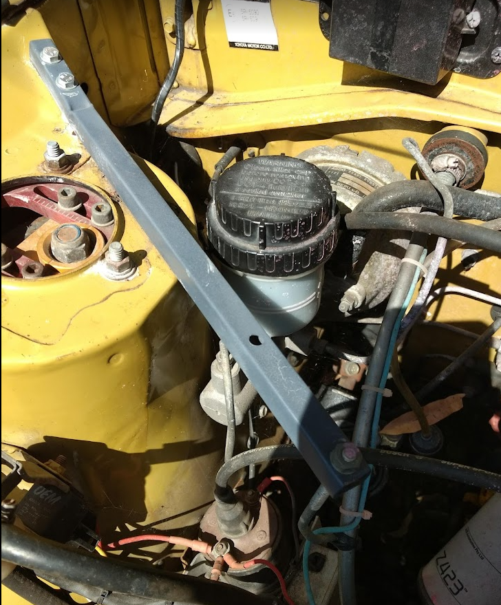

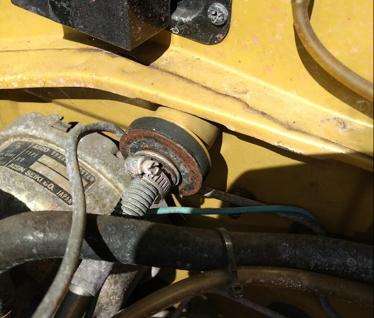

Yep !  Very common problem, that "bloody" circlip. It's probably back on the road somewhere, although have a good look down in the engine bay, in case you were lucky, & it jammed or landed on a flat surface somewhere.  It's dark now, but in the morning, I'll lift my bonnet, & take a pic of how I fixed it for good.  I think off memory, I a small hose clamp around it, & stopped the circlip popping out.  It worked, as that was years ago, & I've never touched it since.

As Altezzaclub says, . . . . .  the good olde hose clip.
However, I have found that the forces on that hose clip, can increase significantly, if the clutch cable is not oiled/lubricated well inside.  Because the clutch cable action passes through 180 degrees, it is also important to ensure the curve of the cable sheaf is smooth & doesn't move around, when operated.  Hence, I attached a bracket to the tower, to accomplish this. It works well.
Every year or so, I remove the cable; hold one end in a vice, & whilst jiggling it up & down, put oil into it in drops, until it appears at the bottom end.  Never had a problem since.
