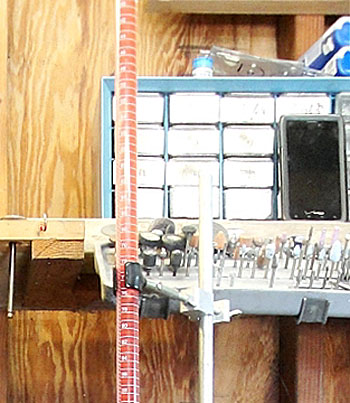

oldeskewltoy Posted June 19, 2015 Author Report Share Posted June 19, 2015 Now THAT's a nice tray- Not enough :yes: likely going to make my own tray... likely have 75-100 1/8" holes, and a 15-20 3/32" holes This was a partial head when I began' date=' the valves in this head were not originals to this head, so in this case although being re-assembled, I fully expect SOME dis-assembly of the valves for those needing to be tipped. [/quote'] I managed to get the intake set... a few thin shims were needed. the exhaust side is another story... #1 valve, even with the thinnest shim I had was still a no pass, so I'm planning on taking a "big swing" @ the tip of #1... a few others are almost as bad.... more to come..... :D Quote Link to comment Share on other sites More sharing options...
