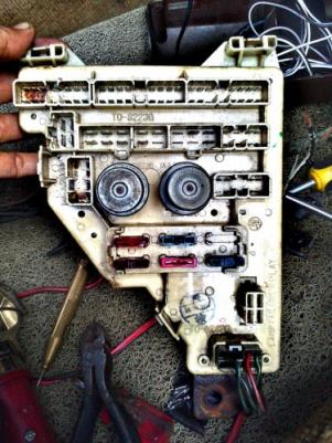

I'm 17 years old car enthusiast from Estonia and I'm having a problem with my KE70.
This winter something happened with kick panel fuse box, I opened it and saw that some of the circuits (aluminium parts) had blown. It melted the plastic around the circuits and the fuse box is now a pretty big mess :D, so I don't know which circuits to solder and which not. I would be very thankful if someone, who has the same fuse box, would disassemble it and take pictures of different layers there.
I found possible problem and fixed all the wiring harness, so I don't think that the circuits blow again.
I would buy new fuse box, but probably I'm only KE70 owner in Estonia(so there are not any parts for sale) and shipping from Australia would be very expensive.
Best wishes, Madis

I think i got it repaired, everything is okay when ignition is switched off, but when I turn it on then there is a short somewhere.
The bad thing is that I don't really know much about electricity
