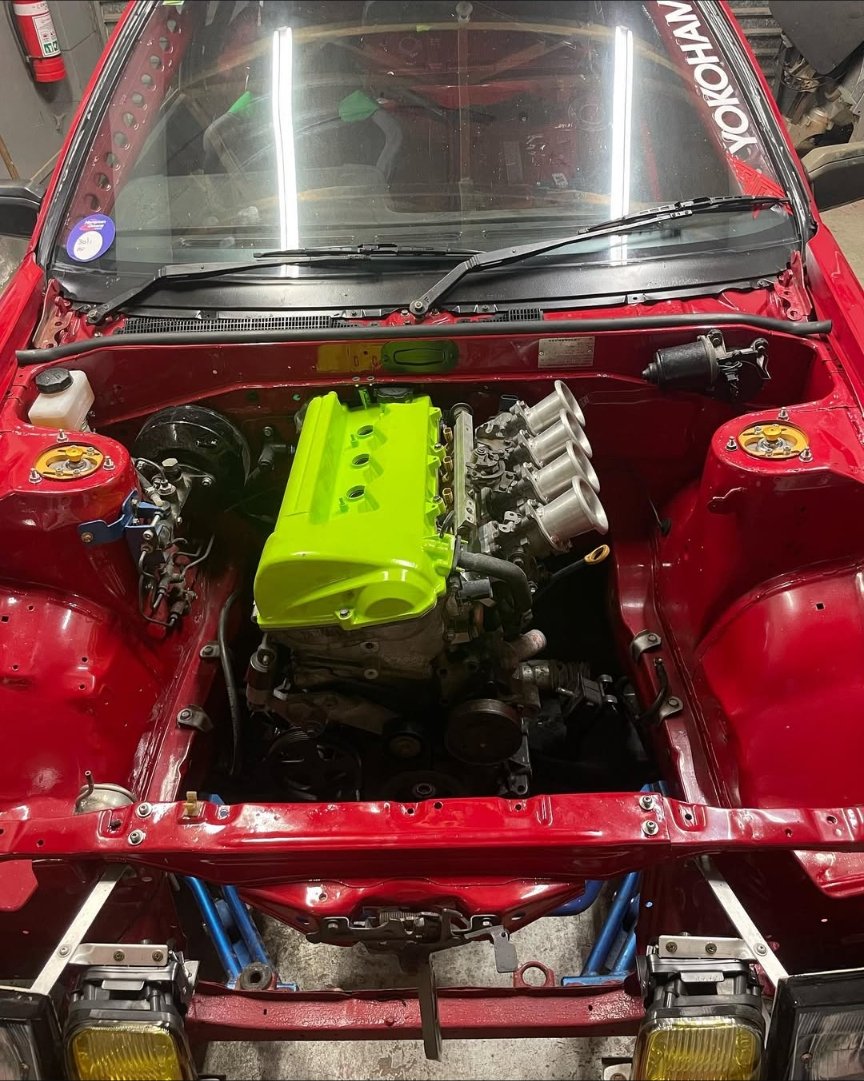

The KE is finally moving again. It’s getting a 2ZZ-GE with a GT2871R I picked up off Marketplace. Niteparts do an AE86 conversion kit, so I’m on the hunt for an AE71 crossmember to make that work.
Still going ITBs… because I clearly hate myself. CNC Innovations do a 2ZZ-to-ITB adaptor, then I’m running a SQ Engineering to GTiR plenum adaptor plate to tie it all together.
I’m doing an electronic throttle conversion using a Honda APS and an AE86 pedal. The ITBs are actuated via an EFI Hardware throttle actuator, so the throttles themselves are still cable-operated — just way less fabrication and a much cleaner setup overall.
Out back I scored an RN40 Hilux diff, currently sorting disc options for it. Steering is Prius electric column power steering because I’m running AE86 power-steer knuckles and a FLOS quick rack, which makes it properly heavy up front without assist.
Brakes are Series 5 RX-7 4-piston calipers on AJPS mounts, with a standard EP91 Starlet booster and a Pajero master cylinder.
I’m also running an electric A/C compressor, as the factory A/C mount is right where Niteparts pick up the passenger-side engine mount.
Fuel system is a S13 EFI tank — fits surprisingly well, hangs a touch low but gains about 10L extra capacity, so I’ll take that win.
This is very much a spare-time build, sourcing basically everything from Marketplace and wreckers. Case in point: I’m even heading out tonight to pick up an Evo 8 intercooler to more or less copy a mate’s setup, even though our hot and cold sides are different.
Funny how getting older means making slightly more thought-out choices… still dumb ones, just better planned 😂
