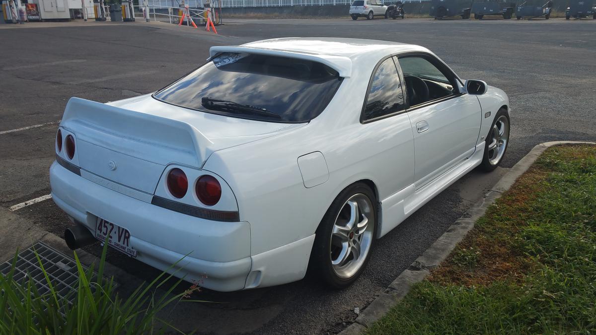

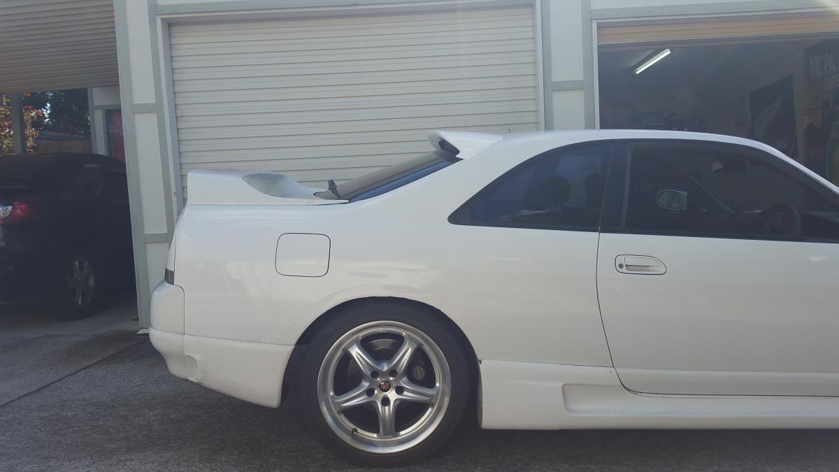

Installed my camber arms. Tucked the wheels a small amount to stop and rubbing on the rear and to keep mr plod happy.
Not a huge amount

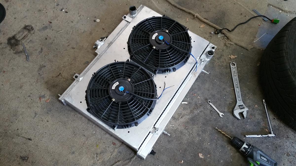

Spent a good portion of yesterday mounting my $50 fmic kit.
Instructions said to cut down the engine fan but that sounded a bit dodgy so I threw in 2 thermos for clearance. These plus the stock thermo all run off a thermo switch/relay circuit hidden in the stock relay box.
