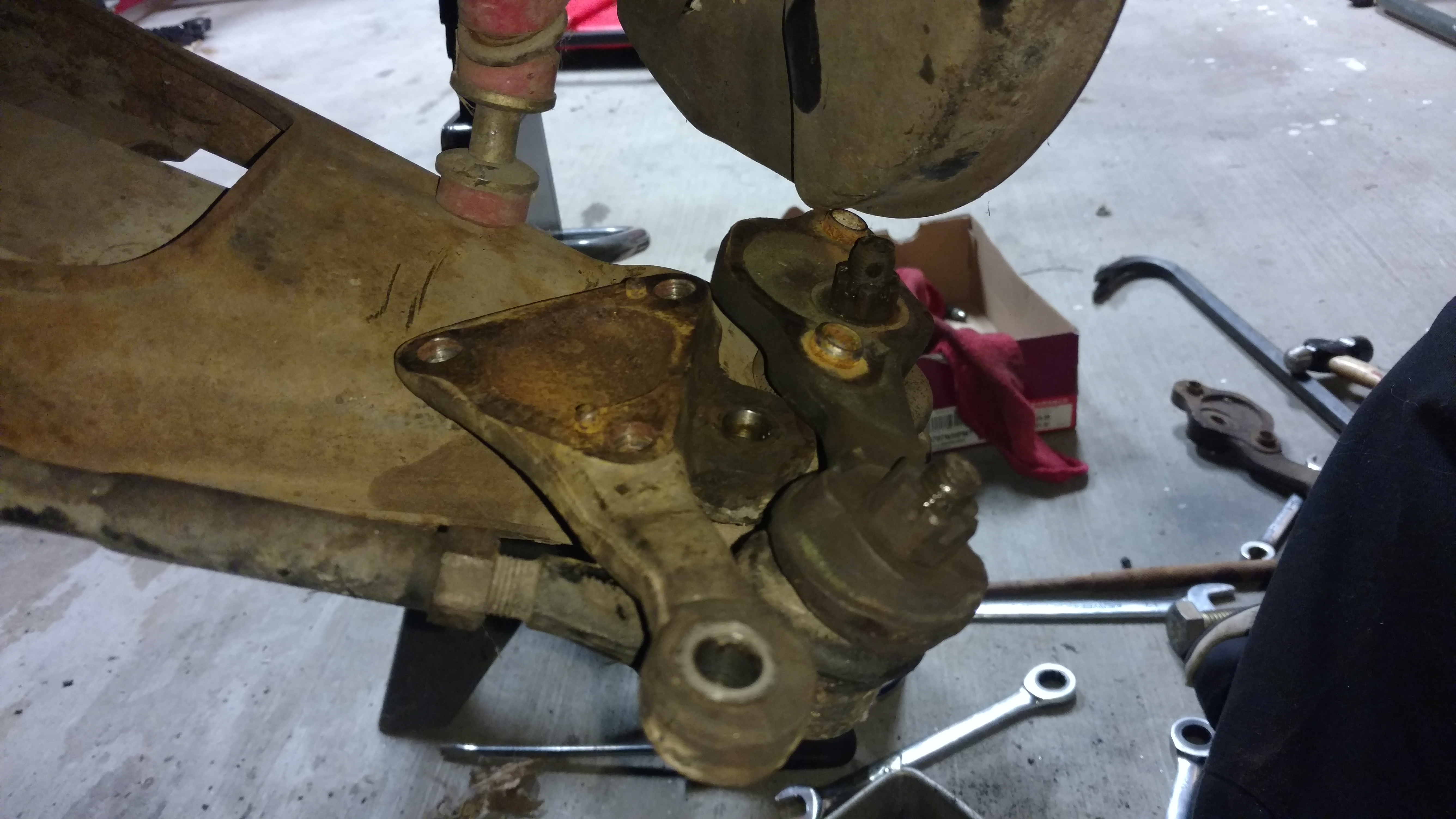

I'm in the middle of swaping kp61 struts into my 69 KE18. Problem I'm having is the angle of the kp steering knuckle is too sharp to use. What fixes did you guys use to mount the 2 bolt kp or ke2 struts to the E1 arms/ball joints?
