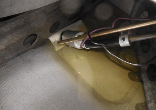

Meanwhile down the back I took the tank out, removed both access plates and started cutting the suction line shorter for the lift pump. The plate that the lines go through is easily drilled for the wiring, and I used the Commodore stuff for that. The pickup sits right on the bottom, as photographed through the fuel gauge hole..

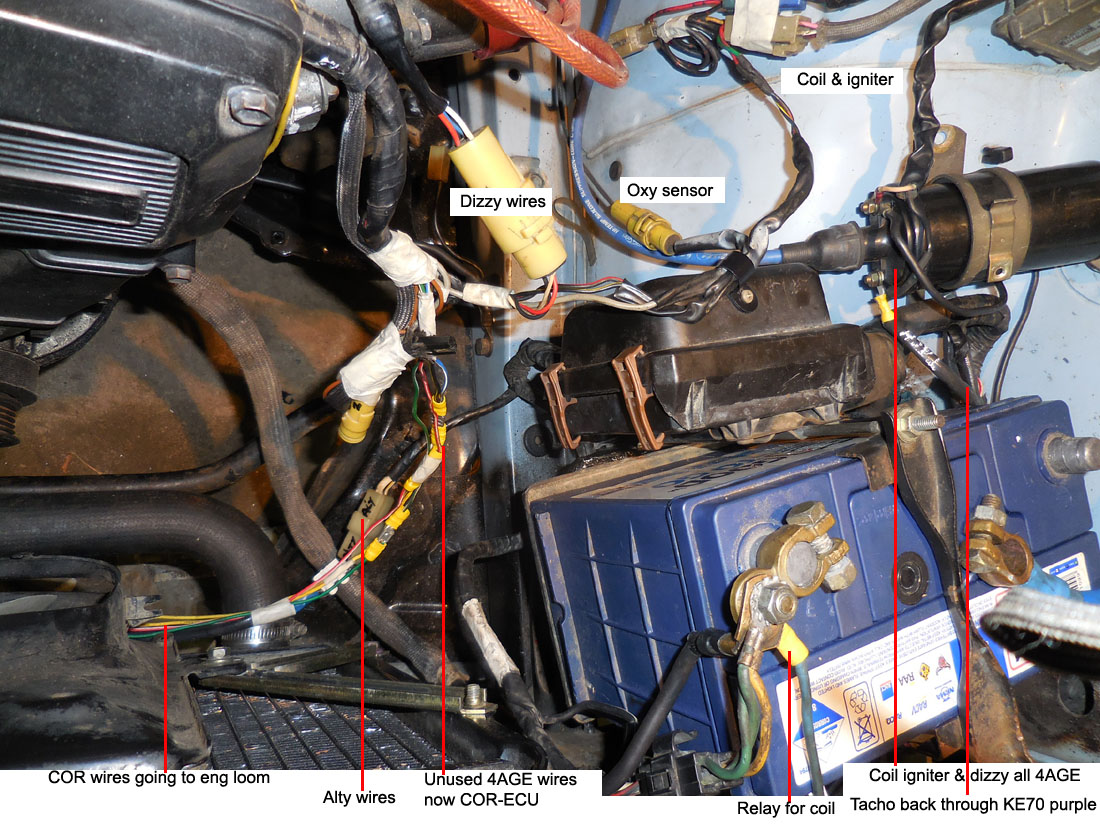

Inside, this is happening... Power is fed in from the 4AGE alty, just half a metre away. Two KE70 switching wires go in, one on ignition from the KE70 B/O nearby, and one from the KE70 cranking wire also sitting there to bypass the 4K ballast resistor. Those are the blue highlights. When it is working, it powers the green highlights- the rad fan and its temperature switch, and the fuel pumps. The yellow highlights are the signal wires you have to run to the ECU.
Now, wiring.. For the lift pump I took two long wires from the Celcia loom & soldered them together at each end in paralell, because I was worried about one wire being able to carry enough power. Actually I had to lengthen them some more to get them into the engine bay alongside the KE70 loom under the mudguard. The main pump was easy, it is right by the COR, as is the alty for power supply. That leaves the signal wires to the ECU. Hanging on the end of the 4AGE loom at the front are some wires that don't get used, but they will take power back to the ECU for you.
You need to get some wires from the three COR box signal wires to go under the radiator and join to these unused wires. Add the alty wires going across the bay to the KE70 alty plug on the battery relay box, and add the fan wires to them for some of the way. This under-rad loom is the only one you need to make up. Coming up- all those things like STA, Fc and BF...
Edited by altezzaclub
  • Upvote 1
Some time spent with a multimeter will tell you which wires go where in those extras, and you join the 3 signal wires to them. Just cut them off at the ECU plug end and label them, and leave them hanging. Then you can tape up and cover the under-rad loom. I haven't cut the other unused wires off yet, same with all the extra ones coming out of the COR box.
The alty will have a round plug, so when you're at the wreckers get a couple from Camrys or whatever Toyotas are there. Add the COR box feed to the "B" terminal that sends power to the battery, and run the other two across under the rad to plug into the normal KE70 alty plug.

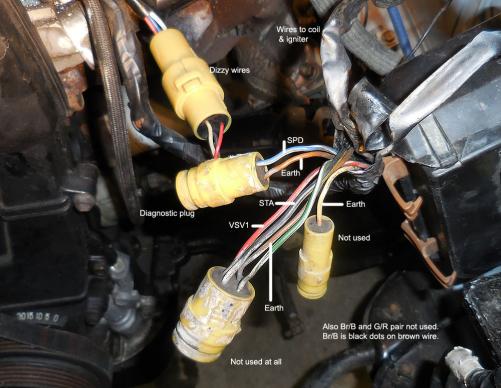

Now to the bit that had me stumped... When you get the stock RWD 4AGE engine loom it has these plugs for the ECU, a 10pin, an 18pin and a 14pin.
Cut off the right-hand one and throw it away, It is meant to go into a chassis loom plug on the car body, and the KE70 doesn't have it! That also means the KE70 doesn't have the OTHER chassis plug that goes into the ECU and powers it up... you have to go to the wrecker and cut one off a Camry! Leave 100mm length of wire on that one!

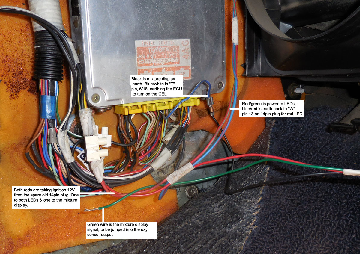

Find a permanent 12V and an ignition 12V in the wiper relay box in the passenger's kick panel. Cut those and join three wires in, to go to the ECU. They supply the two +B pins and the BATT pin, giving chassis power to the ECU.
I have the ECU mounted up behind the heater, the most common place so I assume it doesn't get cooked by the exhaust.
Now find your three wires from the COR box coming in the spare wires in the 4AGE loom and cut the correct wires to hook them into the plugs at the right pins. You'll have to cut a couple of earth wires coming out of the ECU and earth them, but not all of them as I found out! Some are actually taking power INTO the ECU, they are 'earths' in the way that the ECU earths out some sensors.

Inside here are two LEDs, one red & one green, made for putting in cars. They're a handful of bucks from Jaycar. I drilled a 5c piece to fit them side by side and filed it down to fit inside the plastic cap, which was in a packet of free samples.. It fits into the choke hole, no longer used.
I soldered the two +ves together and ran a wire to one of the unused 14pin plug wires on the ECU, one that is live on ignition. That also supplies my fuel mixture display with power. I could have used any ignition power, but the ECU was handy.
The red LED earths back down to the "W" pin on the ECU, which processes it and earths it out through pin "T", to go into "check engine light" mode. So normally it doesn't do anything unless I earth the "T" pin, and then it acts as a CEL and flashes any codes.
The green LED earths out through the "+ve" side of my electric fan manual switch, so it only actually earths out when I turn the fan on. So I have a red light as a CEL and a green light for when the electric fan is on. They're easy to see from the driver's seat.
