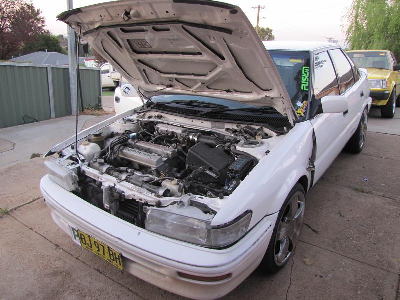

  10. bought something exciting yesterday... now just need to get the following... -ae71 crossmember and engine mounts -t50 gearbox/gearbox mounts, pedal box, M/C and lines + tailshaft -Cut and shut Intake manifold -RWD exhaust -RWD alternator/alternator bracket -Cooling system pipes, etc I'm a bit unsure about wiring a small port up. I want to use the original loom but I've heard the wiring is far to short and I'm not to confident chopping the loom up. I've also read it's easier to just make a new loom up from scratch. the ae92sx still drives and has rego, I drove it home from where I bought it. runs really good, did a compression test before I bought it, has good compression on all 4 pots. too bad the chassis is bent lol. Also got my ass kicked by the misses for buying this before paying the gas bill :o Should be stripping my interior out and removing all the sound deadening as soon as we put another 12 months rego on our daily, cause we've been using the corolla as the daily cause our other car has no rego atm.

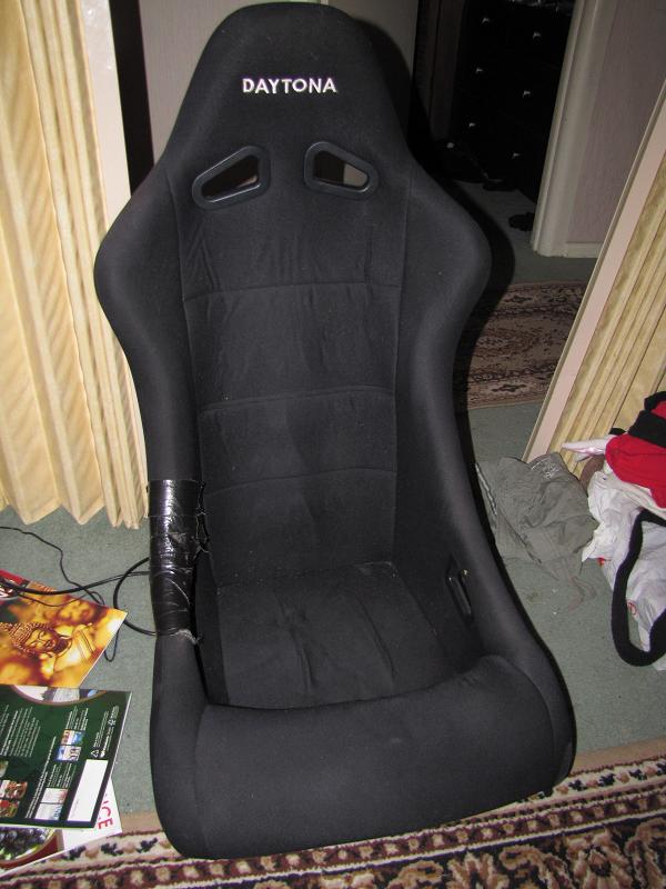

  16. Unknown brand, I've seen pics of 25mm boss kits. But can't find any. Asked around at a few shops. Apparently saas used to make a short one but no longer do. The one of my car at the moment is probably around 110mm

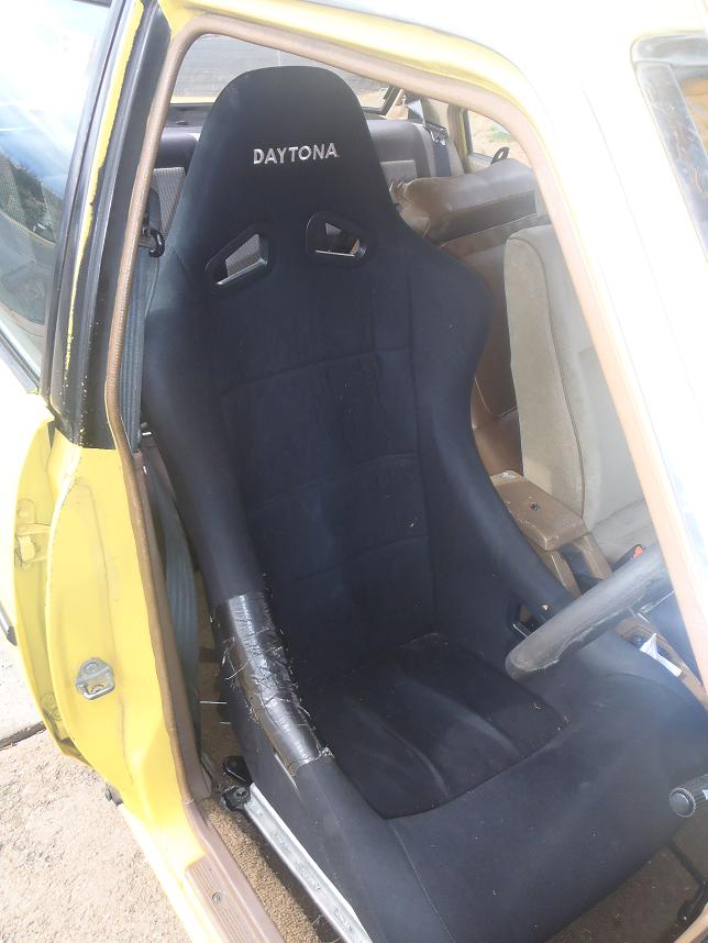

  17. Hey guys, I just fitted a fixed back seat into my car and now I find the wheel is all up in my face, not just that but I can't reach the indicator stalk with a standard boss kit. Wondering if anyone knows where I can find the shortest possible boss kit to fit a ke70 or if anyone else has had this problem and how they dealt with it? I was thinking if I can't find one short enough, might just cut a section out of my current boss kit and weld it back together... anyone done this before?

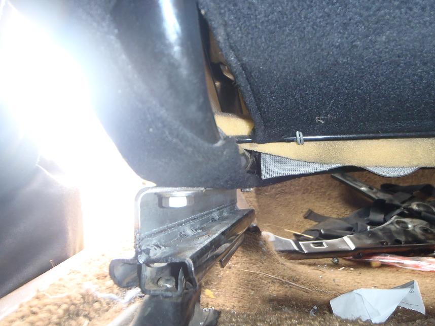

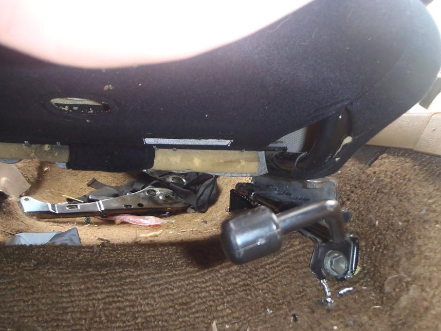

  18. Seats all in now, welded onto standard rails thanks to my Dad who is a clever man with steel. heres some pics that also show how its mounted... I need to get a shorter boss kit or something though, I'm only a short man, so I have to have the seat fairly forward to reach the pedals :P and my arms end up squashed between the wheel, not to mention the indicator switch is unreachable without taking my hand off the wheel. Anyone know of any short boss kits or wheels I could use?

  20. Nisrola, your setup looks awesome, did you modify the standard rails or just make some up from scratch for your seat? or is the seat welded into a fixed position? My plan was to weld two plates across the standard rails and drill holes in the plates where the bolt holes would match up to the seat then just bolt it in. Snot, I'd be scared running the belt at to much of an angle, I've read it can actually compress your spine in an accident or even snap the seat and at the same time snap your spinal cord. Rob 5000, would that be because they lack that external oil drain from the head to the sump? Ive been seriously thinking about the SR20de option...seems like a better option for track work and probably more cost effective. Getting turned off 4age for a few reasons- people seem to be asking alot for anything related to doing a 4age conversion, i see $200+ for pedal boxes $350+ for t50s, $150+ for ae71 crossmembers, and $600+ for a motor that'll probably need a rebuild anyhow. then all the little things you need, like all the parts to setup the water system and fuel system and chances are I'll have to pay for it to get wired up cause from what Ive heard they're a bit of a nightmare to wire up and after all that the power isn't all that impressive anyhow. Ive just got to compare prices and convenience Custom mounts to suite sr20 vs ae71 crossmember + 4a mounts t50 gearbox vs rb20/30 gearbox with sr20 bellhousing (or run the silvia box with the shifter in an odd position) ae71 tailshaft vs custom tailshaft sr20de power, price and reliability vs 4age power, price and reliability There is alot of hidden costs in both conversions though. Either way I can't see myself having either in the car for atleast another 6months to a year unless I get some mad cash flow happening somehow :P
