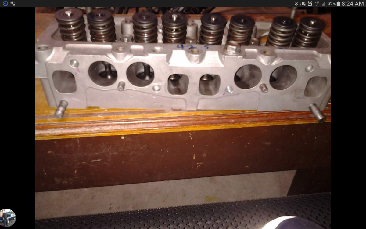

7000rpm Posted July 24, 2016 Report Share Posted July 24, 2016 http://www.rollaclub.com/board/index.php?app=core&module=attach§ion=attach&attach_rel_module=msg&attach_id=117111 This is the head I plan on using. Wanting to run 11.5:1 comp. Gavin can i ask what carbs you are using and if you have any dyno results? Quote Link to comment Share on other sites More sharing options...

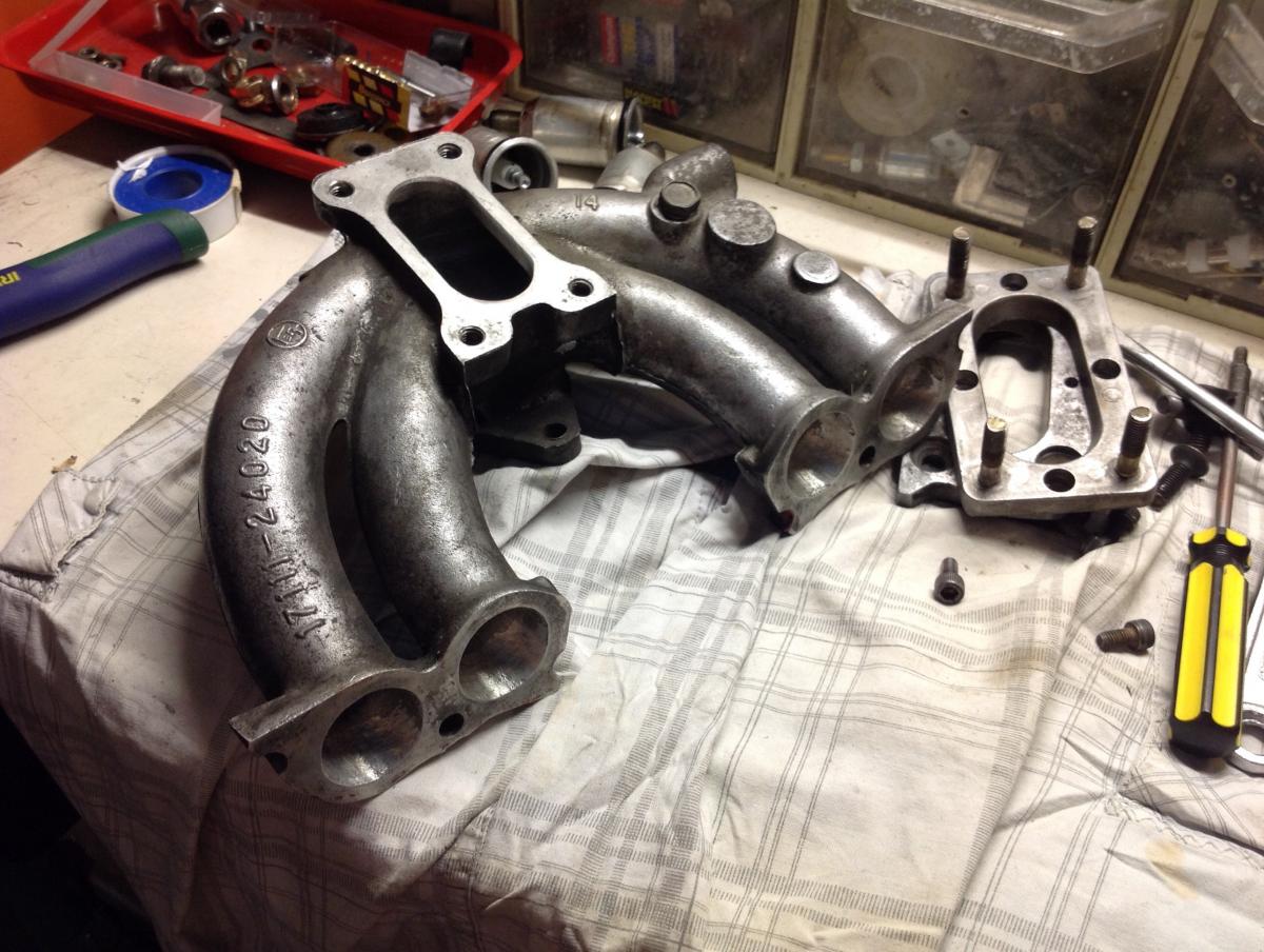

GJM85 Posted July 25, 2016 Report Share Posted July 25, 2016 (edited) I'm using a 32/36 DGV Weber on an early modified manifold. Never had it dyno'd but it's faster than a Mirage and a twin cam excel. Seat of my pants says its around 80-90hp. Edited July 25, 2016 by GJM85 Quote Link to comment Share on other sites More sharing options...
7000rpm Posted July 25, 2016 Report Share Posted July 25, 2016 Cool. Nice work on that manifold too Quote Link to comment Share on other sites More sharing options...
