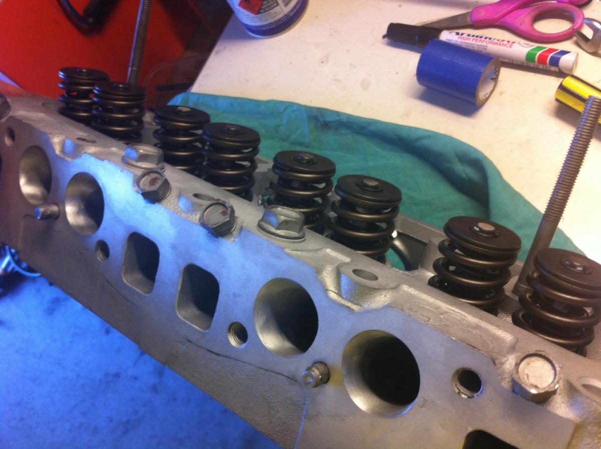

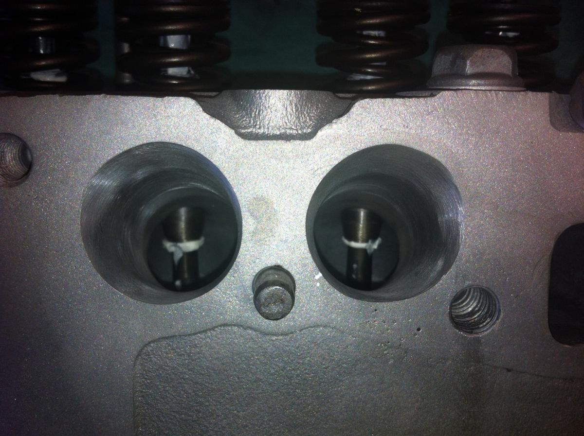

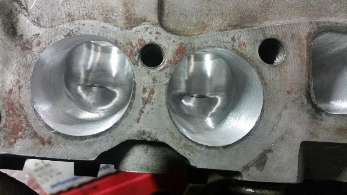

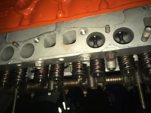

Here is photos off my head ported
Nice work.

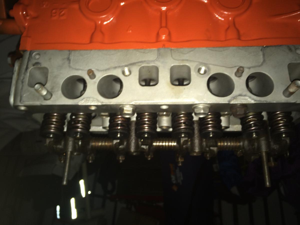

I am currently rebuilding mine for track use, using a ported 3k head. Has been ported to approx 33mm inlets
How much compression are you looking at running?
Edited by Had_ke30

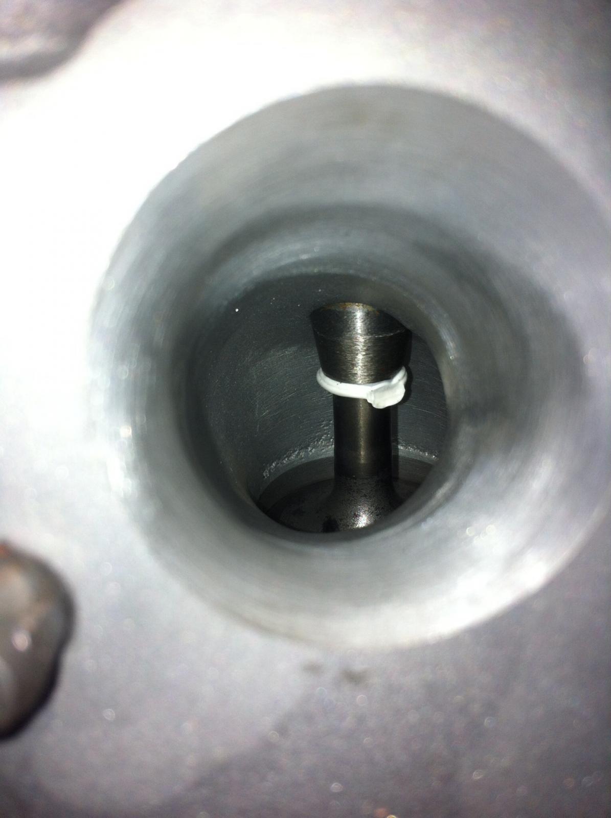

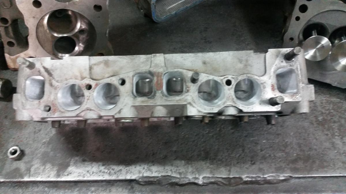

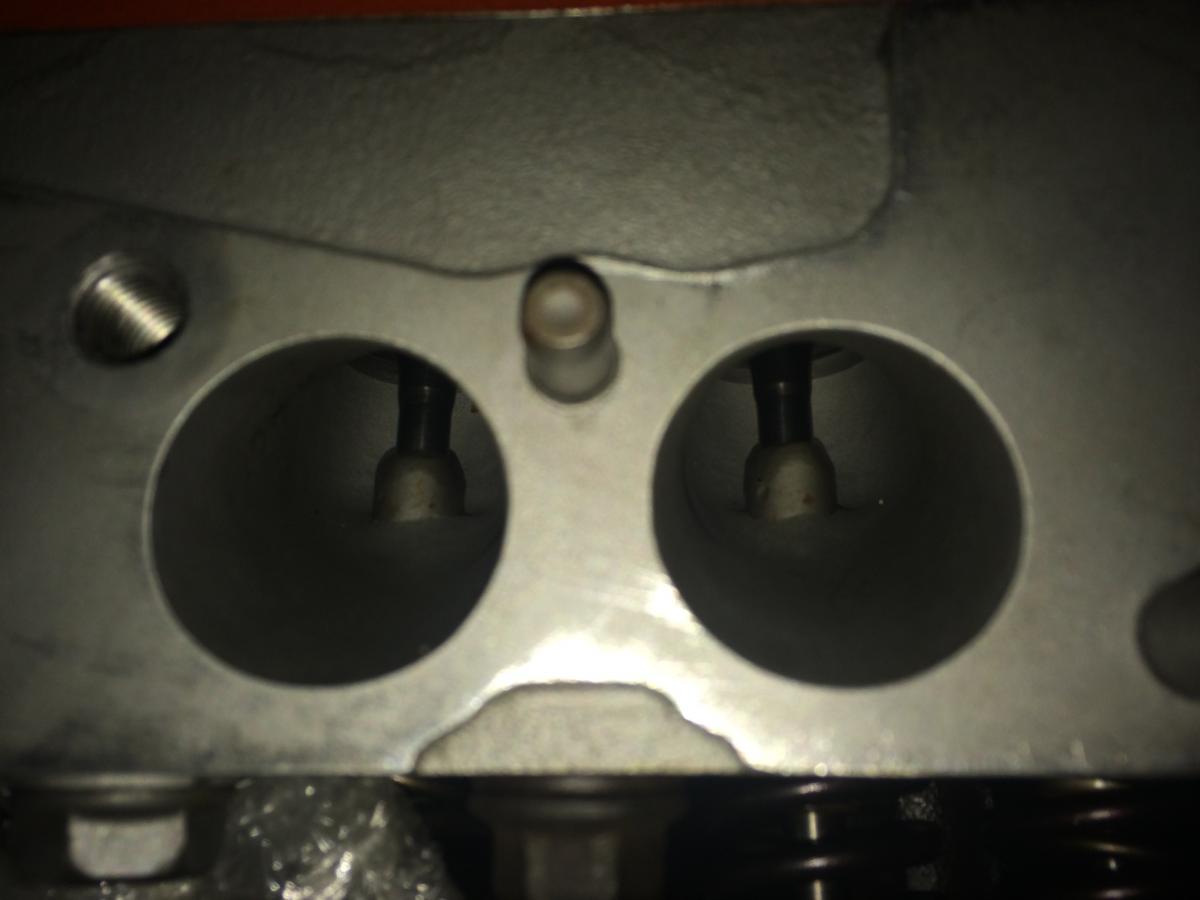

The inlet ports on my head are 35mm
This head is goin on a 5k with flat tops
It will have 10.2.1 comp
Cost me $450 to get ported
Only got to get new valve guides fitted and seats cut and new valves and then faced so be about $1000 when finished

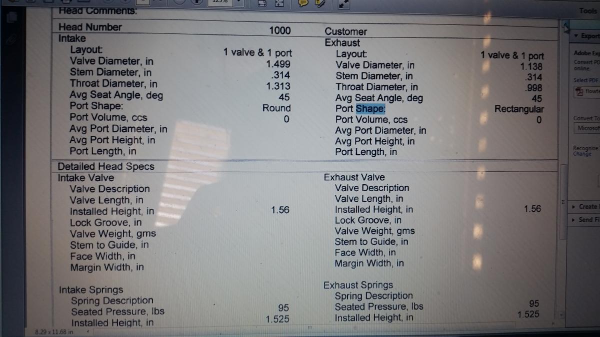

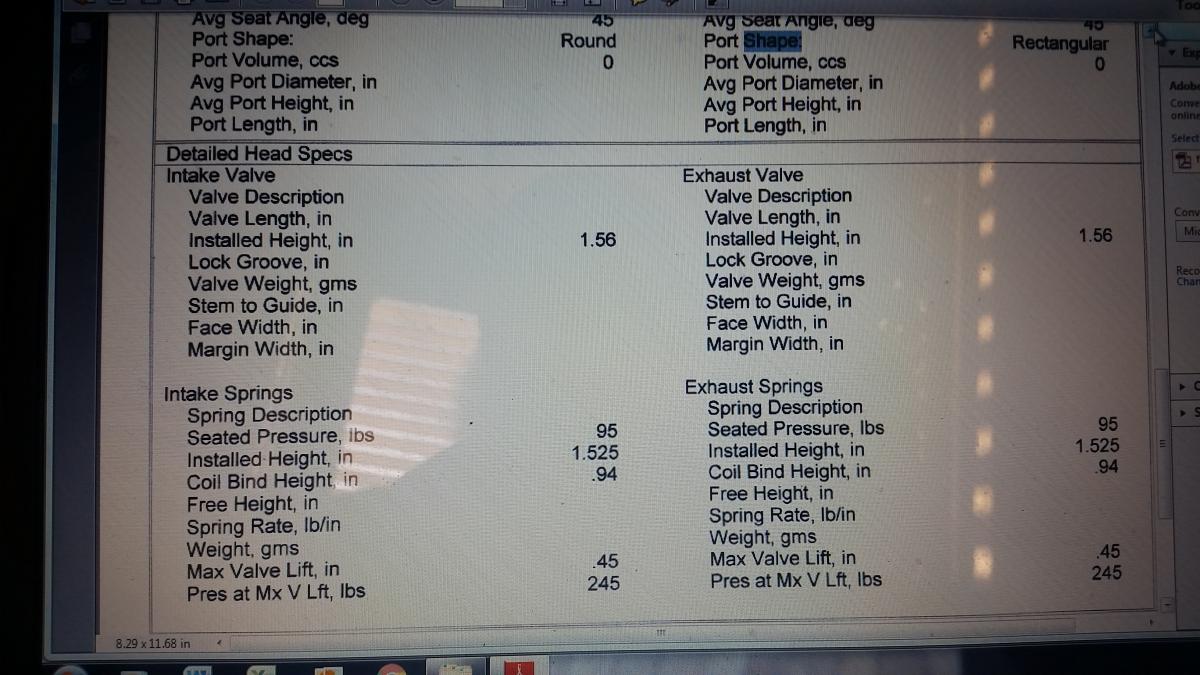

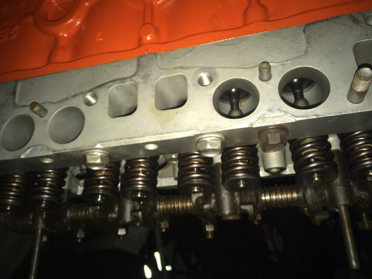

Have a read of Thomas thread ! I ported the head for him , to get the most out of your port job make sure you put bigger valves in and cam to suit as well as carburation / exhaust and the list goes on ???? . Thomas head has double valve springs at around 105 pound on the seat which once warmed up should be around 95/100 on the seat , compression ratio is just under 12-1
Valve size I can't remember. I bought the head already built and then sunk a heap of more money into it. Will chase emails and measure for you. I remember they were at least 1mm o/s

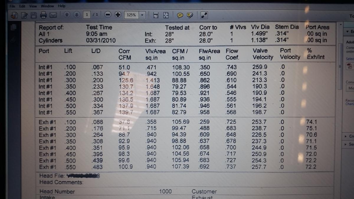

anyone test their work on a flowbench?? unfortunately my bench was not available when I did my K porting....
Is the 35mm inlet diameter at the entrance or all the way through?
