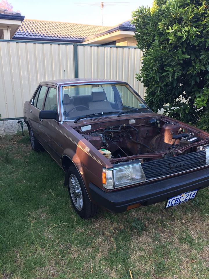

Hey everyone, I've been lurking for sometime and finally decided to make an account now that I actually own a KE70. I bought this wonderful poo brown slant front off a friend for $500. It's not pretty, nor does it have an engine or much else going for it but I'm going to get it running and then daily drive it. Plans are to build it into a decent little 4K for now. Originally I had planned for a 7K but at the moment I'm going to modify the 4K.

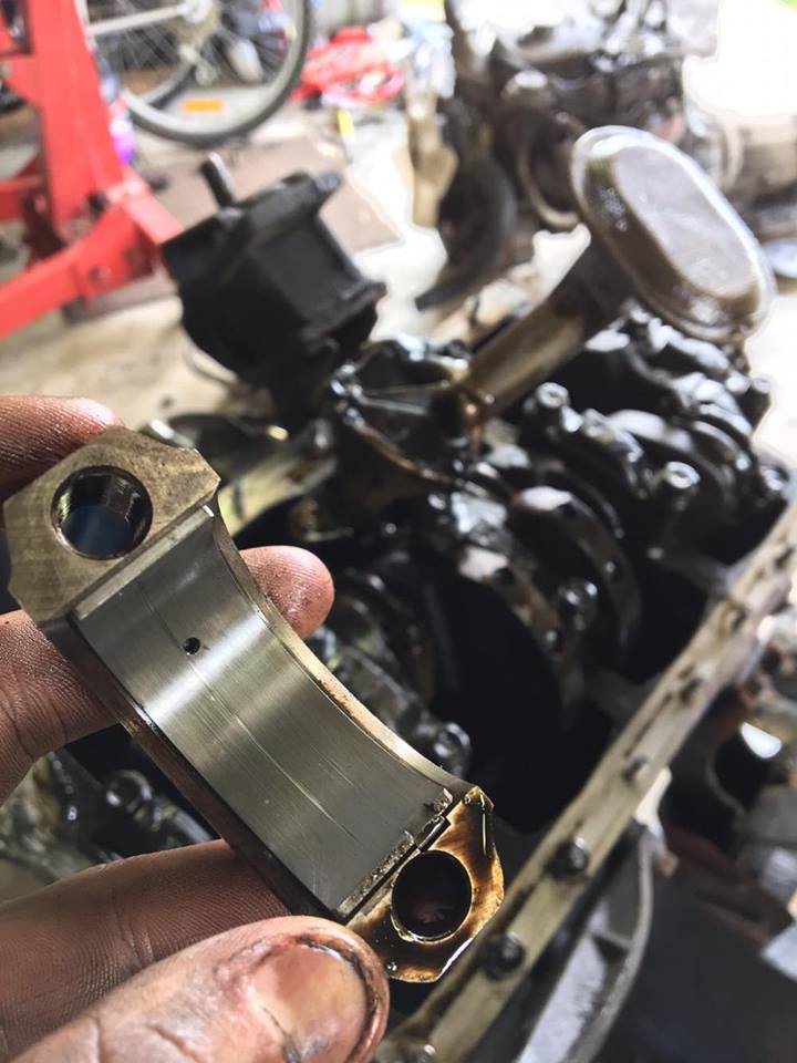

This is the journey so far; Got it, got a set of wheels for it, pulled some engines apart and decided to replace whatever I think I should to make one decent runner out of a few, new clutch and new head. I'll update the thread whenever I get something new or do something. Cheers.

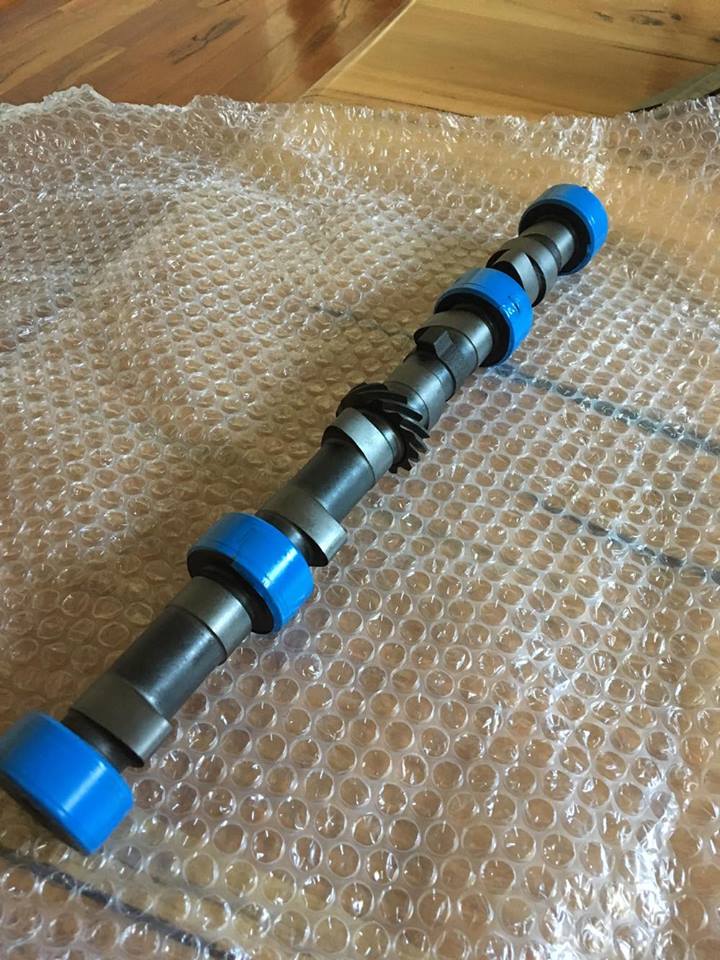

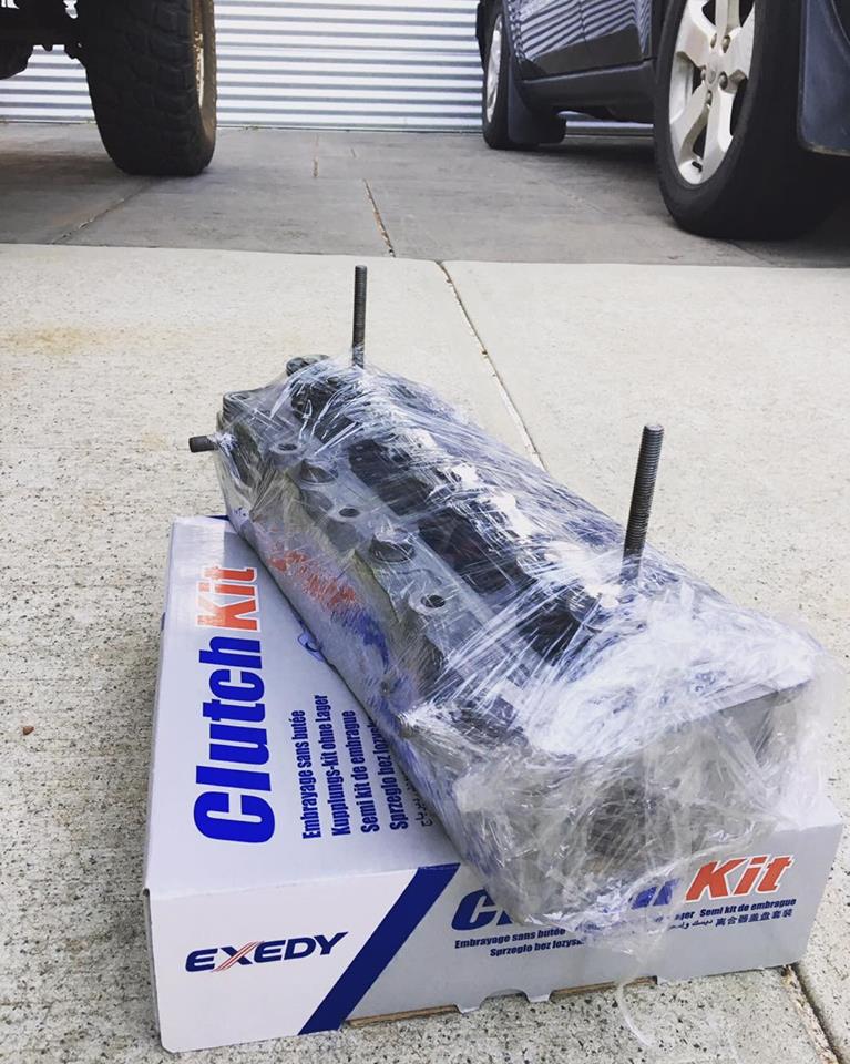

Have been quiet for a while and haven't made too much build progress but I've been gathering various goodies. At the moment the head is in the machine shop getting skimmed, going for a 10:1 compression ratio with dual valve springs this will suit the cam which I got done by, Tighe, got a 280/280 duration.I feel like this will do well for a street application. Will probably look into a port and 3 angle valve job depending how responsive it will be with the 3k dual carb intake and two 7k carbs. If anyone has any info on running a setup like this and any additional head work they've done that would be most welcome.

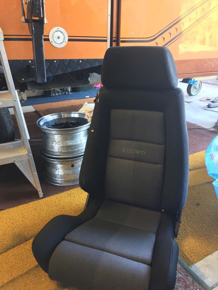

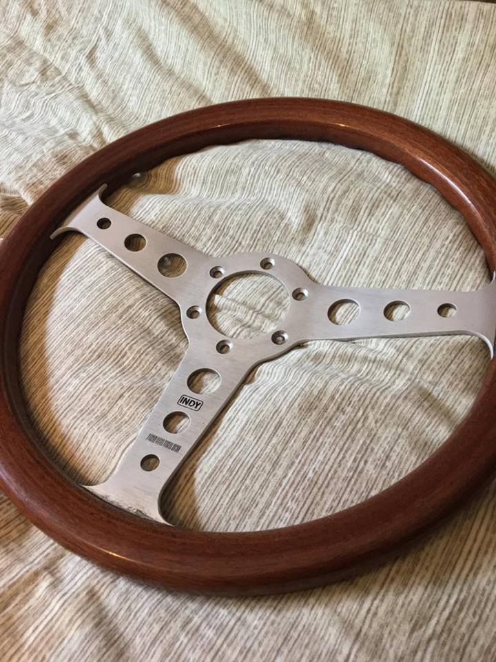

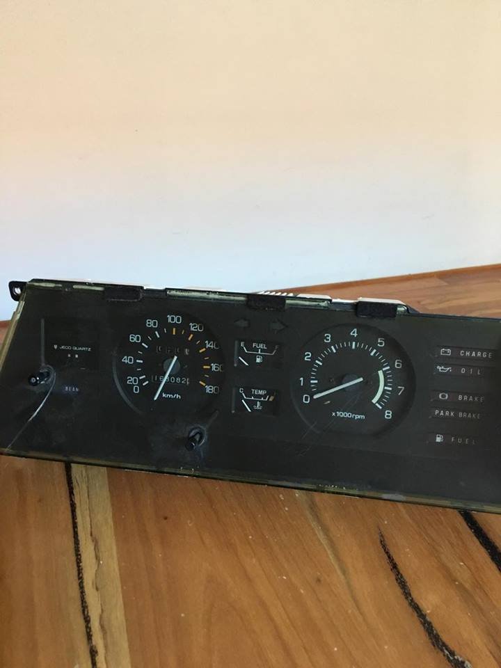

Purchased a tacho speedo from a lovely memeber. YJPN also opened a wide range of various things, I got a Recaro LS and a MOMO Indy wood, I was on the lookout for a period correct seat and wheel combination for a while. That's the goal with most of this, as period correct as possible. Thanks for reading.

Are you going to port the head?
What valve lift is the cam?

I was thinking about a port job, I'm unsure yet. It depends on what sort of gains I'll get out of it. As for the 7K carbs I was worried they'd be too much for the little 4K. What do you think it regards to jetting options etc
Valve lift at TDC is .040" and .053"

If you are using the 4k head, the ports are really small. If you use the 3k big port head, they are more ideal.
Either way, Id be porting both or at least having 3k BP size.
Its not the jetting, its the overall carb throat sizes that are likely to be restrictive. I would run a single 40mm sidedraght weber, or quad bike carbies if you want more upright carbs. If you want to maintain the downdrafts, maybe a pair of 34ICH webers?

The cam you have is fairly aggressive (good) so to get the gains throughout the rev range, this is necessary.

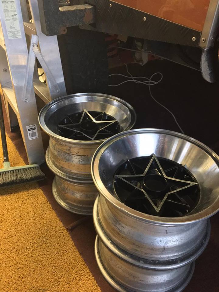

Awesome work mate, loving the wheels too 👍
Also with the recaro are you planning on getting recaro 86 rails and modding or just gonna make custom ones? I'm still tossing up for mine haha
Cheers mate, I was on the look out for them for ages. When I ordered the Recaro I also ordered a seat rail for it from the same place. But they're custom made. A bit pricey but I think it's worth it.
