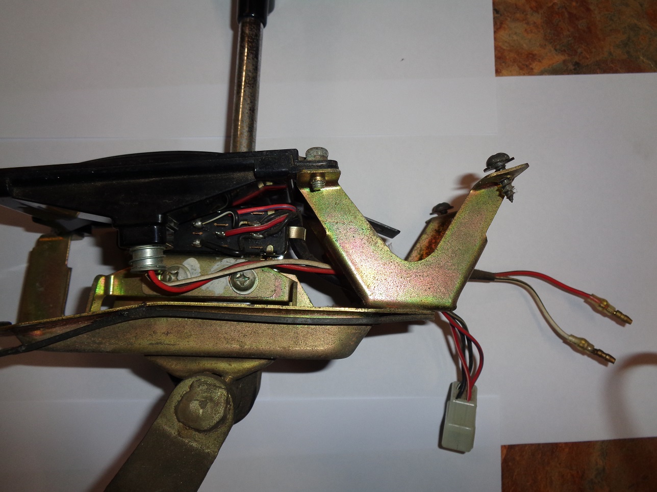

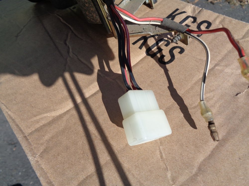

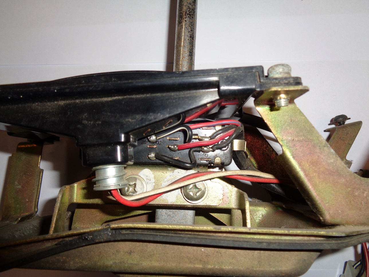

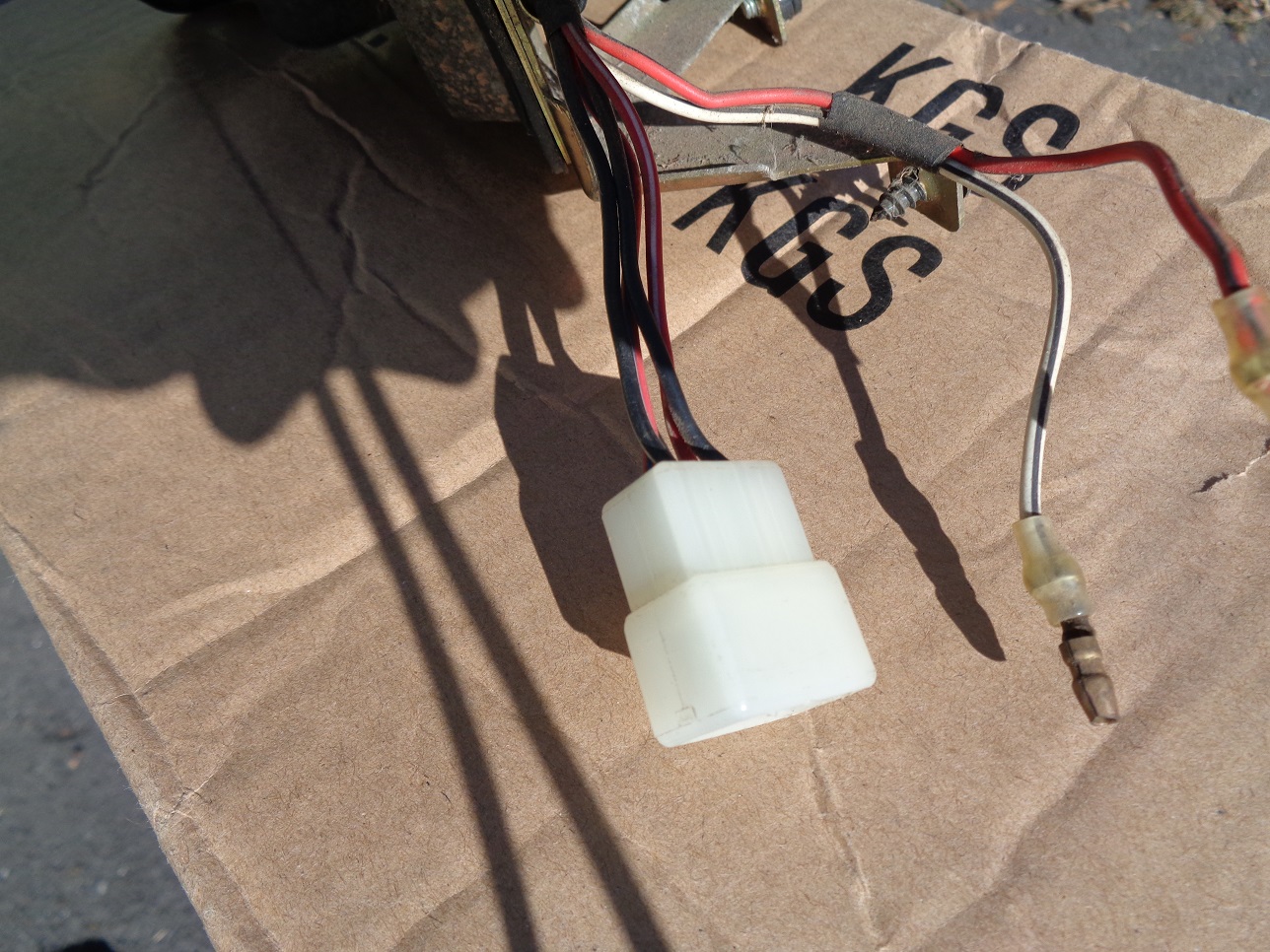

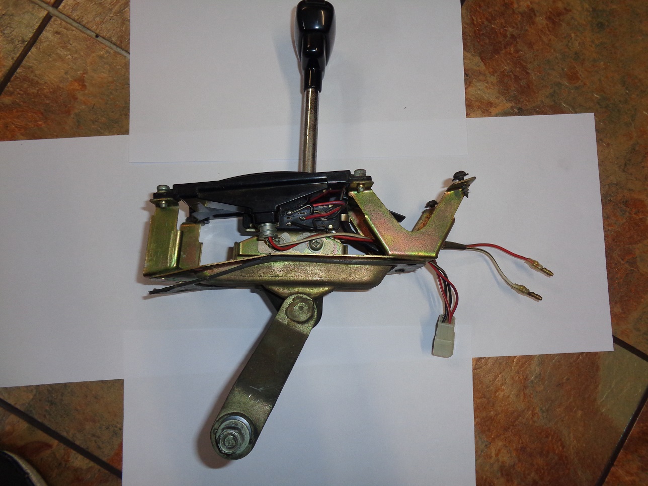

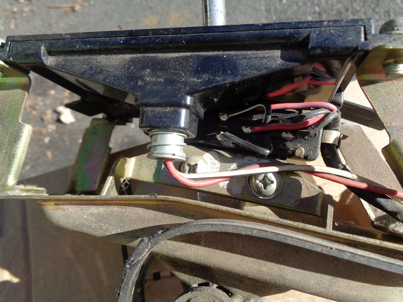

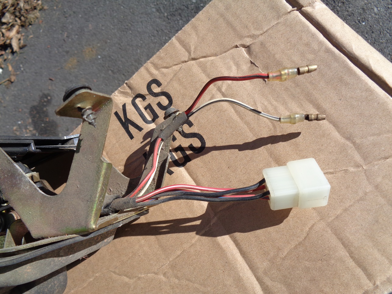

Banjo Posted April 28, 2018 Report Share Posted April 28, 2018 (edited) Hi Hayden, I went & checked this morning, to make sure I'm not advising you some untruths. I still had my olde auto shifter in the garage, complete with the lead & plug. I buzzed out the connections & confirmed the following. Assuming Toyota kept the same wiring colour codes in your particular model Rolla, the white socket is a 4 way. 1. There are two wires that are red. One is red with a white stripe, & the other a red wire with a blue stripe. These two wires close a switch, when the auto changer is placed in "Reverse". These two corresponding wires in your loom under the dash, just to the RHS of the console, should be connected to the reversing switch in the manual gearbox. 2. There are two wires that are black. One is black with a white stripe, & the other is just fully black. These two wires close a switch, when the auto changer is in "Neutral", which allows the car to be started. These two corresponding wires in your loom under the dash, should be shorted together. This should solve your problems. Let us know how you go. There are two other "single" wires coming out from the auto changer in these pics above. One is red with a black stripe, & the other a white with a black stripe. Theses are purely for powering the light behind the auto changer, when driving at night. The corresponding ones under the dash, are basically the same circuit as your dash lights. You will not need to use these. I know they are "sockets", under the dash, but just tape them up, so they don't short against chassis anywhere. Cheers Banjo Edited April 29, 2018 by Banjo 1 Quote Link to comment Share on other sites More sharing options...

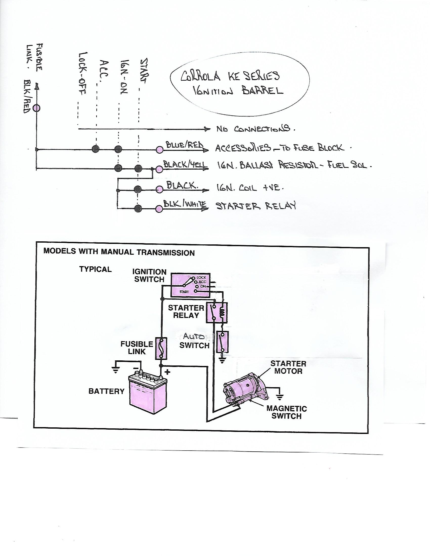

Banjo Posted April 30, 2018 Report Share Posted April 30, 2018 (edited) Hi Hayden, Have you got the engine cranking over, now that you've shorted out the wires that originally went to the "Neutral" interlock switch, when the Rolla had an auto gearbox in it ? Here is the very basic setup for the starter motor. Yours and most other cars from this era were wired up like this. The only difference with your wiring, is that the auto neutral interlock switch, is depicted on the other side of the relay coil, in circuit above. I'm assuming your ignition barrel / switch is OK. I've yet to find a car manual wiring diagram, that can depict the ignition switch adequately, which indicates how it works. Lots of guys & gals get frustrated when trying to work it out. Frankly, the wiring diagrams in the back of most auto manuals are pathetic, & very hard to follow. The little black dots in the table above, indicate which outputs are connected, when the switch is in each of its four (4) positions. In the "Lock" or OFF position, there are no connections at all through the ignition switch. There is one supply wire to the ignition switch in our Rollas, which comes directly from the battery, via the "fusible link", which is usually very close to the battery itself. In my Rolla this wire is a black wire with a red stripe Black/Red. There are four (4) output wires. In the Accessory position, the Blue/Red wire is powered. This wire usually goes off to the fuse block to power accessories like radios etc. In some models, it also powers the cigarette lighter. In the Ignition position, the Black/Yellow wire is powered, as well as the Accessory wire above. The Black/Yellow wire is connected to the end of the ballast resistor, not connected to the +ve terminal of the coil. It also goes across to the other side of the engine bay to power the fuel solenoid, built into some Aisin carbies. In the Start position, all sorts of things happen. The accessories are turned off, so there are no additional loads on the battery, so all its available power can be provided to starting the engine. The Back/White wire provides power to the starter relay, which in turn provides power to the starter motor solenoid. The Black wire provides battery voltage directly to the +ve terminal of the ignition coil, effectively short circuiting the ballast resistor. This assists in starting the car, when battery volts are low, during starting on a cold morning. Despite what the guy told you, it appears from the symptoms that your car is not wired up correctly. Assuming the ignition coil that is fitted, has the correct "primary resistance" (about 3 ohms), so it can be used without a ballast resistor, you need to find the Black/Yellow wire that was originally connected to the "ballast" resistor, & then connect it to the +ve terminal of the coil. If the harness is unmolested, it should be close to the existing coil, if it is in the standard location. If you can't find it, & the carby has a fuel solenoid on it, with an electrical wire running to the carby, you could run a wire from the carby temporarily,, to the +ve terminal of the coil, & see if that solves your issue. Good luck, & let us know how you go. Cheers Banjo Edited April 30, 2018 by Banjo Quote Link to comment Share on other sites More sharing options...
Hayden.96 Posted April 30, 2018 Author Report Share Posted April 30, 2018 Thanks banjo , all i could fine is the black single wire that goes to the ballast resistor well thats where it seems to go in pictures so I'm going to try and put that on to the positive side of the coil, and the carby doesnt have an wires its a 3k, so is that the only thing that it could be? And also the ignition barrel is seized but the ignition switch works fine so i can still start it and what not Quote Link to comment Share on other sites More sharing options...
Banjo Posted April 30, 2018 Report Share Posted April 30, 2018 (edited) Hi Hayden, Squirt some WD40 into the ignition barrel. They are a bugga to change, although it can be done. There are two conical bolts underneath, that break off when they were originally fitted, so you have to grind or cut a slot in in the "cones", so you can remove with a large screwdriver. Lets know how you go with the black wire on the +ve terminal of the ignition coil. Good luck ! P.S. Just off interest, can you list the wire colours of the five (5) wires on the back end of the ignition switch itself. I want to know if Toyota kept the same colours, in every model. Cheers Banjo. Edited April 30, 2018 by Banjo Quote Link to comment Share on other sites More sharing options...
Hayden.96 Posted May 1, 2018 Author Report Share Posted May 1, 2018 Ill try it now , and the wires are the same colours so they must of kept them the same thanks mate Quote Link to comment Share on other sites More sharing options...
