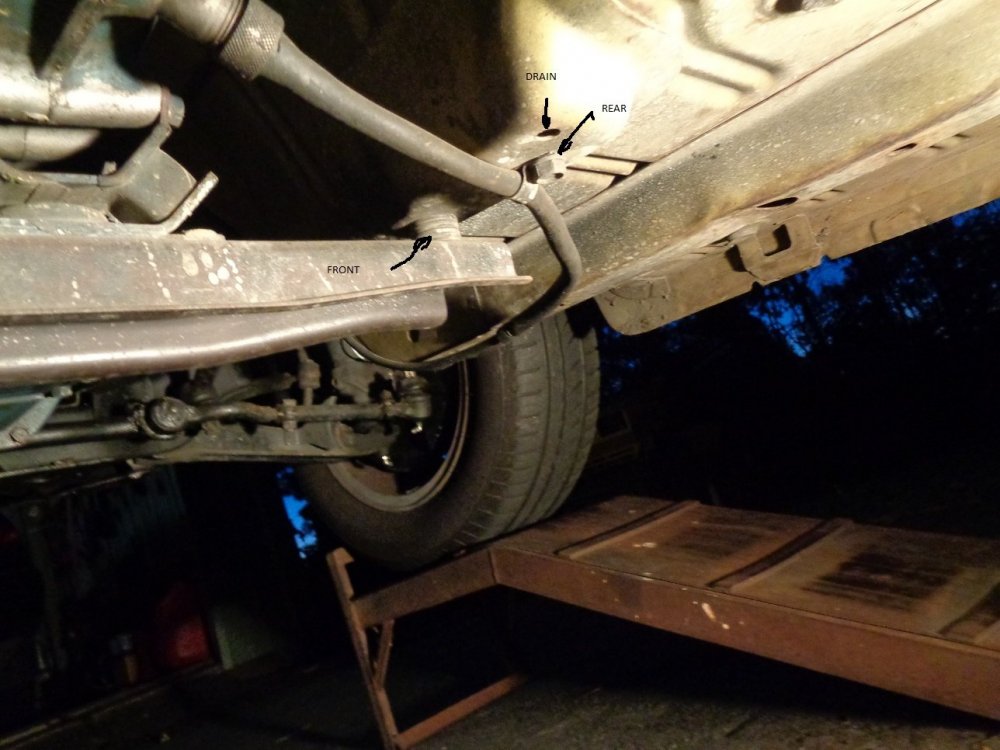

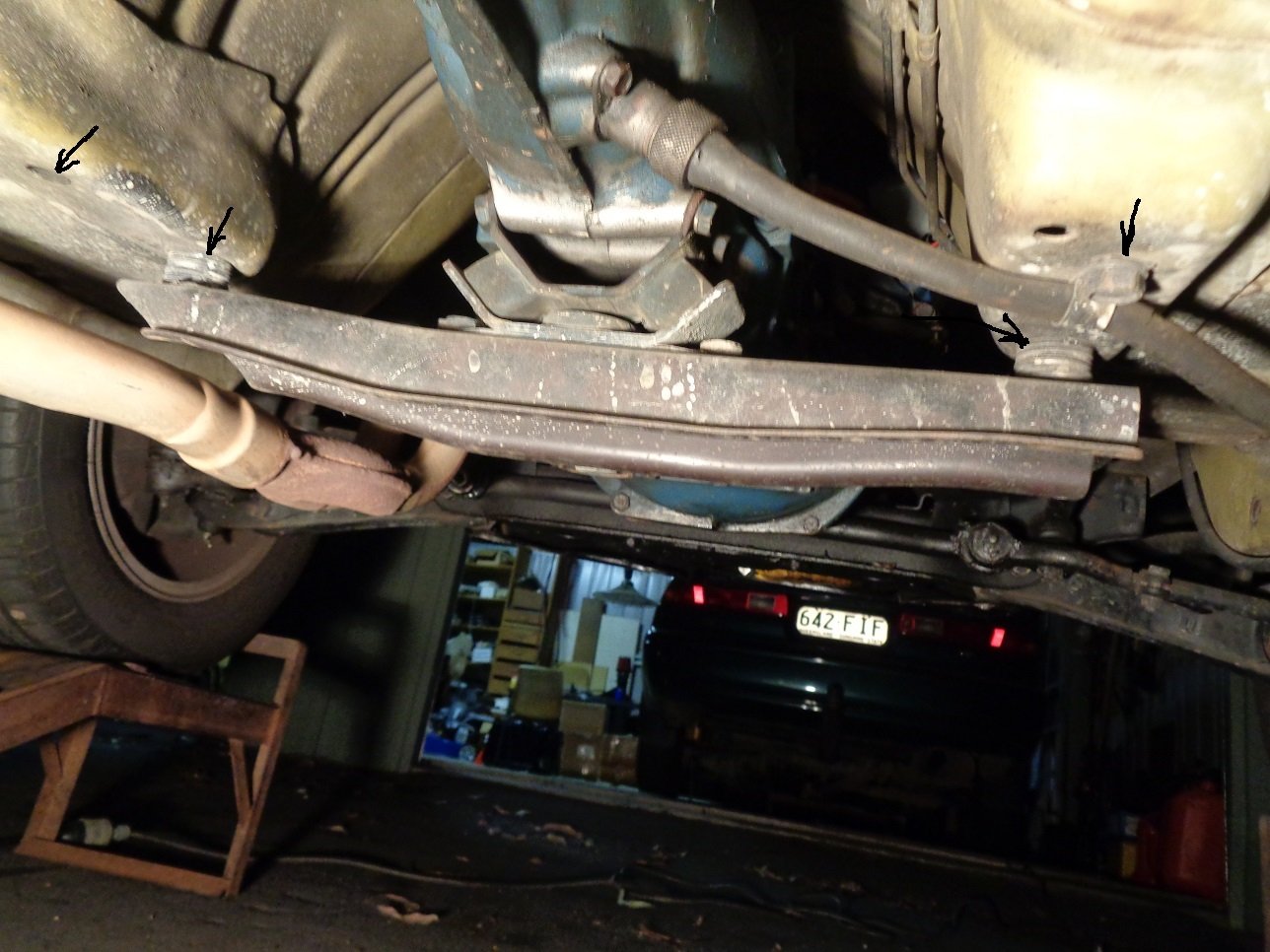

Ye ists a 4k motor and I’ve put in a 4sp maunual . It was pretty straight forward up to this . I have the auto crossmember and the manual one . It seems either the crossmember in the mount on the gearbox is 150mm out . I,be taken pictures quickly but probably ain’t great . Hopefully you can make them out

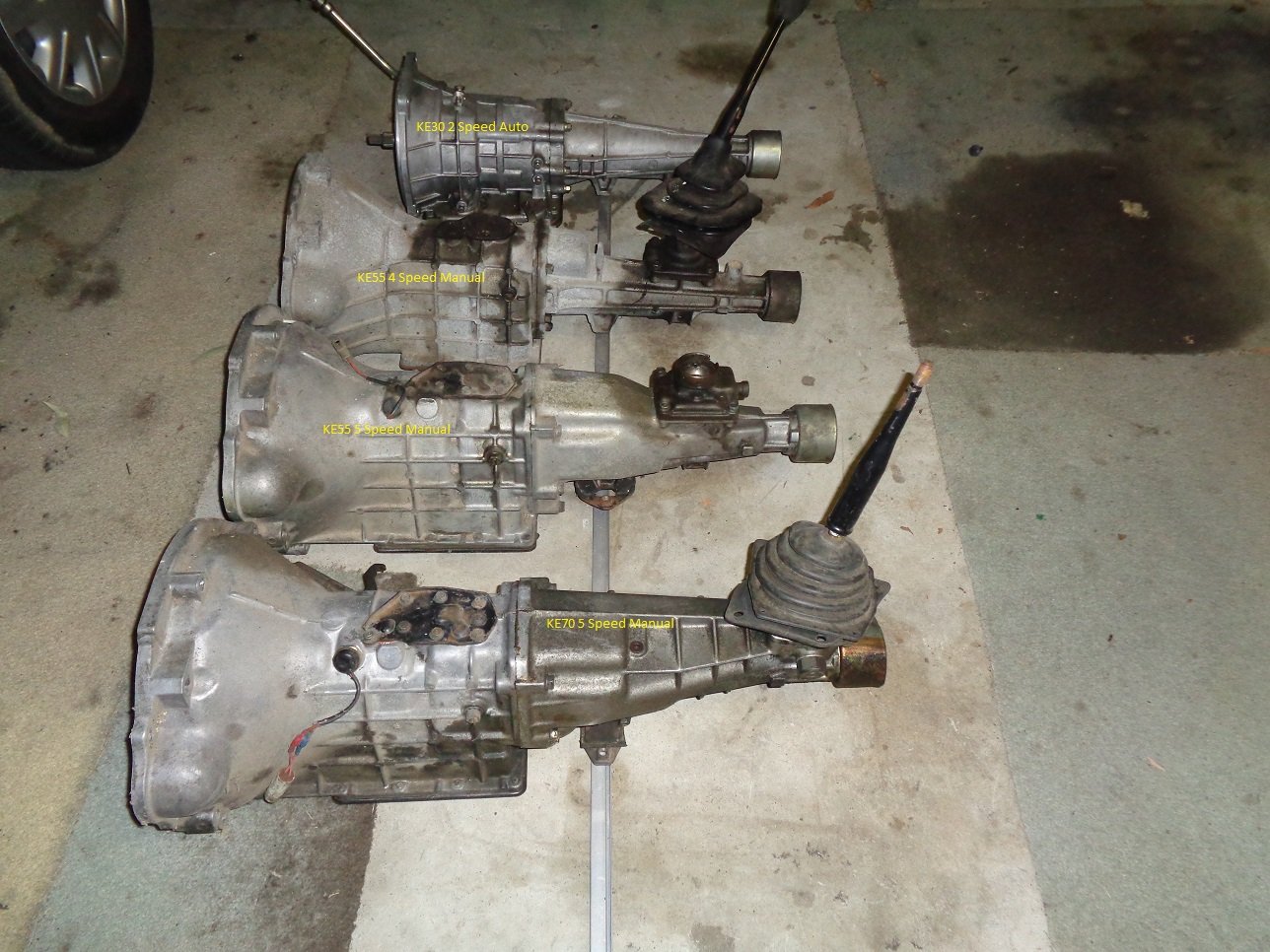

I'll pull all the gearboxes out tomorrow, & measure them more accurately.  I'll also take a pic, of my KE30 floor pan dual mounting points for the rear gearbox mount cross member.

                    I pulled my gearboxes out of a heap today & lined them all up.
They are all the exact same length from the front edge of the bell housing flange, to the rear universal protector end.  The 2 Speed auto bell housing is removable, & I have removed it for a rear engine mount on my engine test bed. That's why it looks a bit shorter.
Underneath the gearboxes, is a strip of aluminium on the floor, which lines up with centre of the rear gearbox mounting point, in all cases.
I know when I took out my 2 speed original auto box, & fitted the KE70 5 speed manual, I used the same tail shaft & the same mounting points.
So can't work out why yours is so far (15cm) out.
However, my  KE30 rear mounting points in the floor pan are different to your pic.  you have two holes either side which are close together, & both used. My has two holes further apart, but only one used.  This allows the cross member to have two mounting points if necessary.
Cheers Banjo
