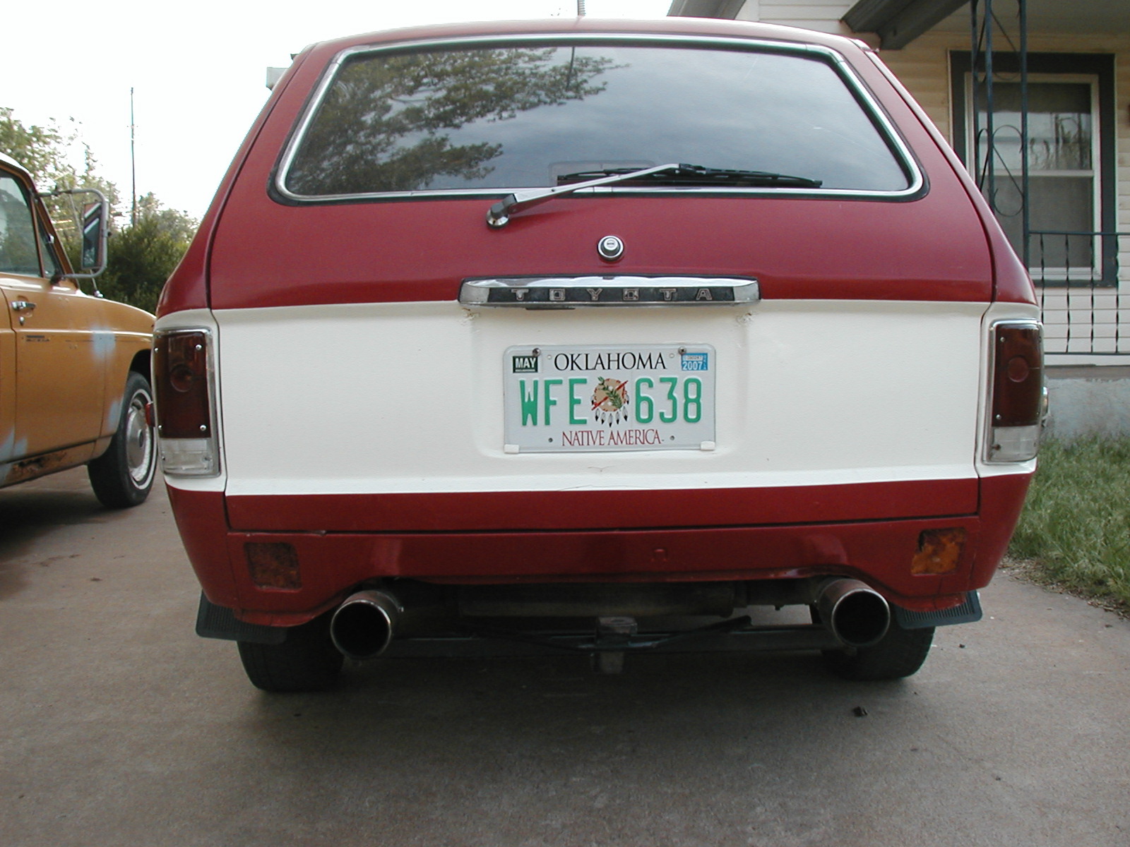

the right side lens i bought off ebay was REALLY faded, chipped, scratched, and just sun eaten.
scott's was nice except the clear lens, but i had a nos one anyway

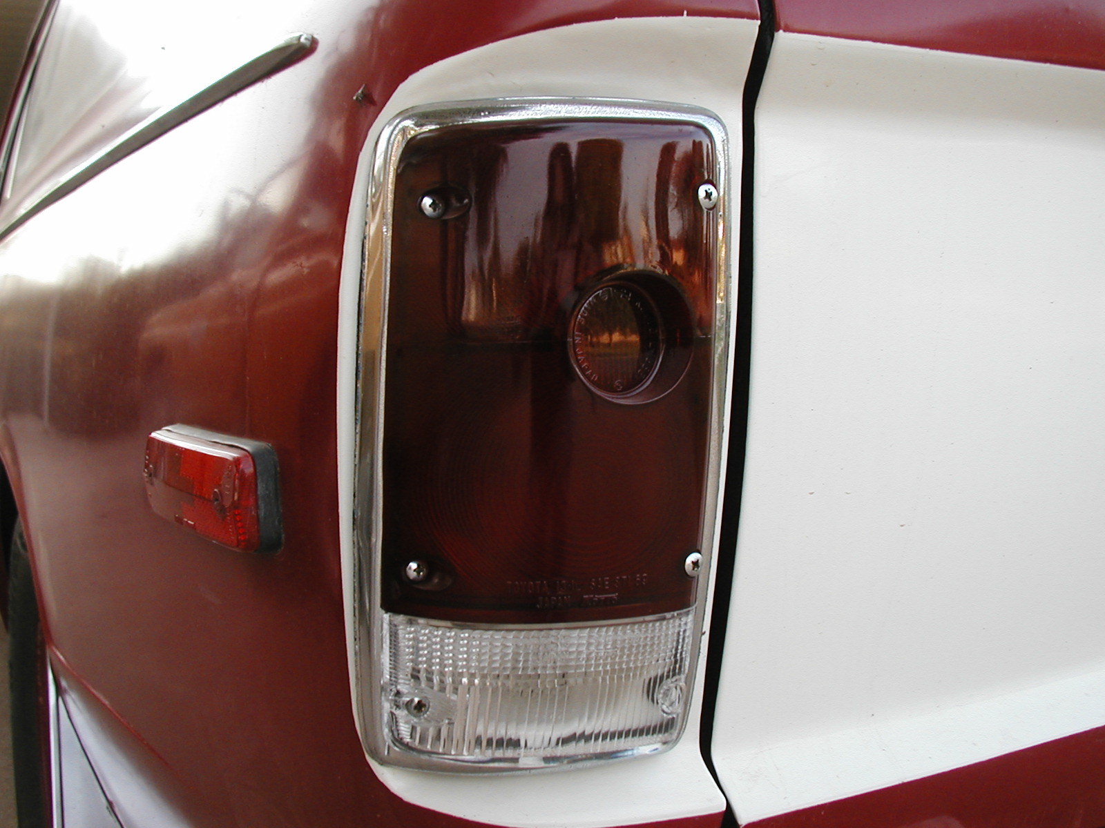

just clean the lens and scuff it with 800 grit wet/dry, then spray
i didn't use a clear primer, and i don't know if it will fade, but it has a guarantee...

tailight is a little dark during the day, but i think it would be anyway...
don't know about black, i have used gloss black paint REALLY thin
left one is the wiener
