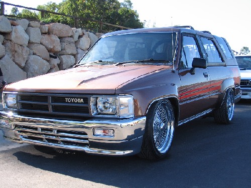

thanks man, I'm gonna do a body swap, my mate wants a turbo deisel hilux so hes gonna buy a surf & I'm gonna buy hilux 2wd and where gonna swap bodies :thumbsup:
Your mate will end up needing an extra cab tub rather than single cab unless you are planning on lengthning his chassis. As for you, you will need to cut about 280mm out of your 2wd chassis. You'll also need to swap the six tray mounts and body mounts over from each chassis. Your fuel tank is another issue as the std 2wd tank won't fit under the runner body. Needs to be speced down and then your tank will hang past your chassis rails.
That's not as bad as i was ecpecting & the fuel tank is not an issue because I'm going to be running dedicated LPG, i gotta get some work but when i do, methinks I'm gonna need some of your advice :jealous:
