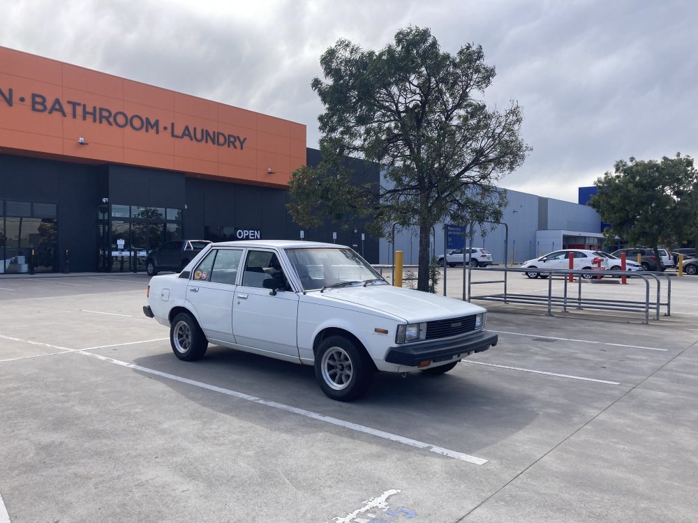

Jentriken Posted September 7, 2023 Report Share Posted September 7, 2023 Hi all, I’m hoping someone on here can help me try and get my ke70 driving properly it’s a stock 4kc with 32/36 Weber and extractors running a returnless mechanical fuel pump. I’ve finally got it running and it seems to hold idle well but it has crazy rev hang. As well as this it is lurching and spluttering under load when around 2-3.5k rpms. I know basically nothing about carbys, coming from fuel injection. I know carbys have multiple circuits for idle, partial throttle and full right? In which case would it be the partial throttle that needs adjustment as it’s smooth at higher revs? Quote Link to comment Share on other sites More sharing options...
