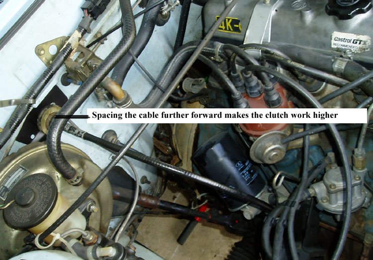

If it happened suddenly, then the most common cause is the little "C" clips that are used to adjust the clutch free play, on the firewall, (where the clutch cable comes through), have broken.  Very common problem !  Used to happen to me regularly, until I got sick of it, & modified the arrangement.
Inspect the "C" clips & come back, & let us know what You find. Take a photo & post it here, if possible.
Can be solved without converting to a hydraulic arrangement, which is a complicated procedure.
If You do find the "C" clips have broken, then remove the clutch cable & sheath from the car.  Check whether the inner cable moves freely in the outer sheath. If it tight, then place clutch outer cable end in a vice, & let it hang. Then add light oild to the little gap between inner & outer, & jiggle the inner cable up & down, until it's totally free. Sometimes, if it is really bad, You'll have to let the oil seap, down the inside over night. I've sat there doing it for 45 mins until it eventually came free.
Let's know, if my guess is right, & we'll go from there.
Cheers Banjo
The 'C' clips also chop the alloy stops out of the cable, the bits that hold the 'C' clip in a  groove.  The answer is to pack a spacer or a few washers against the firewall to push the cable out as far as you want it, usually by pulling on the outer cable. Then to keep it there screw a hose clamp hard up against the 'C' clip so it can't jump forward. As the inner cable stretches over the years you need more spacers, I had about 8mm behind mine.

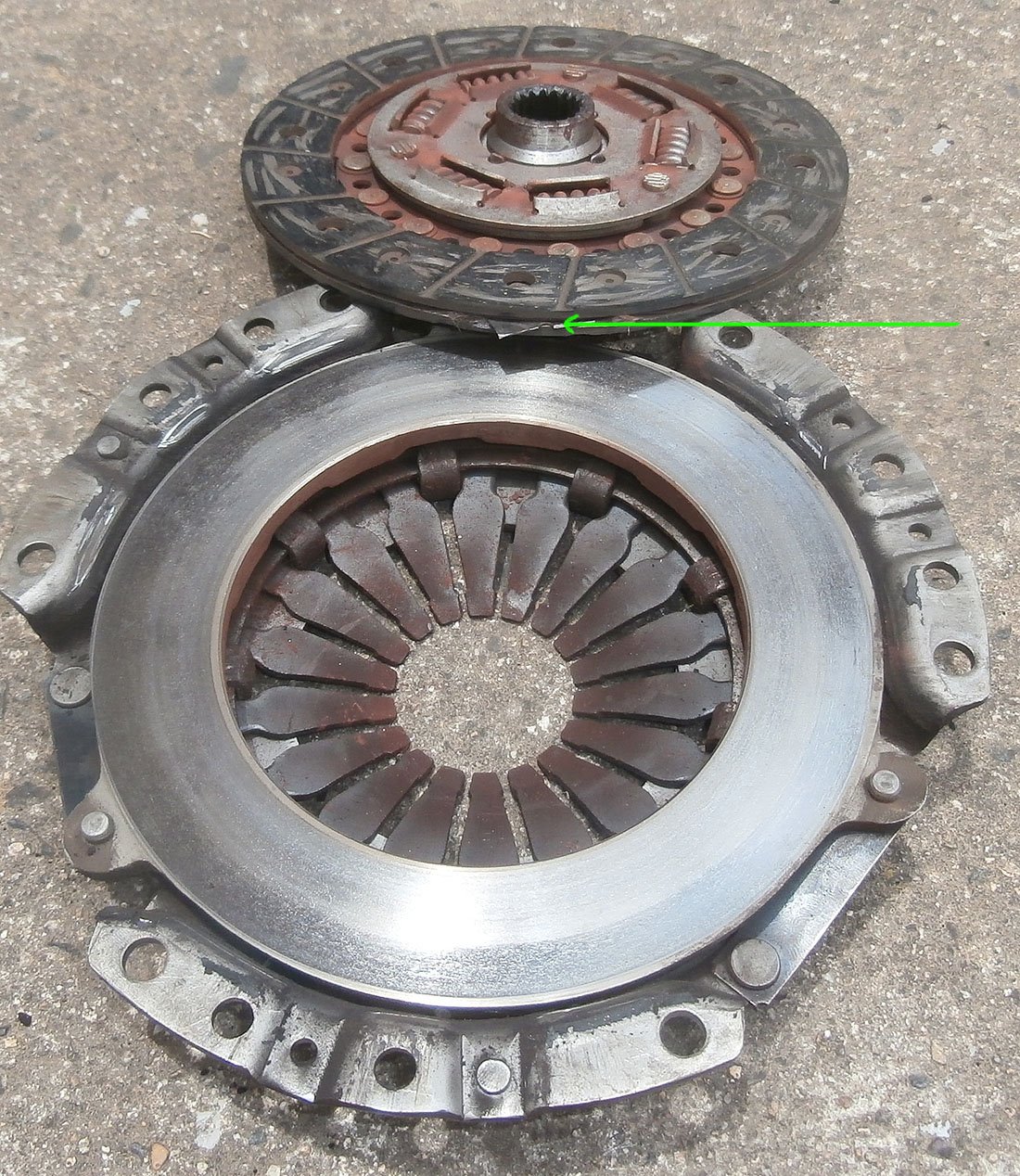

Another odd one was a finger in the clutch plate breaking and jamming behind the next finger around. That was only a few years old, hardly worn at all, but the only answer was a complete new kit.

If it does, then its gearbox out time as the problem is in the clutch itself. That clutch plate with the broken finger was like that, or if I was in a gear it shuddered badly when the clutch took up.

Sounds like a clutch plate or pressure plate problem. Even something simple like rust on the gearbox input shaft can cause the clutch to drag, or if the shaft is dry and dirty so the plate can't move a mm or two.
