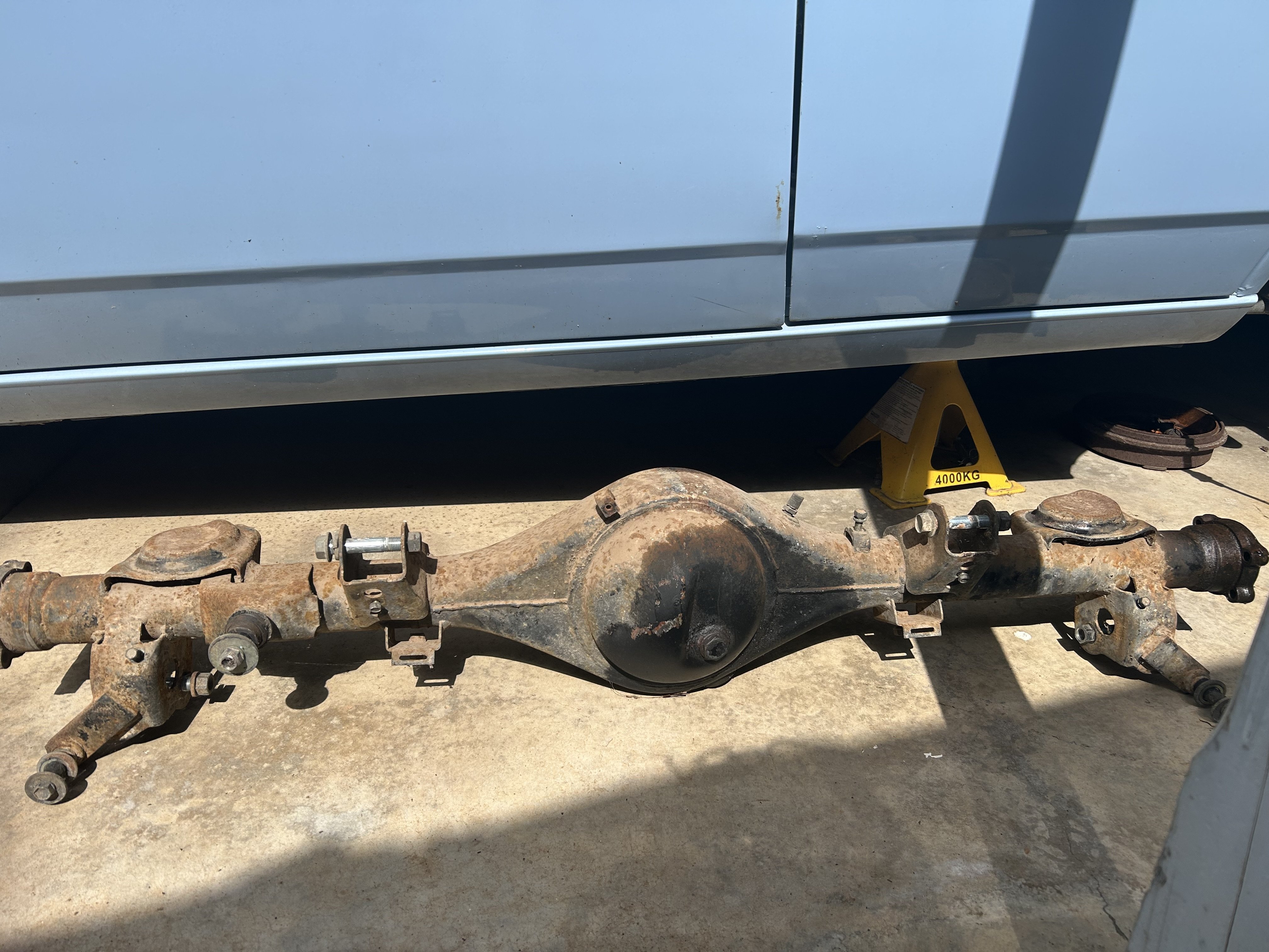

I managed to find the housing for the T-series from an old Celica in my local yard. No diff unfortunately, but that's alright because I'm thinking I'd like an LSD to support the new engine anyways. Are there still any places that sell LSD's for this housing and if so which ones are recommended.

I did not, only was able to get the housing pictured above.
OK, well you need to know what model it came out of so you can source the axles.  I suspect that will be the hardest piece of the puzzle.

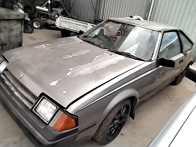

Unfortunately all I can find is that it was from this 1984 Celica. Upullit has crushed it in the time since then. However, my hazy memory wants to believe it had the T312 axle code on the build plate.
I'll have to be much more vigilant with photos in the future. 😅
