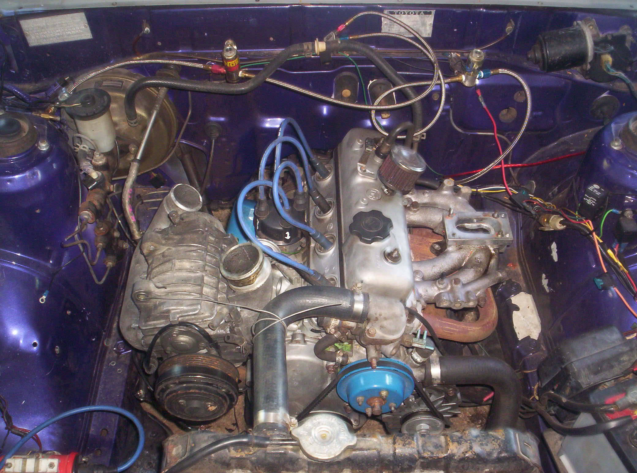

hi to all just asking if anyone knows how strong a 4k-c is. coz i have a ke70 and its got a fully workd 4k-c and I'm in the progres of bolting a blower on it and i don't no if shes going to hold up or not. yeah i forgot to say its go 50hp of nos going in to it to :)

There actually isn't that much in the FAQ to really say how strong the 4K is. It does say that you shouldn't go above about 8psi of boost (which would be heaps for your engine anyway, imnost). It does say they're fairly well put together engines (which would indicate that it could take a fair bit of grunt), but there's no definitive comment to say: these engines can only create xhp before they explode.
I think that Matt (imnost) asked a fair question, and is simply inviting anyone who has built a similar engine to respond appropriately. The FAQ does have heaps of info, but doesn't answer everything.
But strong compared to what? Compared to a 2JZ its about as strong as a twig. Personally I think you'll be too busy mincing gearboxes to even bother about the engine. How "fully worked" is it? Camshaft and oversized pistons? or are we talking the FULLY worked with billet rods & crankshaft, forged pistons etc etc etc. I think at the very least you're going to need head studs.
Also, read the turbo 4K-C thread in engine conversions. Shitload of good info in there!
