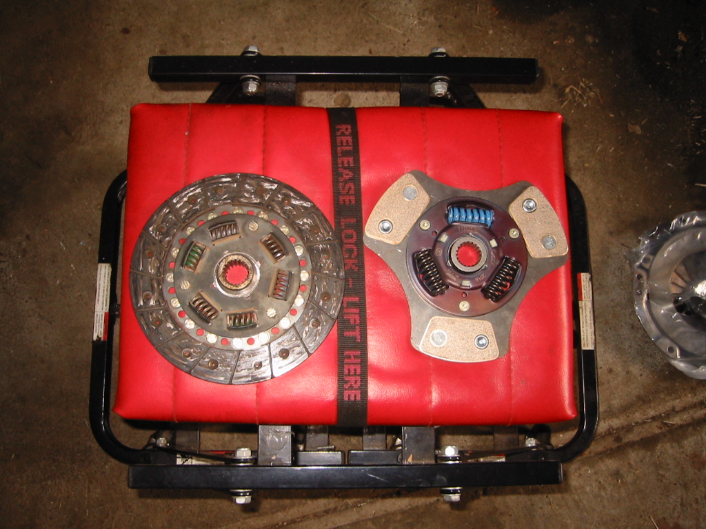

Redwarf Posted August 29, 2006 Report Share Posted August 29, 2006 (edited) I used a 3 puck ceramic with a sprung centre. Unfortunately, with decent horses, something is always going to go somewhere. Mine used to let go third about once a year. If you toughen the box, axles will let go. bigger axles, diffs. better diff, back to gearbox. Repeat. If you go backwards in clutch you'll lose hp at the wheels. What hp do you have at the wheels? Edited August 29, 2006 by Redwarf Quote Link to comment Share on other sites More sharing options...

Brendo Posted August 29, 2006 Author Report Share Posted August 29, 2006 i know i will lose a little power at the wheels if i downgrade clutch but i want the gearbox to last, for now anyway. redwarf i have 2 clutches identical to the one on the left u posted up, what are they like..... also not sure on power at the wheels Quote Link to comment Share on other sites More sharing options...
Brendo Posted August 29, 2006 Author Report Share Posted August 29, 2006 here are 4 spare clutches i have for it, 2 are the same. when i get the one out of the KE10 thats in it now i'll post that up too, ...any recommendations...? Quote Link to comment Share on other sites More sharing options...
Redwarf Posted August 29, 2006 Report Share Posted August 29, 2006 You're going backwards, and your times will suffer. Try and get a ceramic with a sprung centre. A standard clutch after you've had a decent one will feel woeful. Unfortunately, as I said before, with Hp, it's time to upgrade stuff, which gets to be a never ending cycle. Change the box. There cheaper than clutches, and easier to change. If it's only a toy, I'd stick with the grunter clutch. R Quote Link to comment Share on other sites More sharing options...
