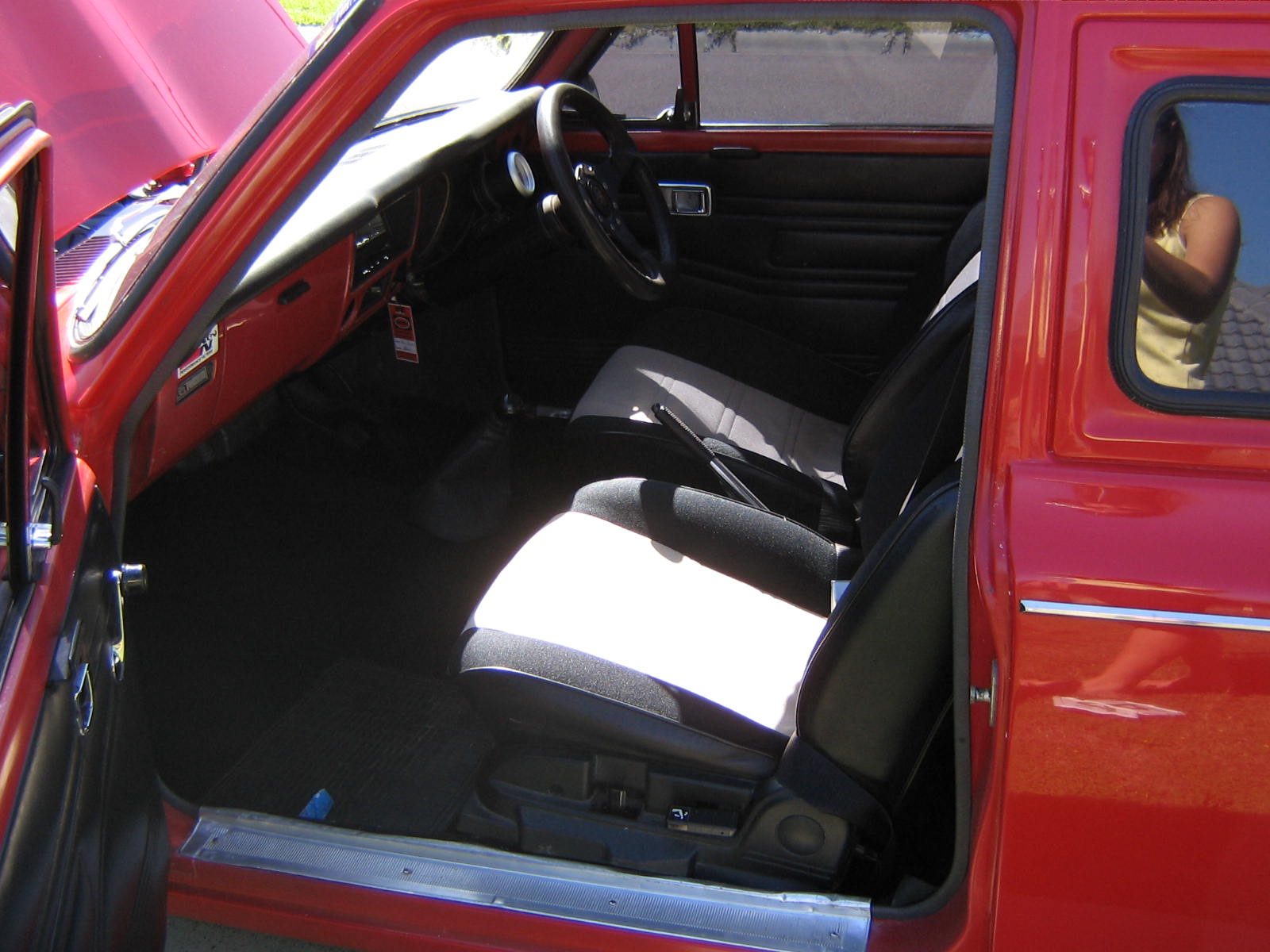

$3800, i have receipts for everything, all ignition is brand new crane cams (overkill really) elect dizzy thats graphed to suit, tacho, rebuilt rear drums, new rubbers, aztec red tupac paint with 6 coats of clear, new carpet, engines got camtech 609, double valve springs, 10.1 comp, chrome rings, ports have been cleaned, fully balanced, new water pump, new 95 amp alternator, extractors with heat wrap, 2 inch exhaust, k&n filter, 7ke manifold, & throttle body, microtech computer, new clutch, lightened fly wheel (only reduced by 900g), new uni joints, new pedders shocks and bushes, reco steering box, thermo fan, dynoed to 74 hp atw with potential for more if your willing to rev it to 7500 (should be about 95hp), the 5 speed has a short shifter but with the crack in the bell housing i would put a new one in straight away even though it still drives, might even do that if i have the time.
the car's sweet and a regretable sale but my love of old fords & v8s is much stronger.
there's also a set of 14x5dragways for it but the front gaurds need flaring to be legal, the whole car is legal, fully engineered for nsw with five months rego
