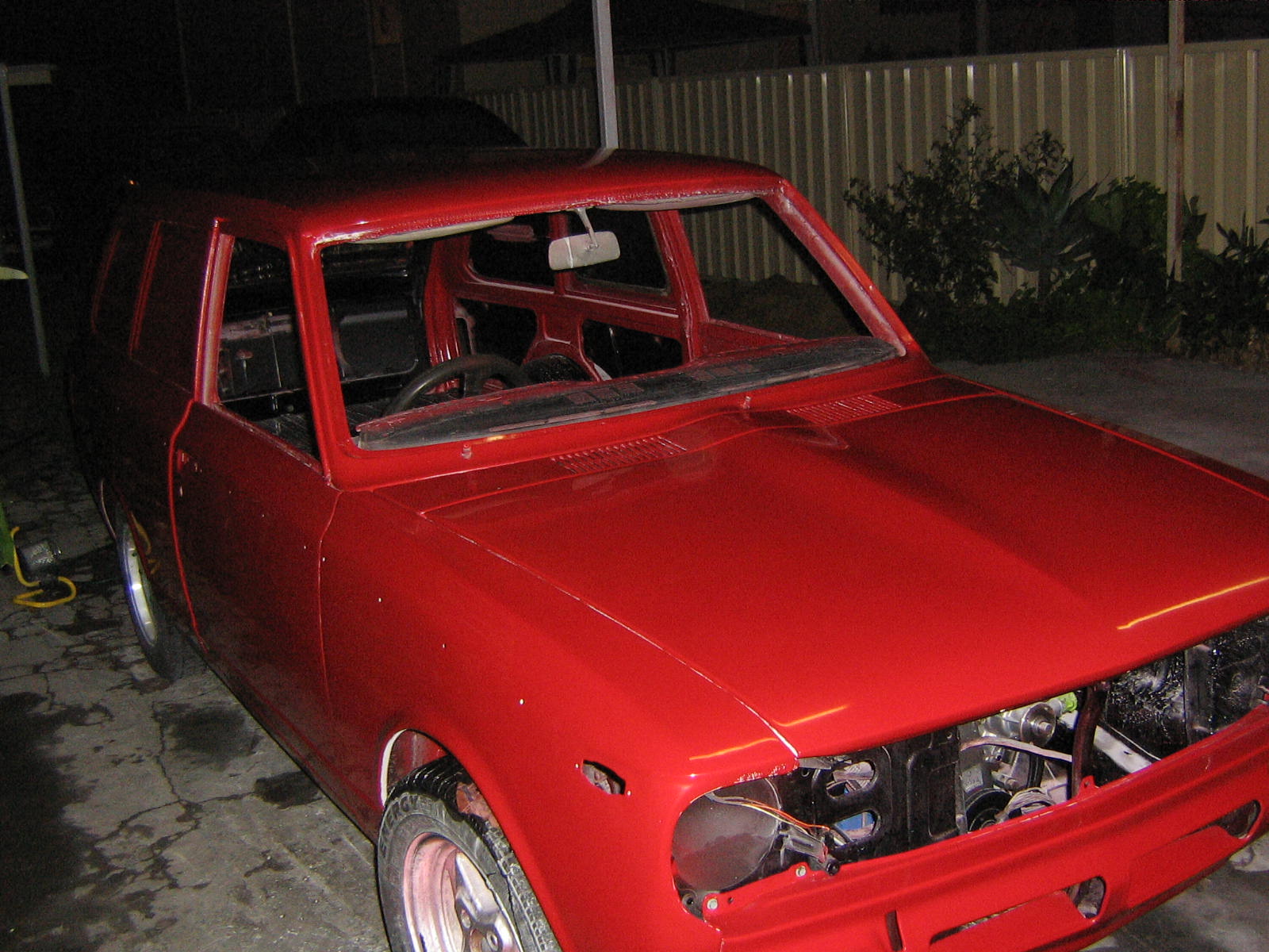

gday everyone,
this is my ke16 I semi rebuilt, painted etc. It's got a rebuilt 4k with 7ke fuel injection, crane cams electric distributor and coil, 5speed, tacho. We put it on the dyno last friday and had huge back fire type flutters out of the throttle body, since running the motor in over the last two weeks it hasn't been reving well at all, so i thought a tune would sought things out but the owner of the dyno seems to think a lobe on the cam has been chewed off. We measured the valve lift and it looks like my rebuild could of been a rip off, I asked for a tighe cam with .423 valve lift and we measured around .25. The cam comes out tomorrow for an inspection and measure.
