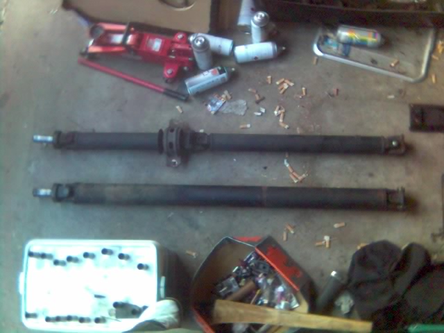

September 20, 200620 yr comment_142035 yeah hey i got my dodgy 4 speed out(of the ke70) and the k50 out(of the ke55) now the k50 is a bit longer than the 4 speed but the 5 speed tailshaft is a bit shorter than the 4 speed tailshaft so it should be right but the original tailshaft on the ke70 was a two piece (kinda like a big nunchucka...it was fun) and the 5 speed one is one piece Now my question is is the one piece tailshaft going to encounter any problems cause of the different suspension? ke 55 has leaf springs ke 70 has coil springs any ideas? Will extractors that fit 4K engines fit 5K engines? stupid question I'm pretty sure that i read it somewhere on the forum but i can't remember cause if so i wanna blow up my 4 k and swap the cam to a 5 k and repeat the process it should be fun Report

September 20, 200620 yr comment_142069 You need a KE70 5 speed sedan tailshaft (two-piece). If you use a KE55 gearbox you will have a furthe forward shifter position and may have to cut a new shifter hole. Report

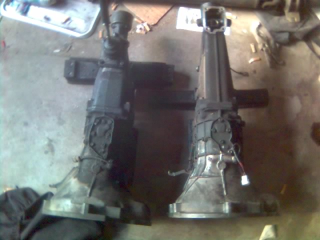

September 22, 200620 yr Author comment_142414 hmm, what gearboxes came in 5 speed ke70's wasn't it the k50? the gearbox outa the ke55 wasnt the factory box, it was an auto swapped to a 5 speed il get pics Edited September 22, 200620 yr by OniBerserker Report
September 22, 200620 yr comment_142419 Yes , its still a K50, but there were two different ones. The KE55 one had a shorter shifter position to the KE70 one which had a longer shifter position and sat further back. So my guess is you have a KE55 one which WILL require you to cut a hole in the floor. Report
September 22, 200620 yr Author comment_142420 5 speed on left 5 speed tailshaft is south my mascot like the weapon, cheap and nasty is the motto my staffie Panzer i like matt black lookin all alone in engine bay Edited September 22, 200620 yr by OniBerserker Report
September 26, 200620 yr Author comment_143164 the crossmember bolts are in the same position but are completly different what a pain in the ass i gotta get a new crossmember made up Report
September 26, 200620 yr comment_143166 Can't redrill the original crossmember? I'm sure thats what everyone else has done.. Report
September 26, 200620 yr comment_143220 All you need is a KE70 extension housing for that 5 speed, then it will bolt straight in Report
September 27, 200620 yr comment_143391 All you need is a KE70 extension housing for that 5 speed, then it will bolt straight in what about selector shafts? Report
September 27, 200620 yr comment_143432 Same. I have a KE70 5 speed with a KE55 extension housing in both my KE30 and my KE35 Report
