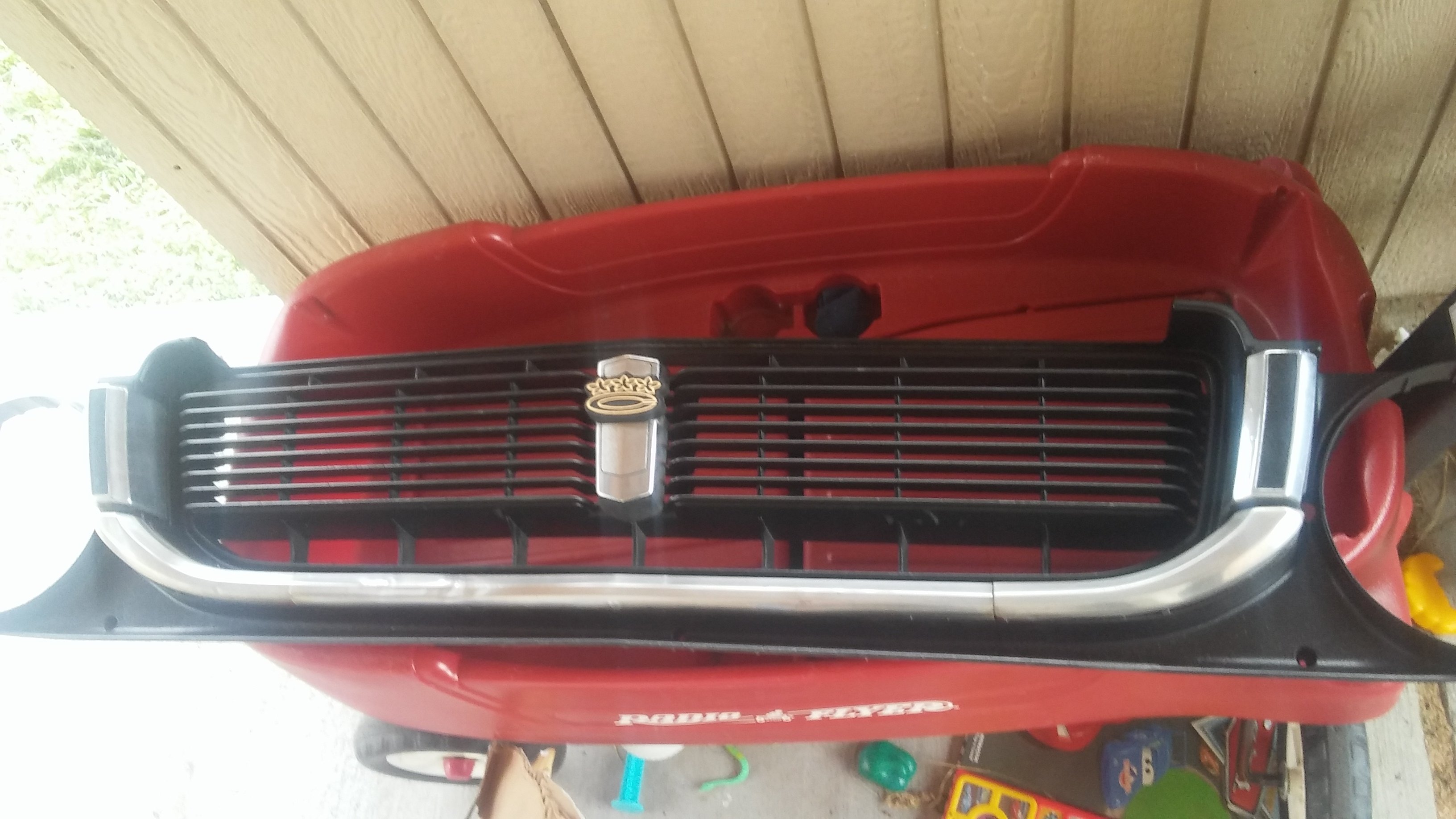

    Pretty happy with how these turned out.

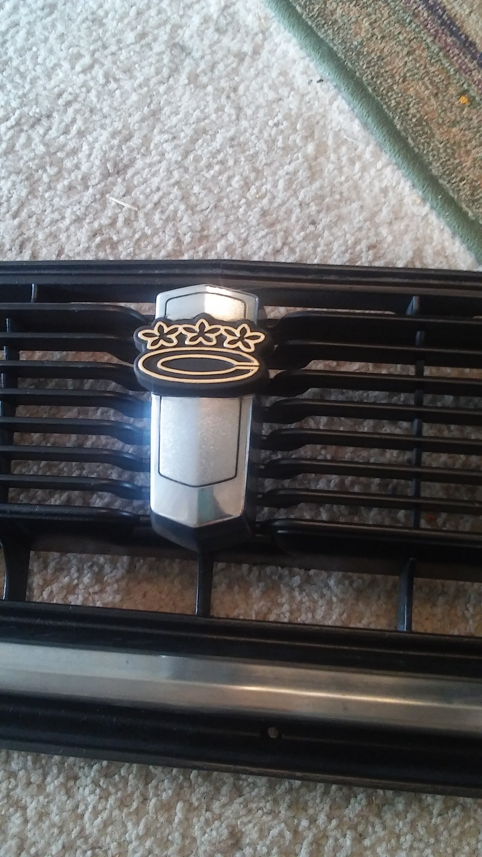

  2. Waiting on parts so i restored grill, emblem, removed dents and blemishes from chrome trim. Didn't work out all the dents yet but when I do I'll file the surface smooth, carefull not to go threw just knock down the highs and sand and buff till new. Believe me it was Easter to fix them find. With trim just be easy small taps re establish the lines and the rest will follow.
