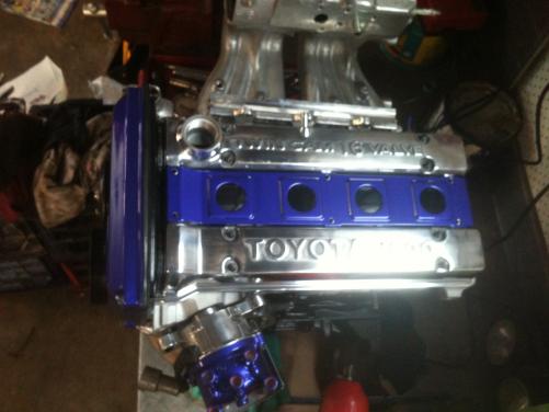

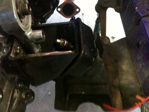

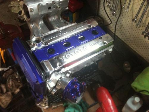

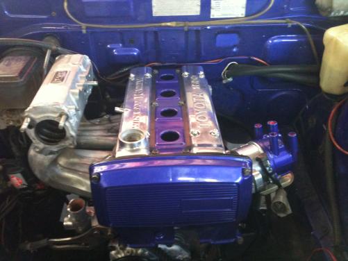

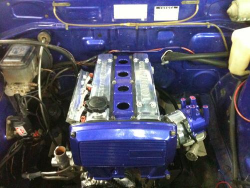

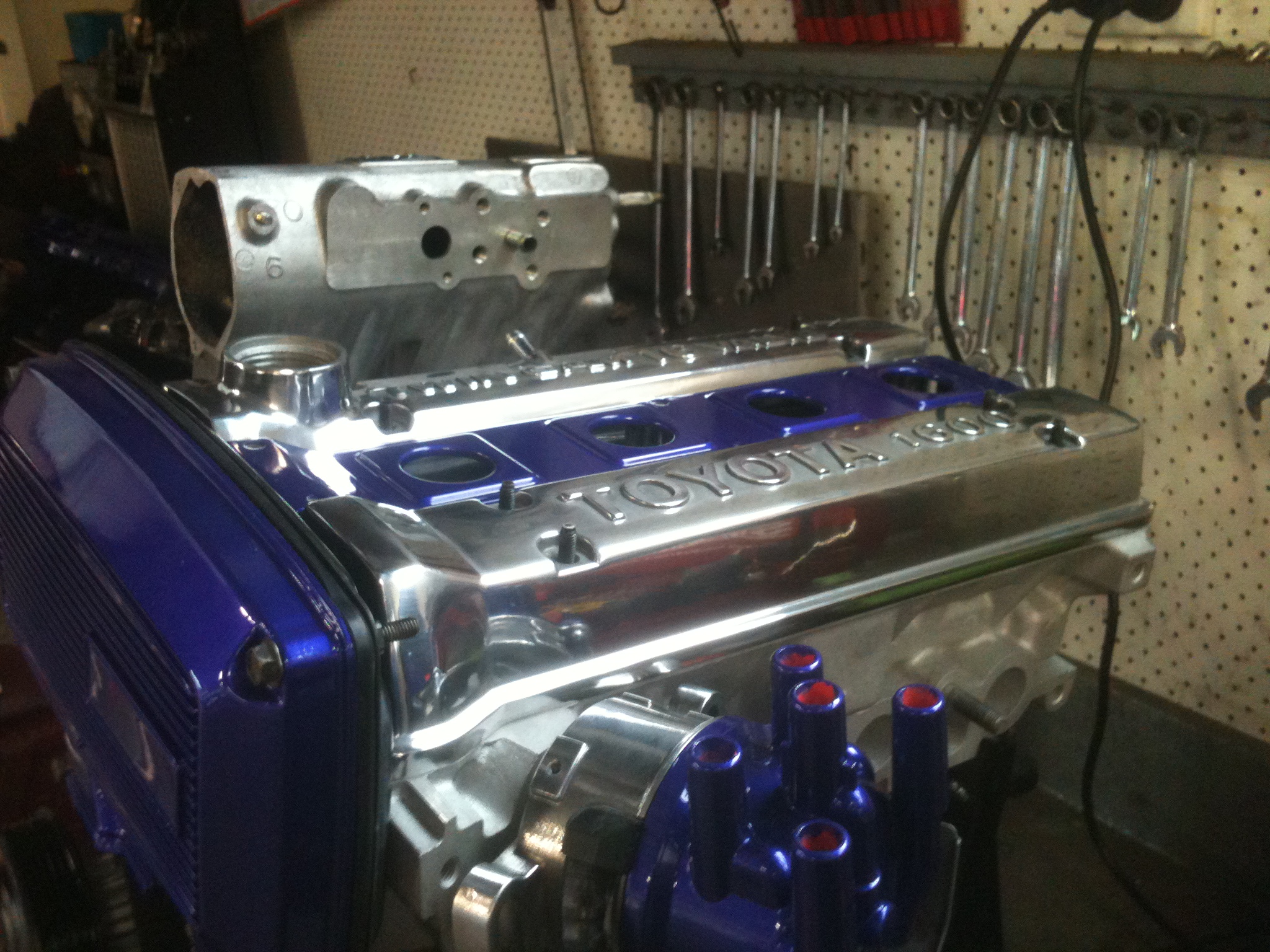

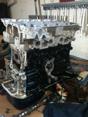

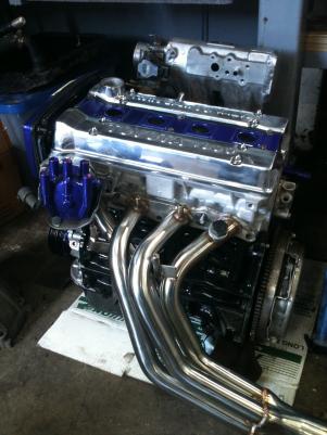

  6. hey guys, so iv made some progress finally.. so far i have achieved -made engine mounts and mounted engine in the car -went to measure the gearbox mount and turned out it bolt straight up to the t50 which i wasnt expecting -bought a yoke to fit g/box and that also fit right in I'm yet to install that though. also when i tried to put the manifold on which was cut and shut it didnt fit in due to hitting the master cylinder and i havent heard of that before so i had to cut the manifold to shorten it which i didnt want to do because i believe you loose power if not done right but it had to be done..also i can't use the tvis because that just adds more distance to clear with it.. and i have found out the exhaust manifold i bought hits the idler arm so not too happy about that so i moght have to pay some one to fix that problem.. also i have got all my fuel system components ready to go in the boot just have to get around to that ill post some pictures when thats done..here are some pics so far though hope yous like it :)

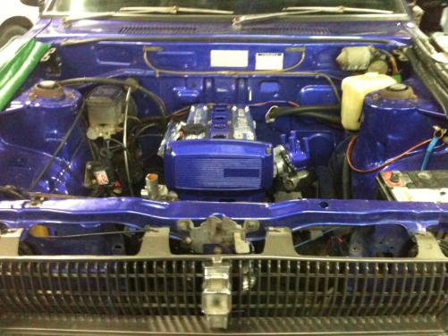

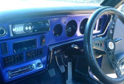

  11. yeh its a 4age..not completely sure about future plans just getting the engine in and running for now then when i have more money i plan to lower it, get rid of the little bit of rust it has, just little bits n peices..then eventually a better diff and the turbo one day lol thanks guys thats a good boost of motovation to keep on top of getting it done tho. umm yeh when i pull it out again ill get some better photos with more light with the gauges.

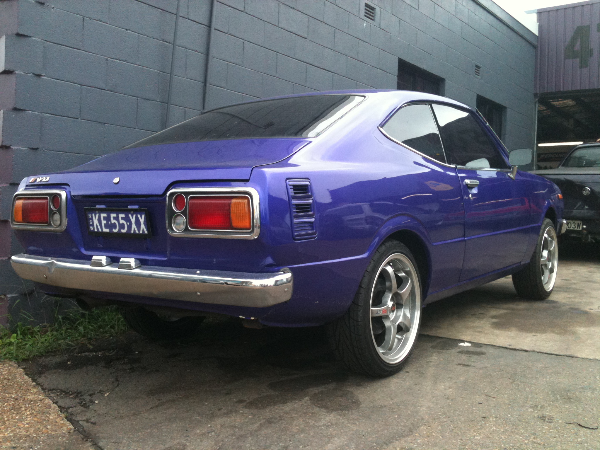

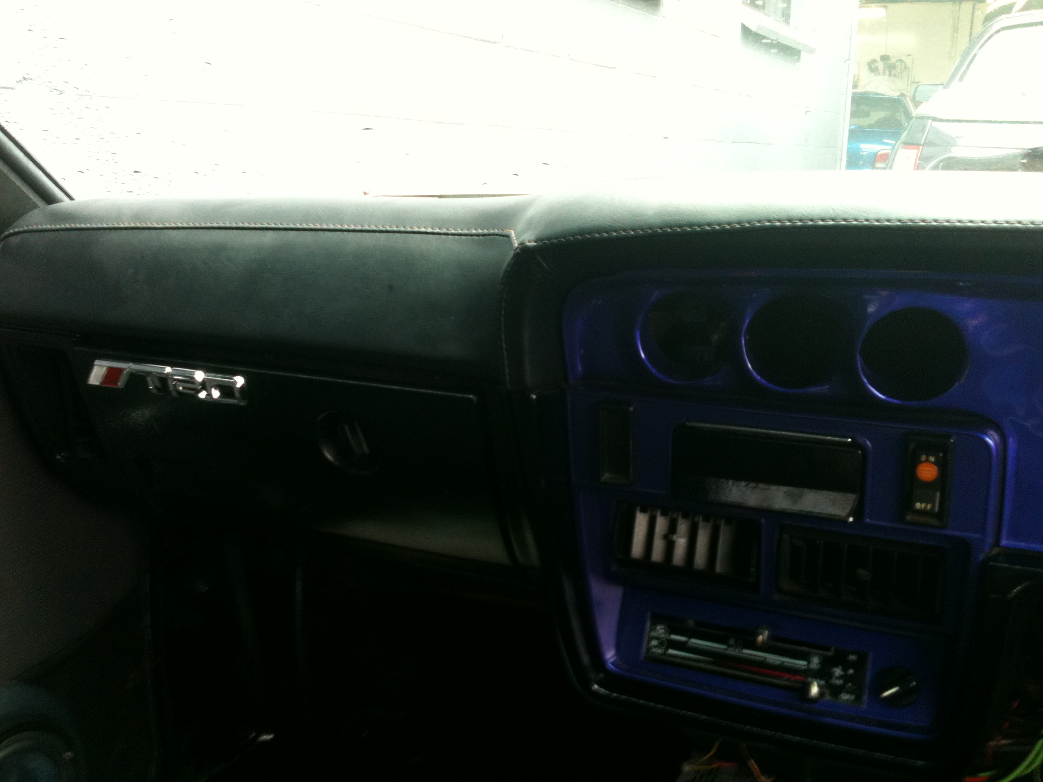

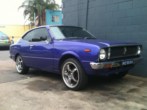

  13. Brandon daft Car: 1980 ke55 coupe Motor & Driveline: 5k with webbers, extractors and straight through exhaust.. ke70 5 speed stansard tailshaft and diff- soon to be 4age upgrade:) Suspension & Brakes:stock Wheels & Tyres:17" rsgt wheels Interior:retrimmed interior purple dash with moulded holes for gages Body:resprayed purple Name:

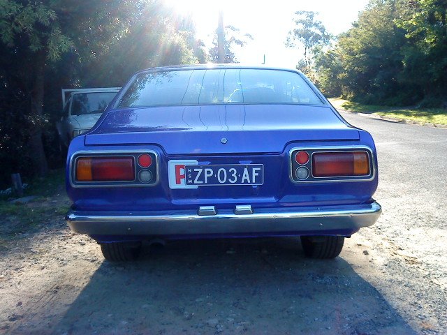

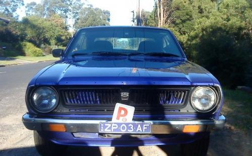

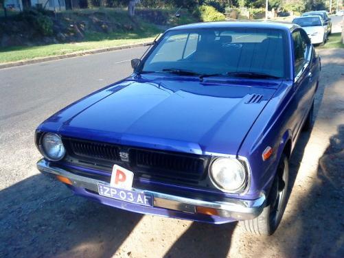

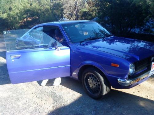

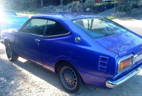

  14. hey guys this is my 55 so far, its definatly costing me but will deffinatly be worth it in the end. well this is it so far hope yous like it :)
