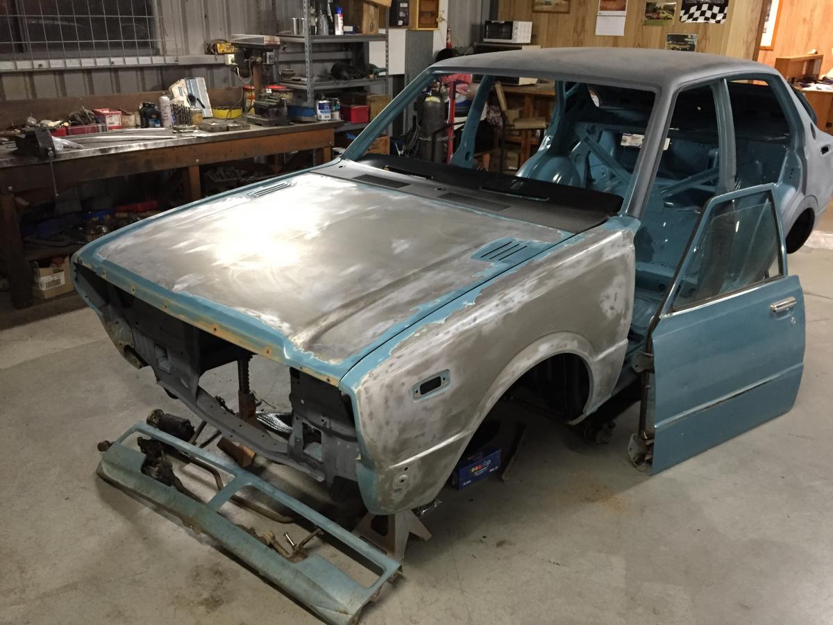

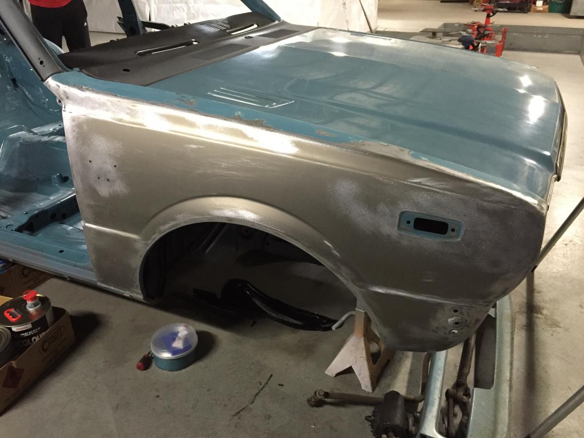

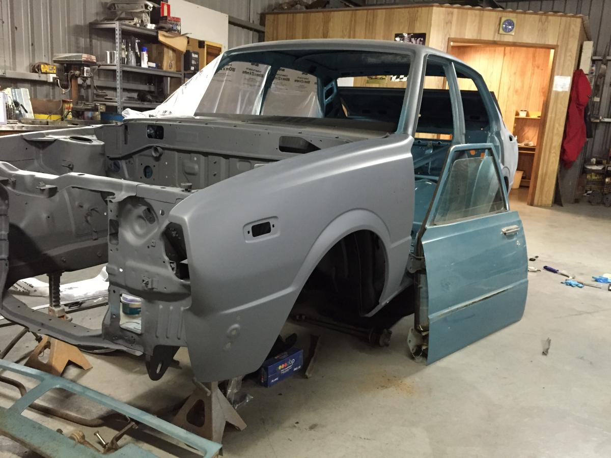

  2. Driver side guard nearly ready for paint
  3. I followed through. Flares are tacked on.
  4. .Wow so sorry guys, can't believe it's 5 1/2 months since I posted anything. It got hot and I lost my motivation, I bought a 60 series cruiser and did it up for 4wding and then bought a tractor for the property I just bought and had to work on the tractor. Next thing will be working on the property but hey the good thing is I'll be building a big shed to build more awesome rollas in. My mates are constantly on my back about finishing this car to so I'd better get to it. Yesterday was 4 years since I bought it. So tonight I have made a start on the flares, really happy with the style I chose. Tomorrow night I will hopefully tack then onto the guards then I can fine tune them with filler and bog up the dints and rust, give them a coat of paint and then they're ready to make moulds off

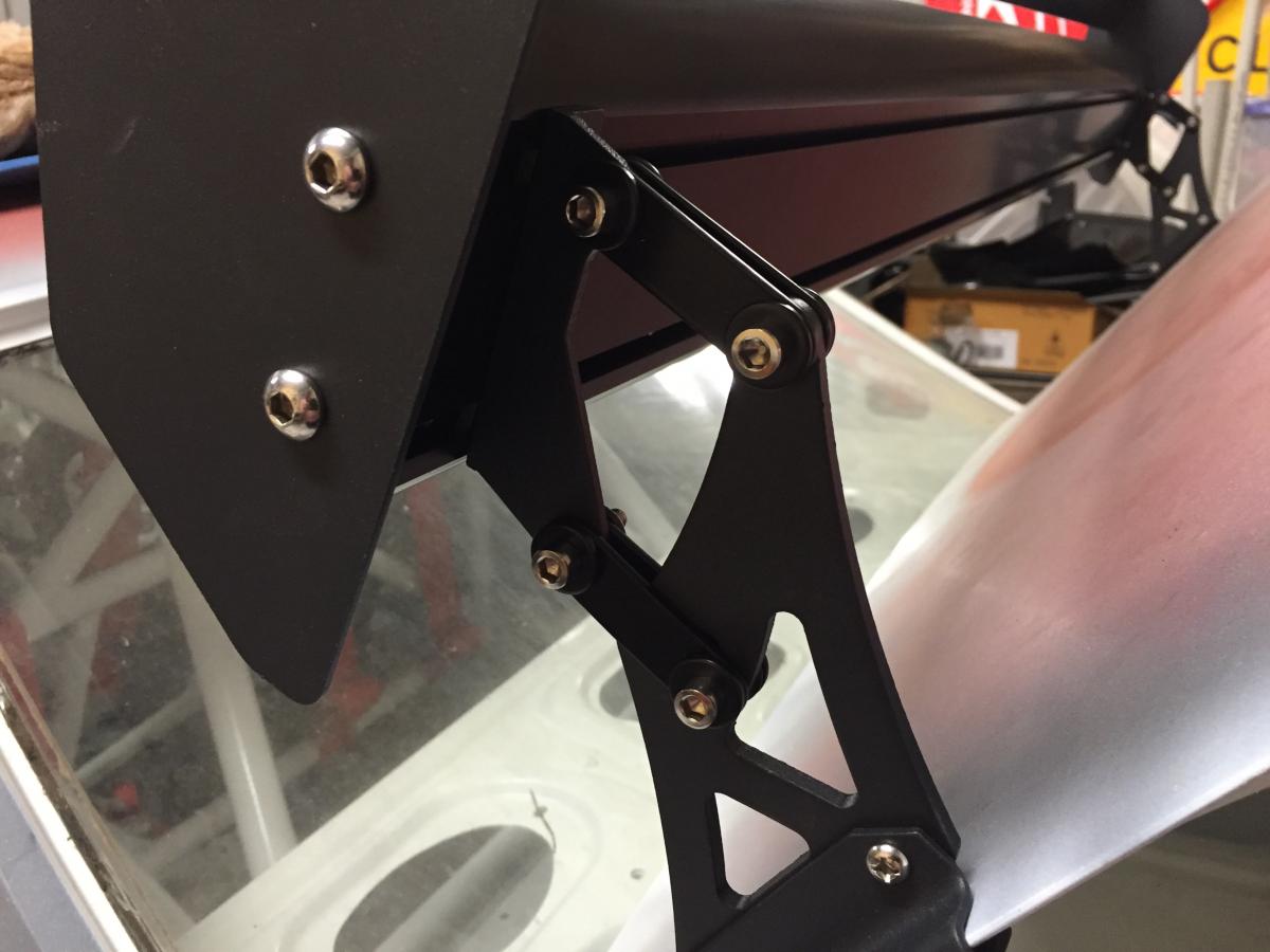

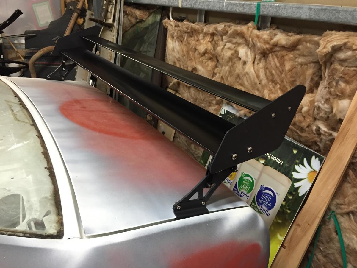

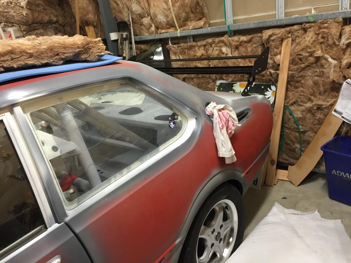

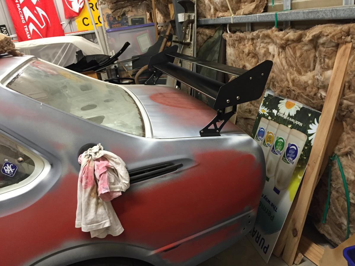

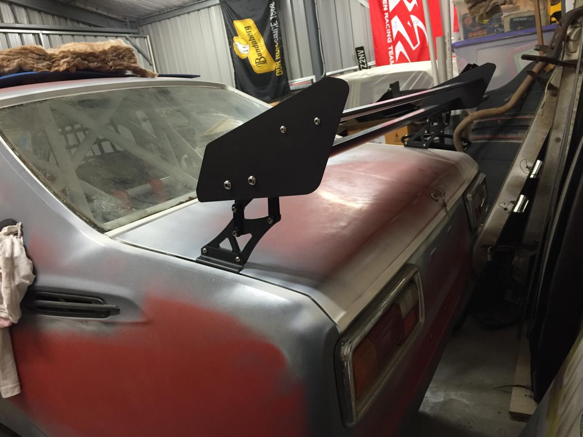

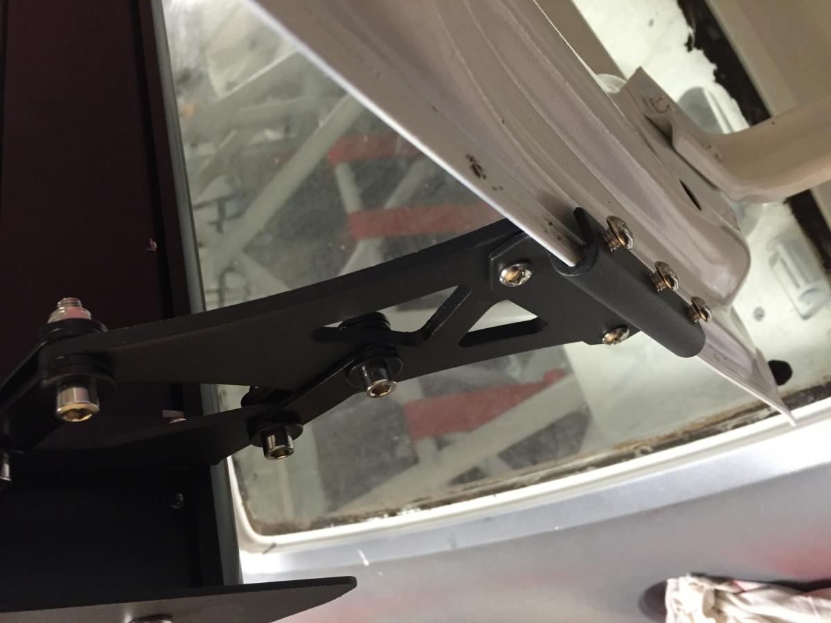

  21. Wing turned up, mounts are designed all wrong, I'll be remaking them but the wing itself is good

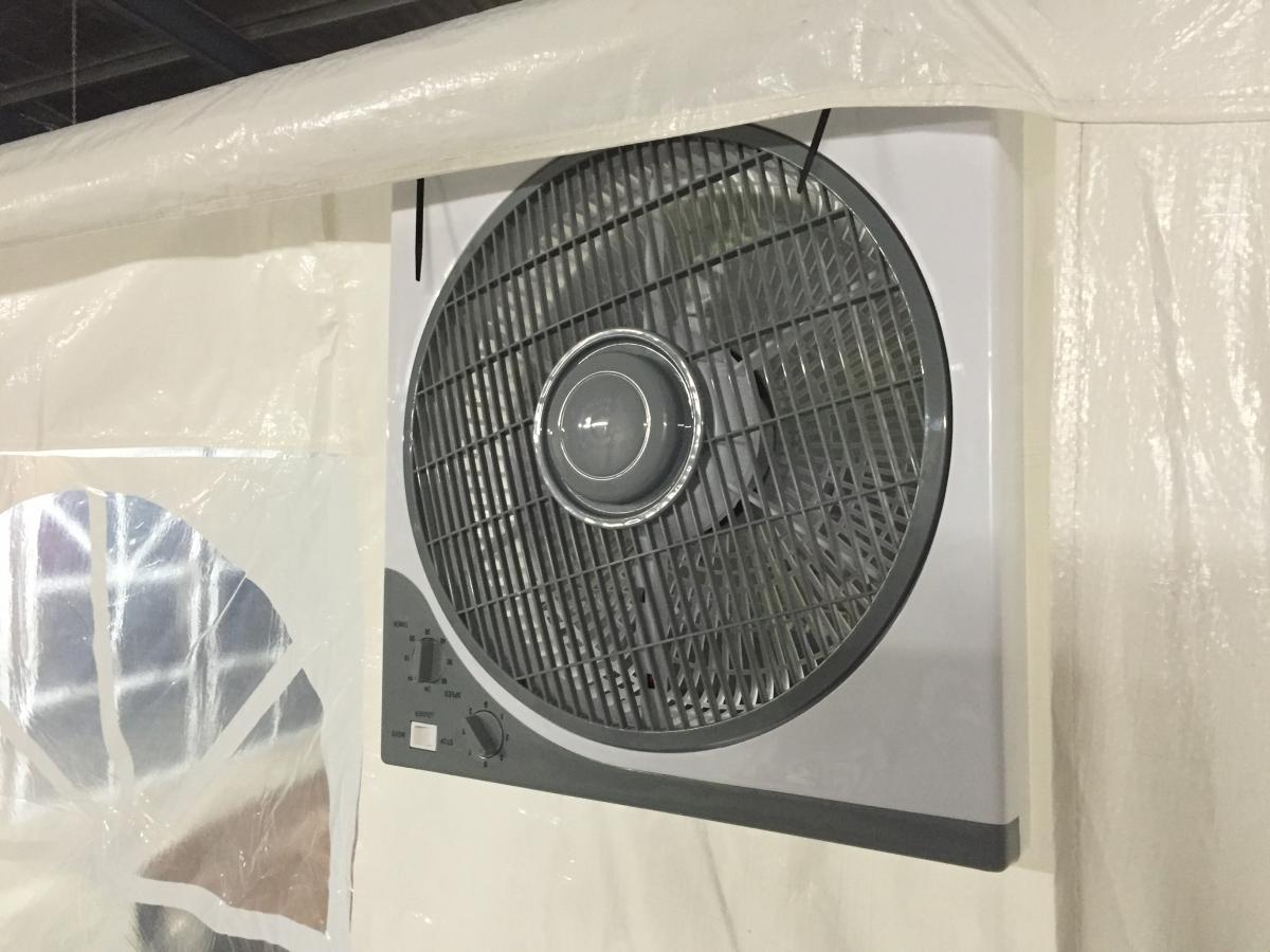

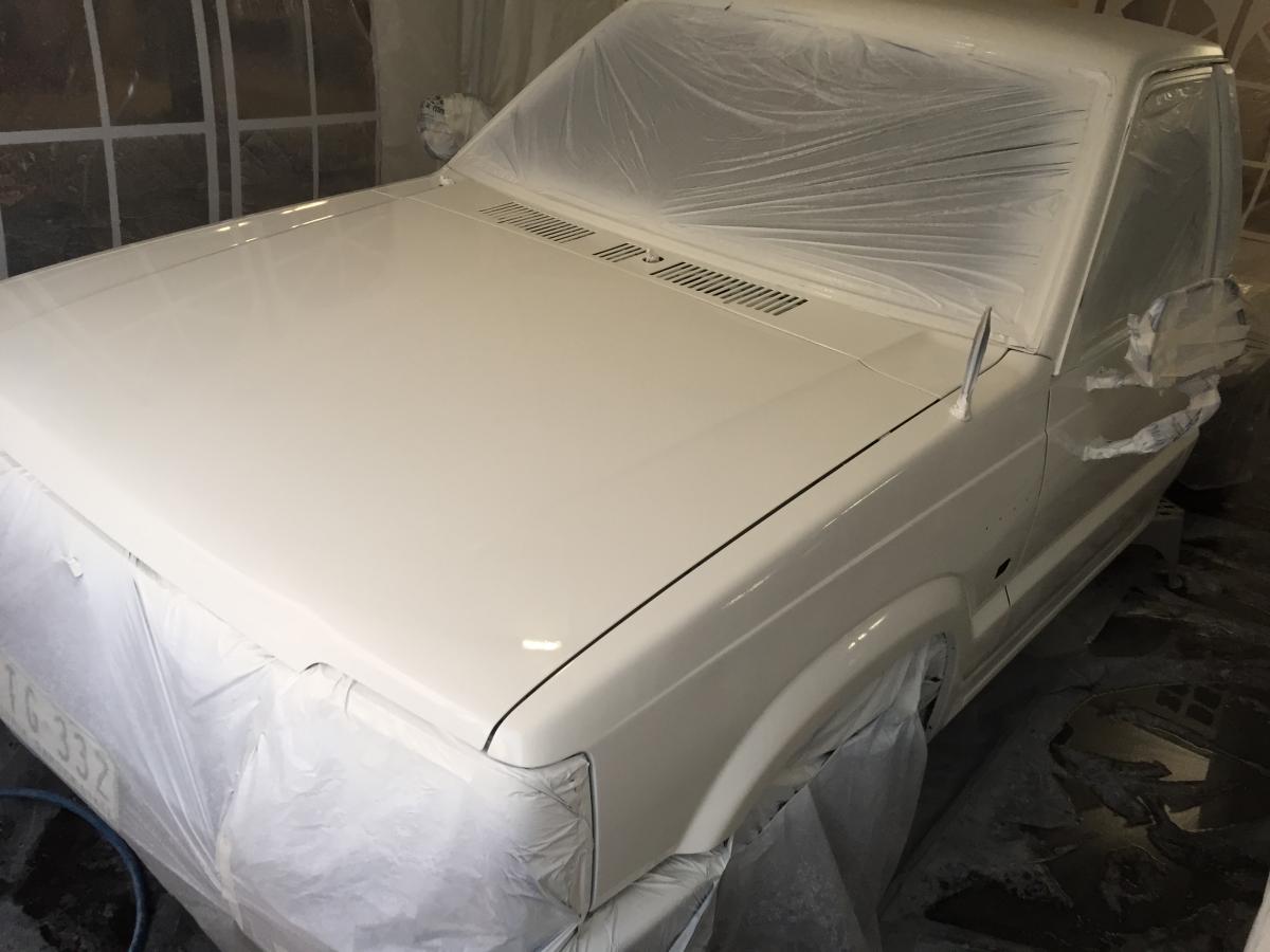

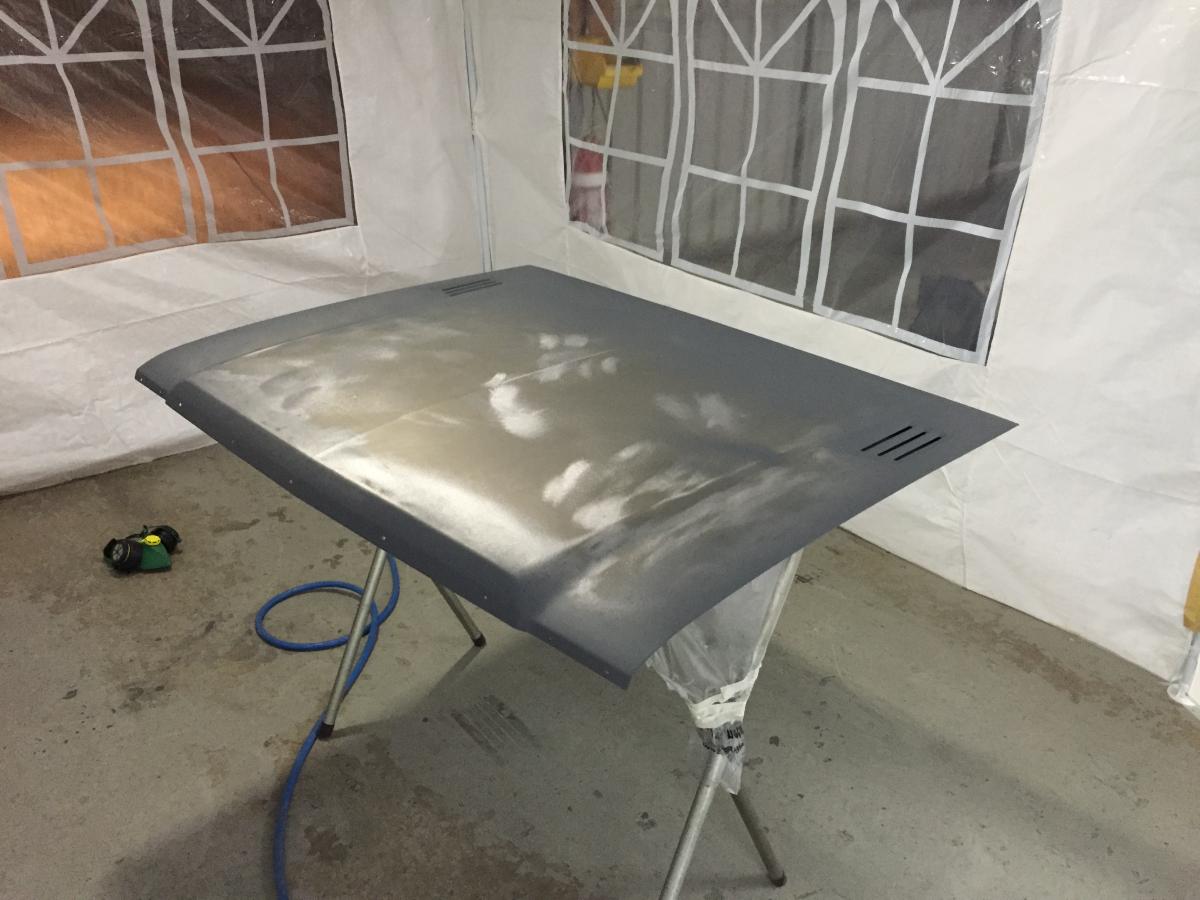

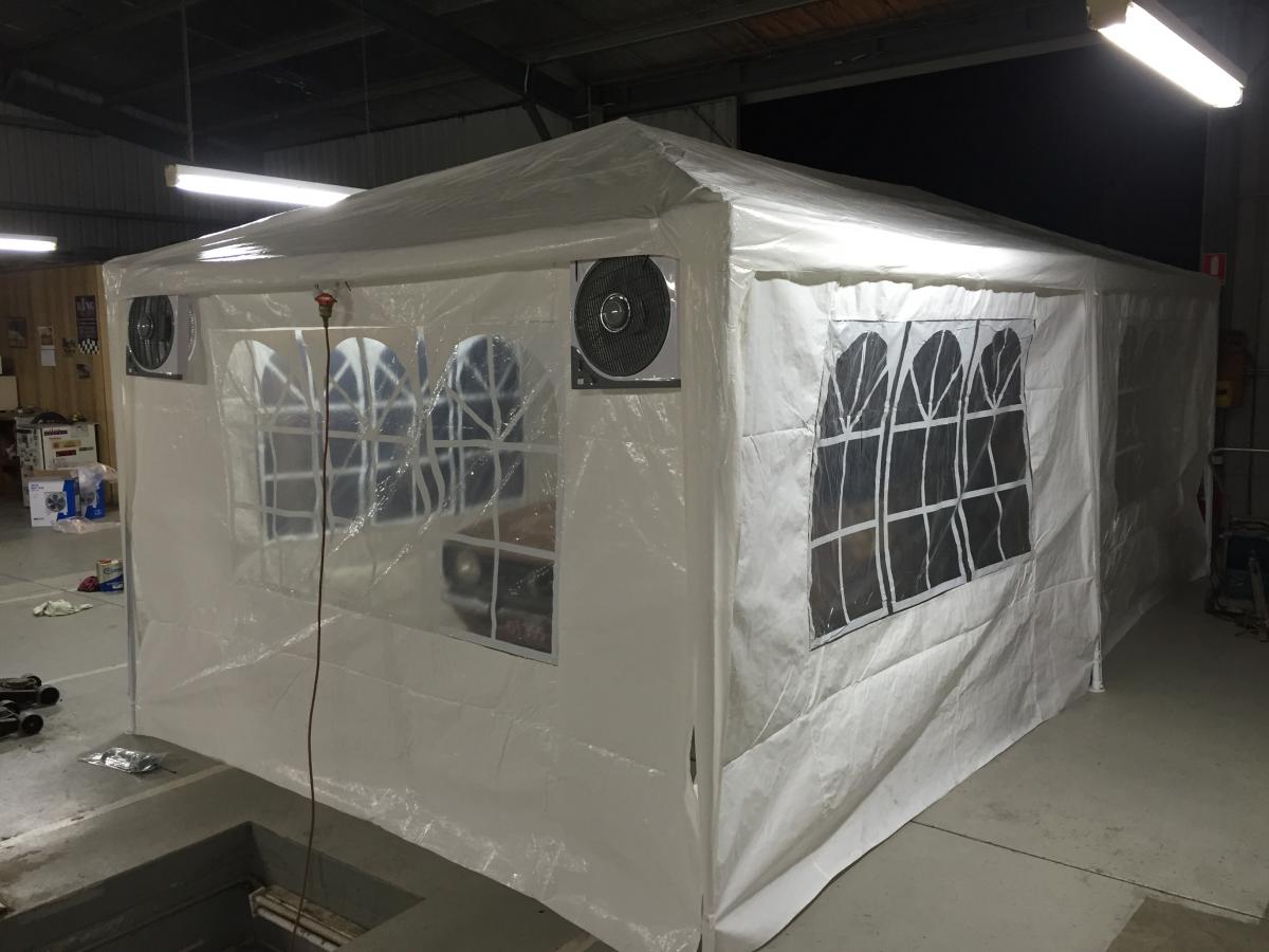

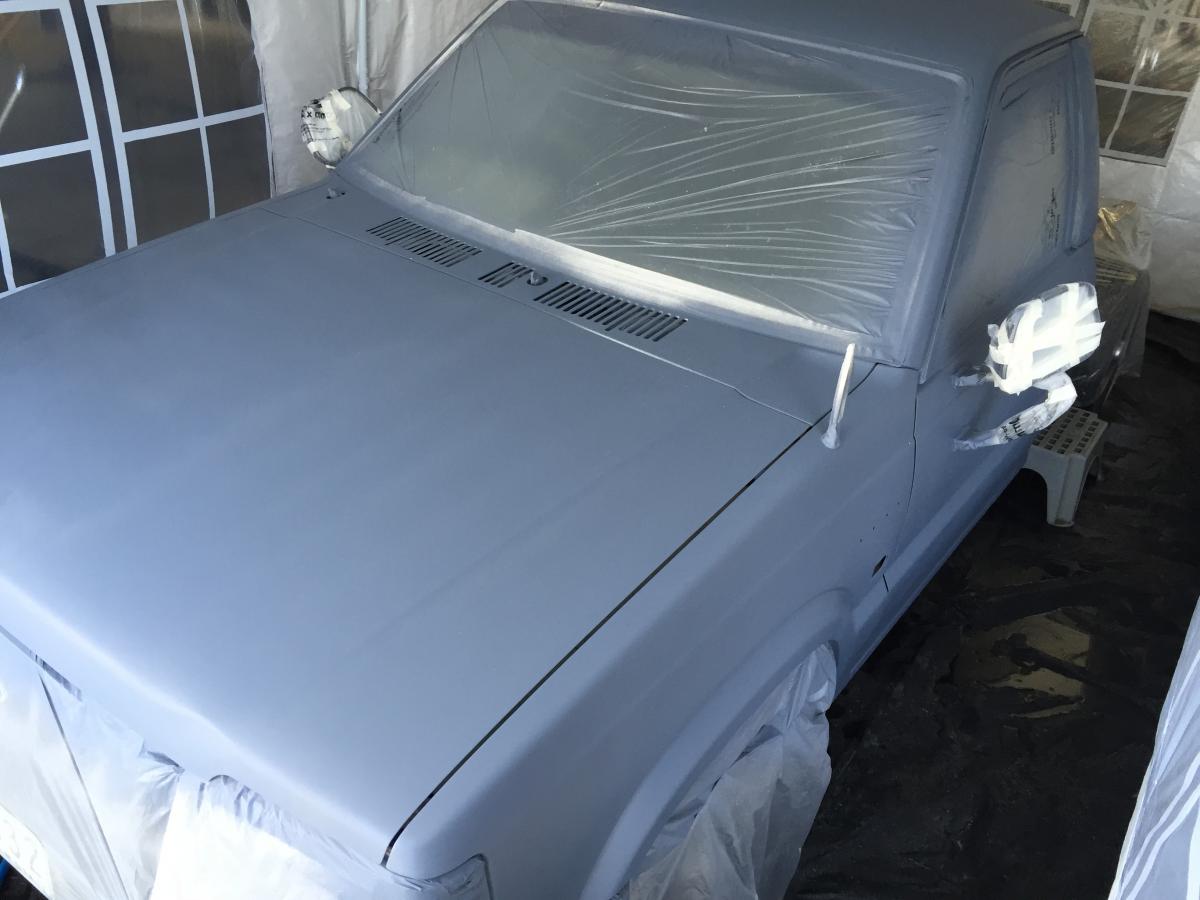

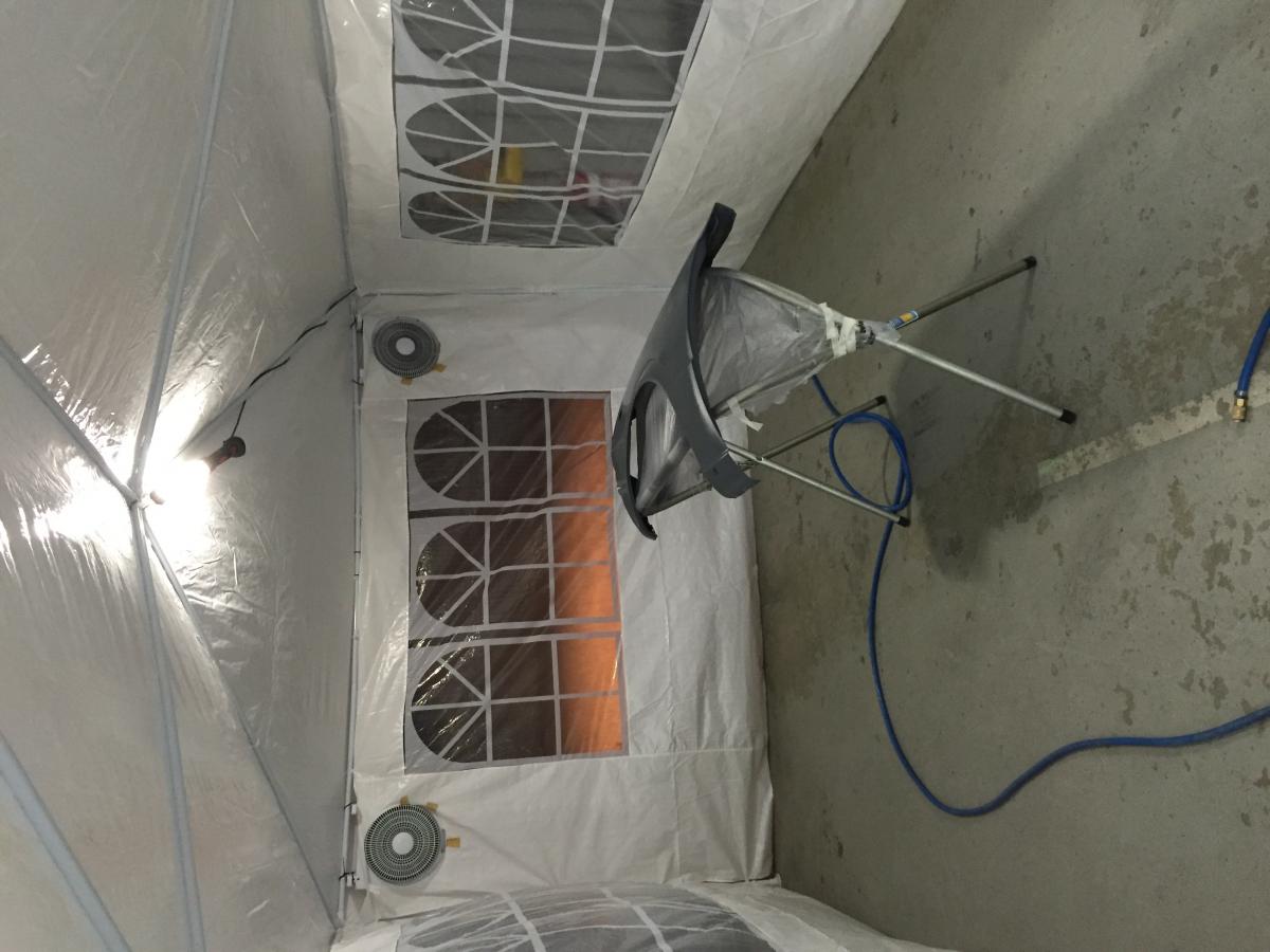

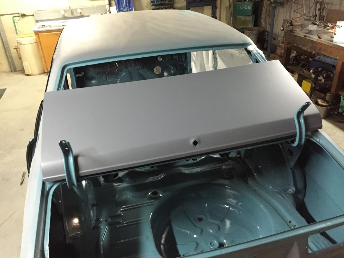

  22. Thanks, tested the booth and it works a treat

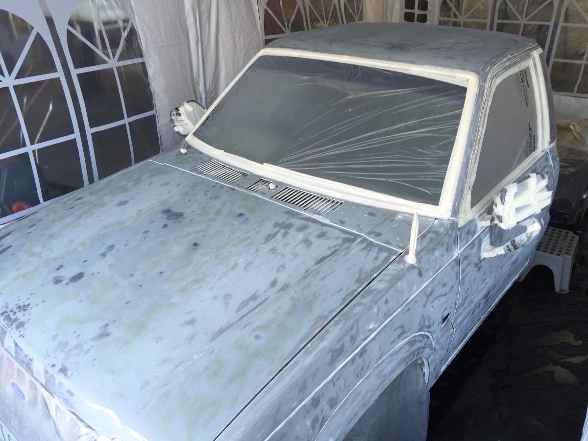

  23. Nah prepped Friday night painted Saturday. The rust was fixed Easter weekend, few late nights this week though, built a spray booth for $200, works great
