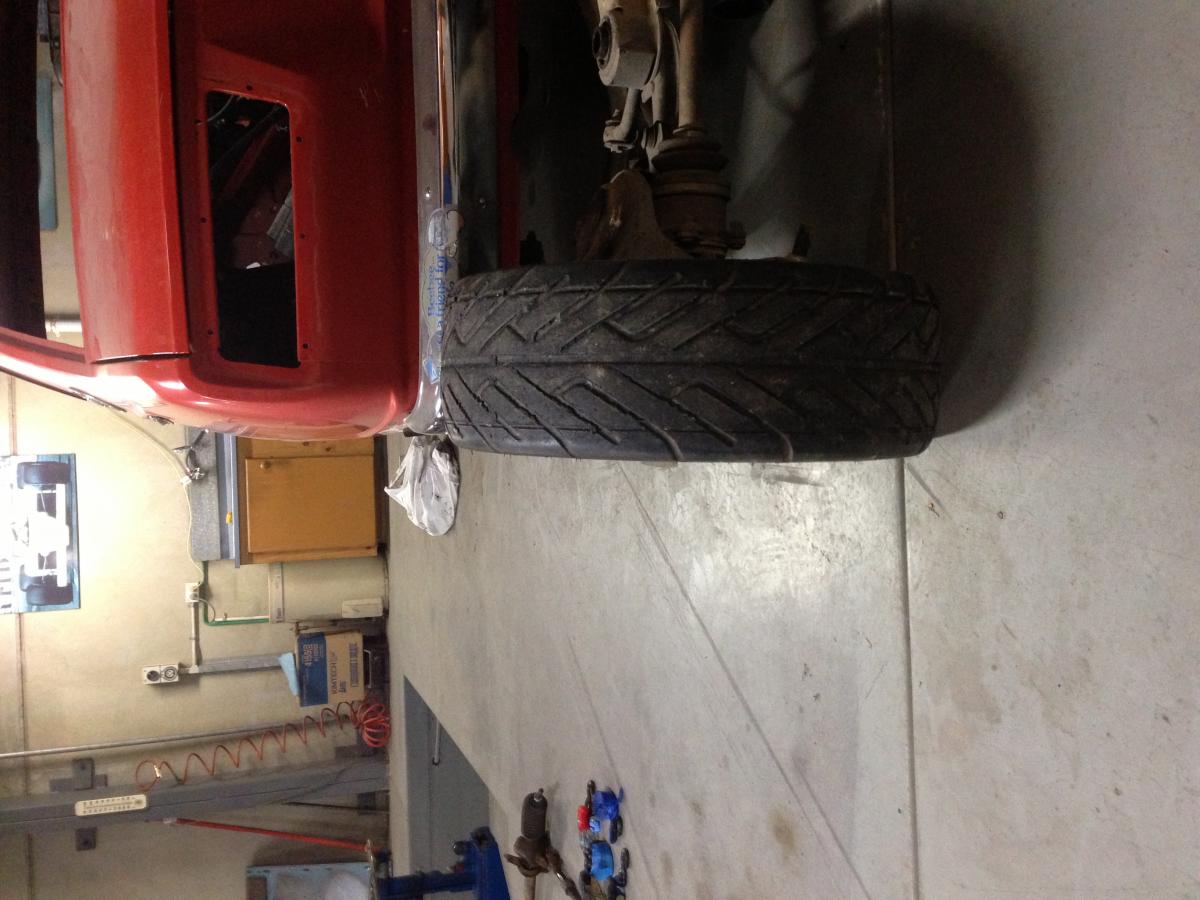

    Started on the front end, machined up some spacers so I could put rose joints in for the inner joint of the lover control arm, gonna make up some dummy control arms with some flat bar so I can work ou

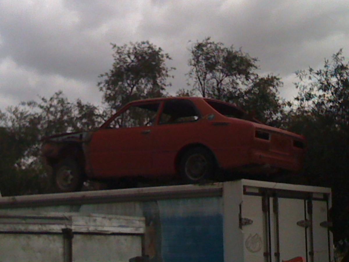

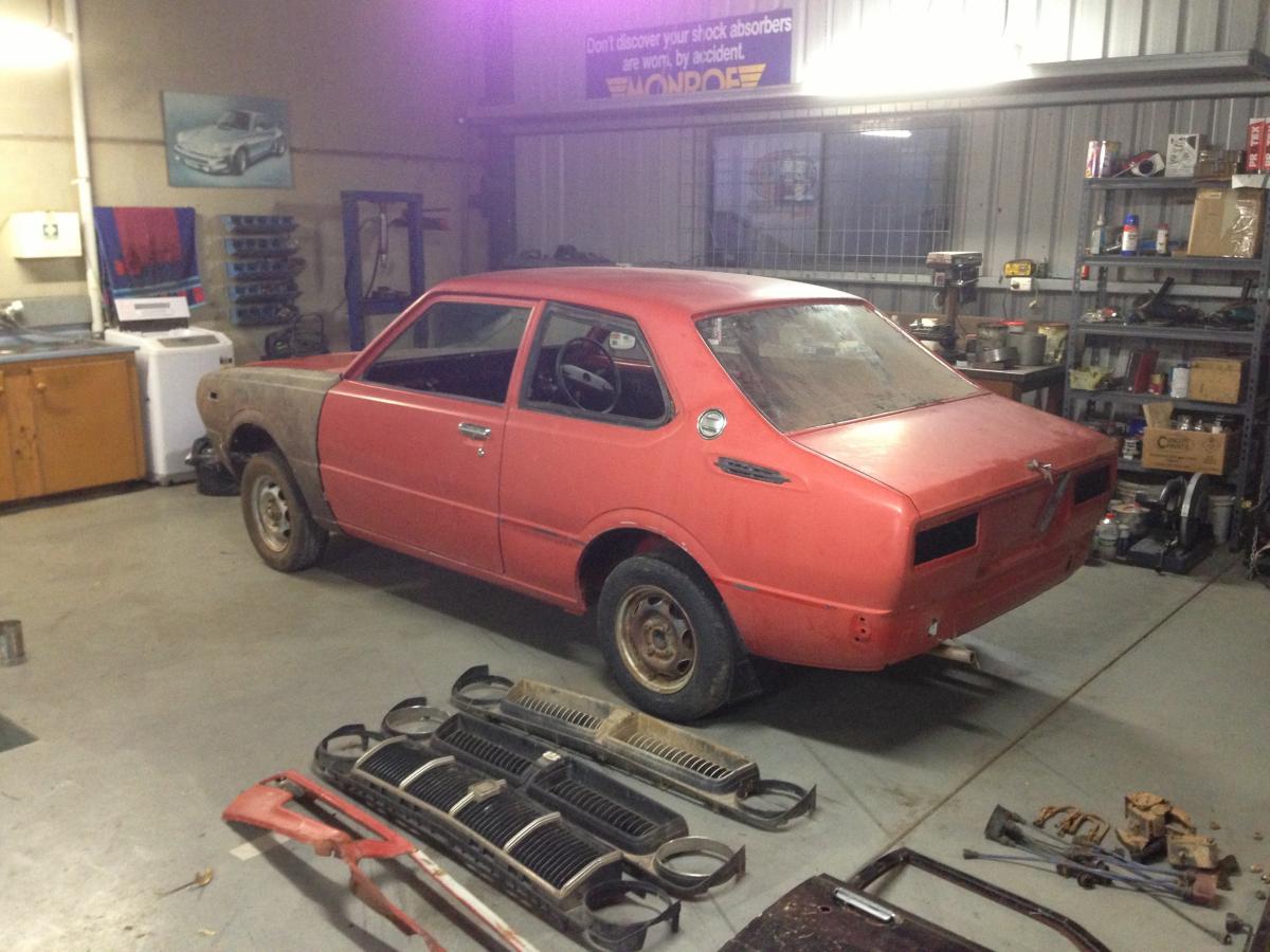

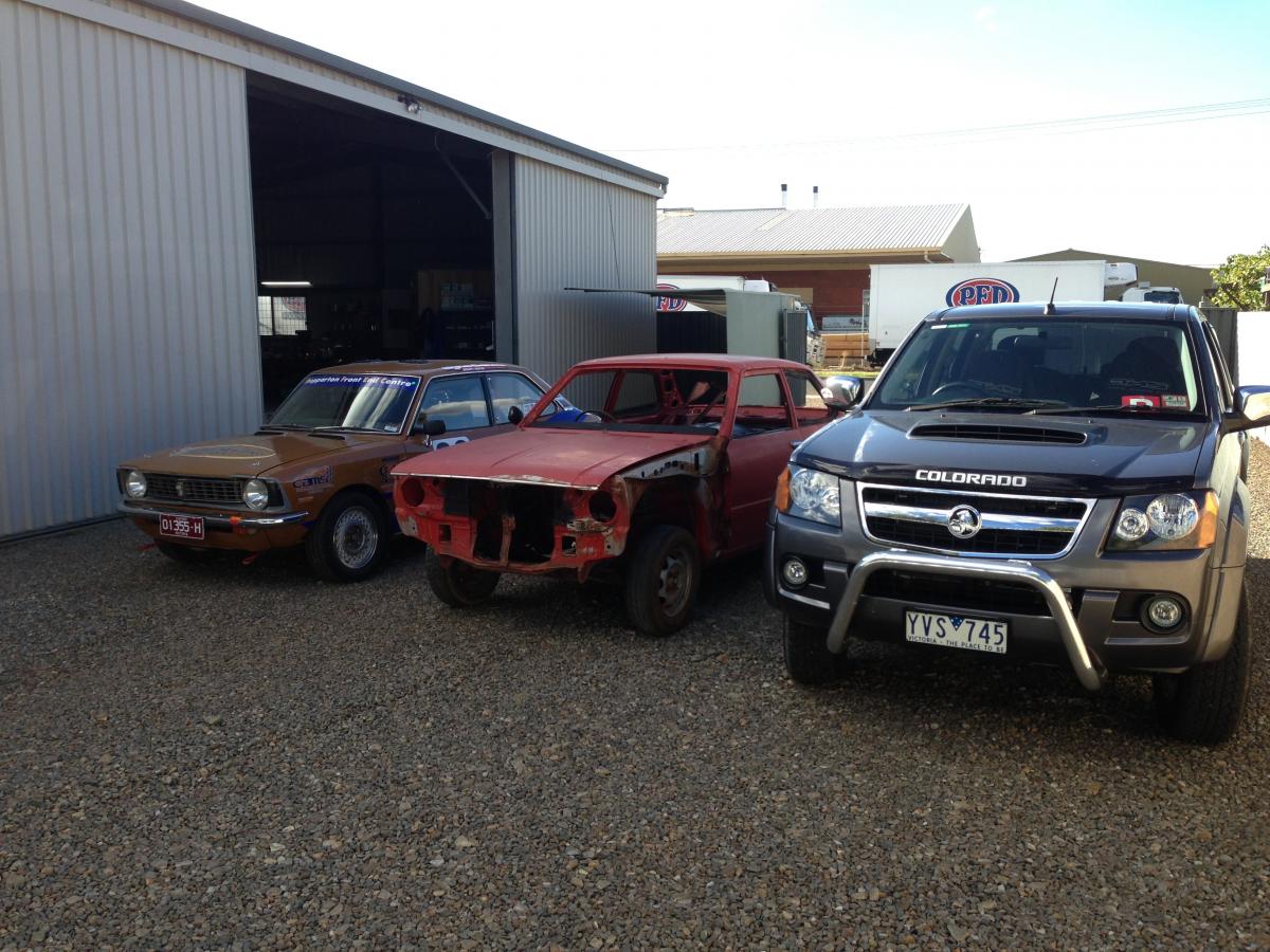

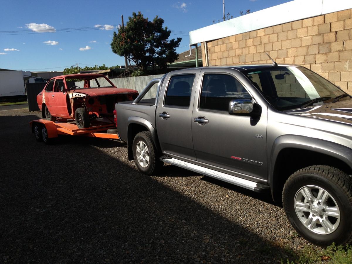

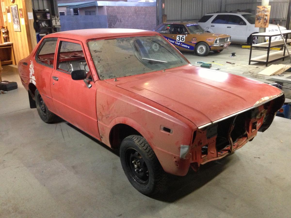

Late December last year I found this siting on a container while I was getting the engine bay blasted in my ke20 a couple of months later I went back a took it home for $350. The body is fantastic considering its age one small dint in the roof a dint in the door and a tiny bit of bog in the wheel arch. The third part to the fleet

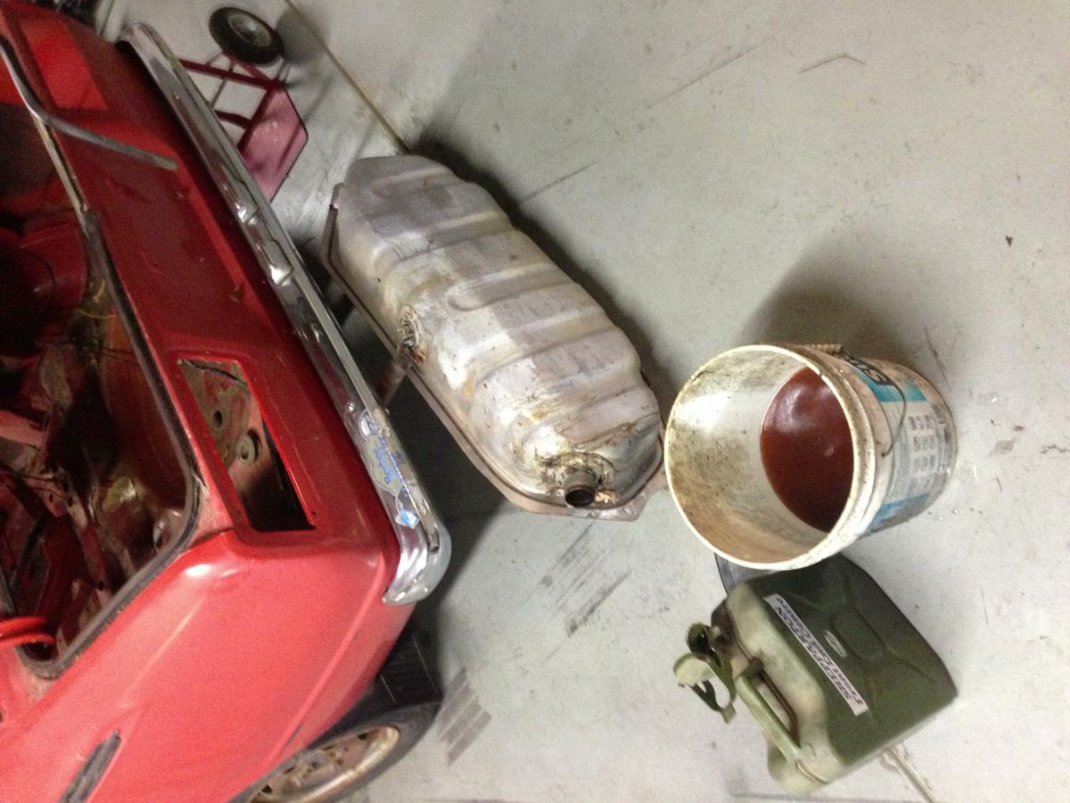

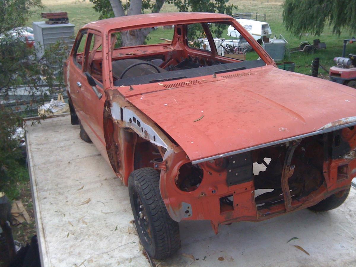

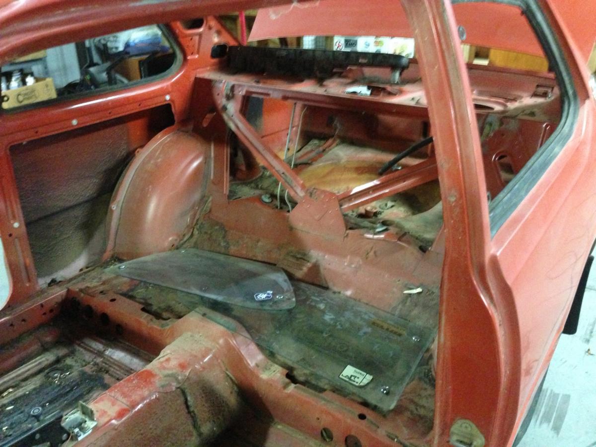

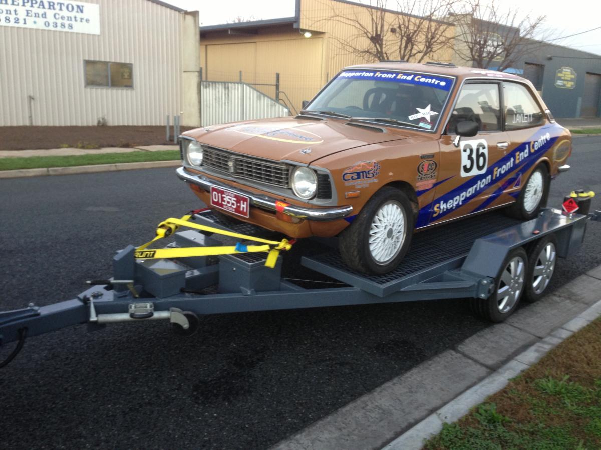

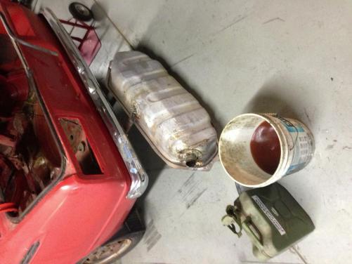

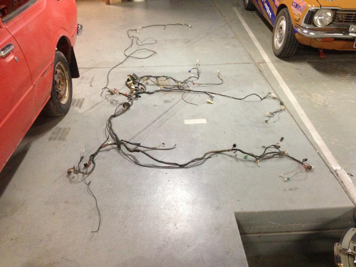

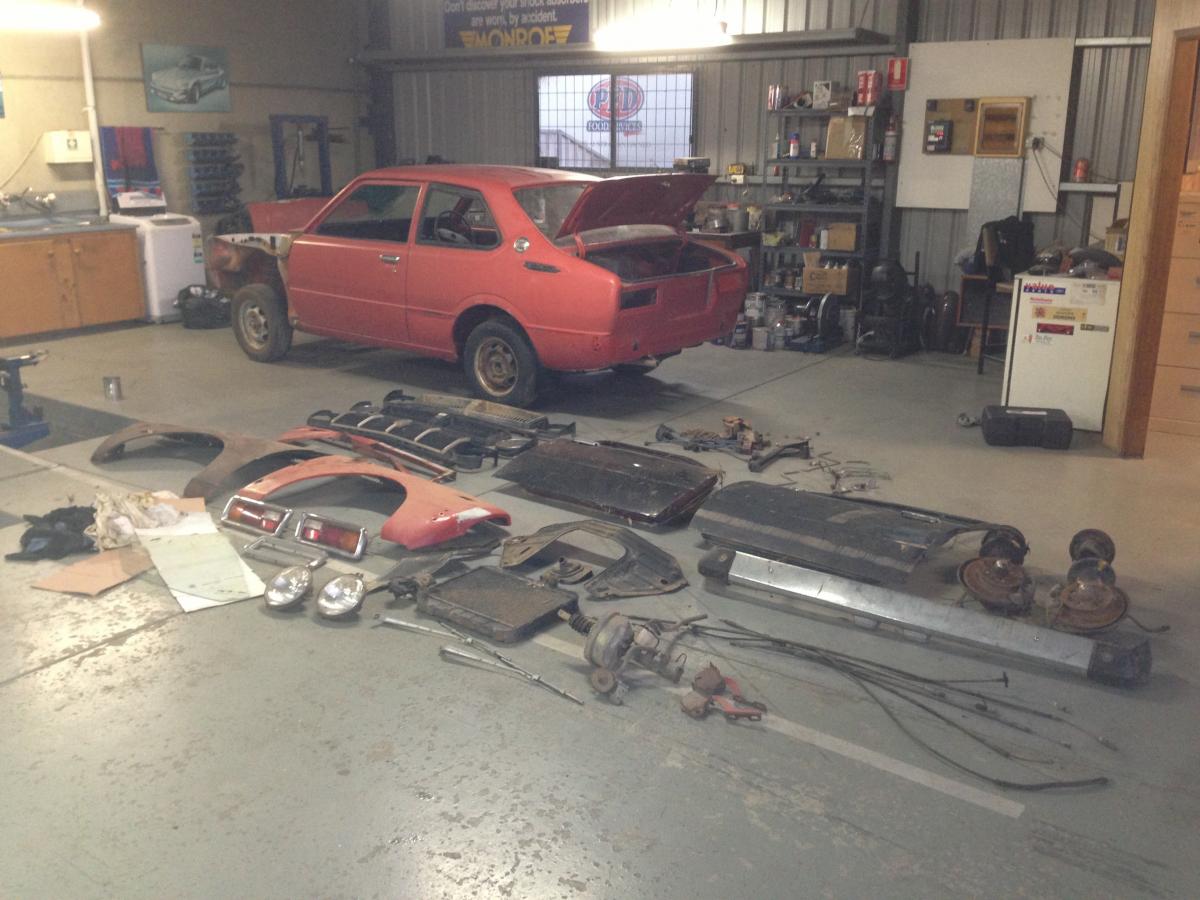

So am I, ill try my best to continue posting. The plan it for it to look like this first pic but with custom made front splitter. So far I have remove the tank and all the disgusting fuel, the entire loom and the fuel lines, will be going to Melbourne in the next couple of weeks to check out an engine, 2nd gen 3sgte with gen 3 ecu and loom rebuilt and converted to rwd with 5speed supra box, then I will get myself a tig and seam weld every little bit of the car

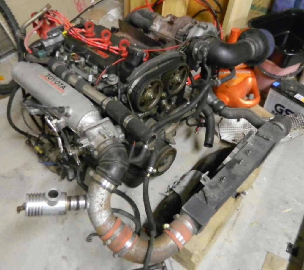

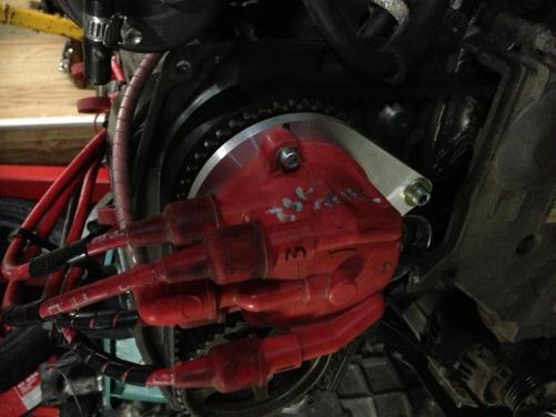

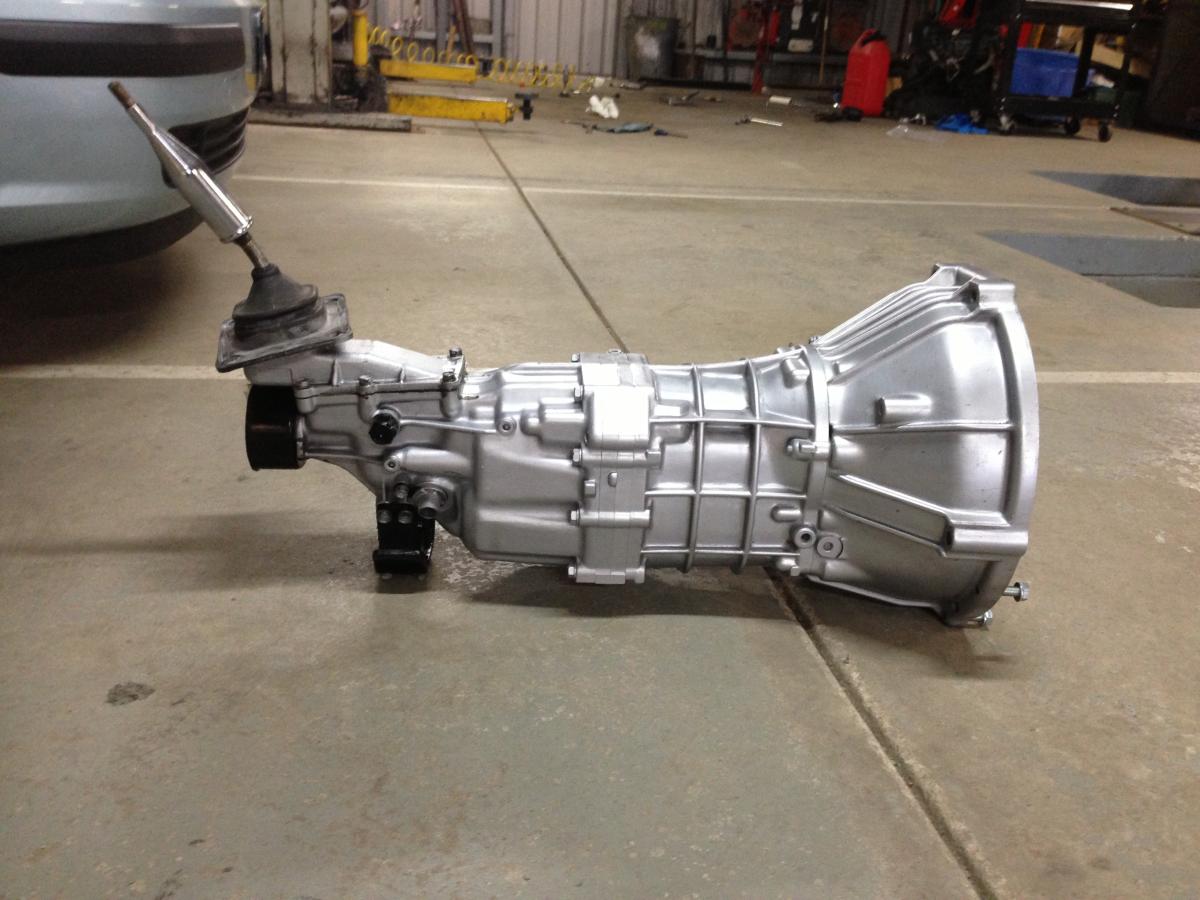

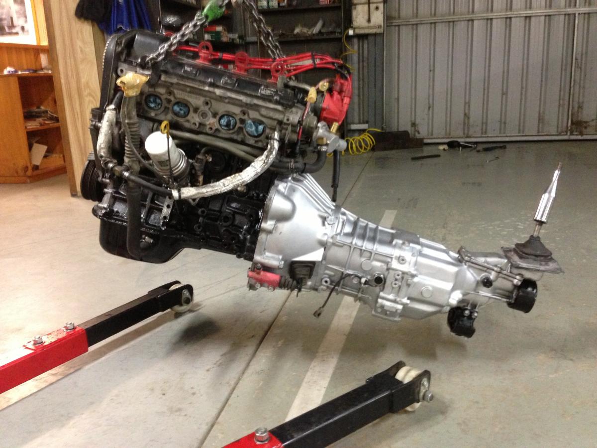

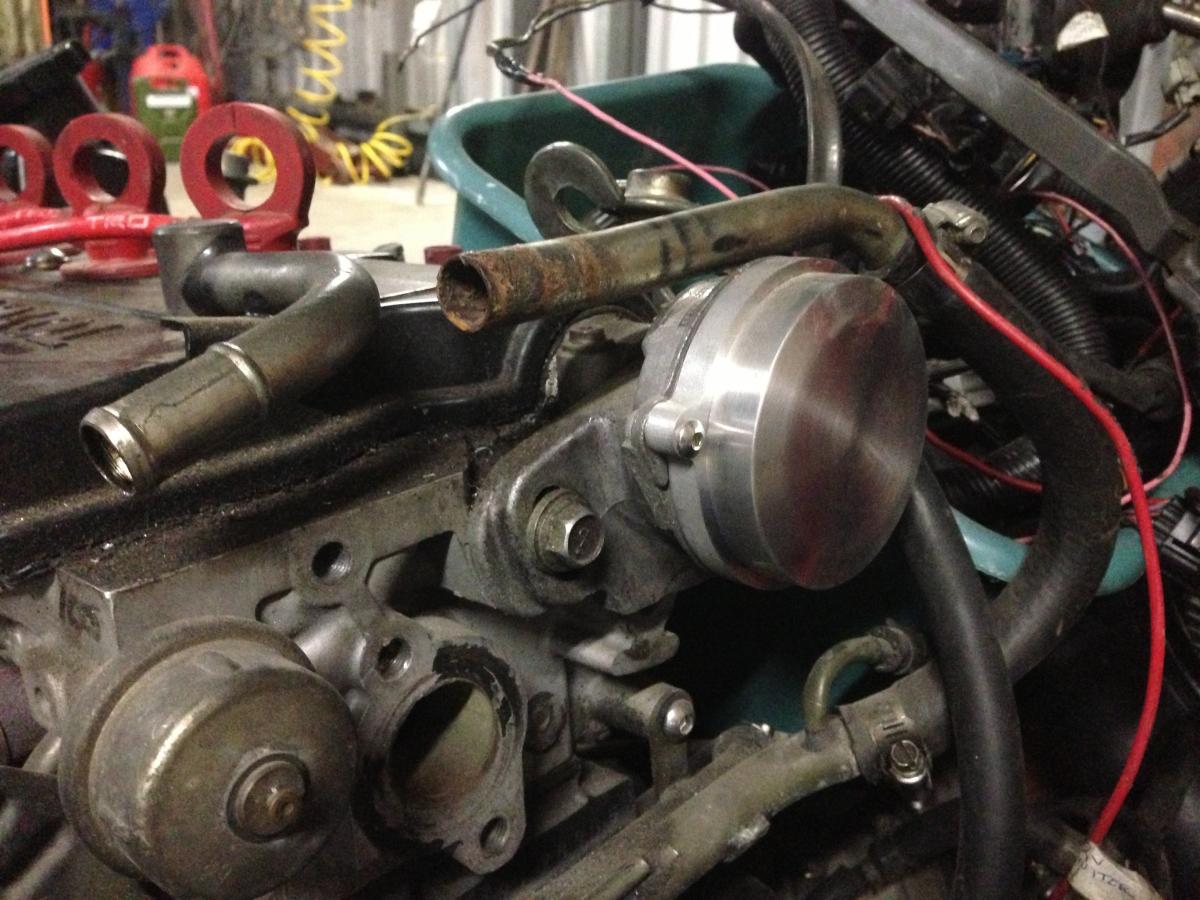

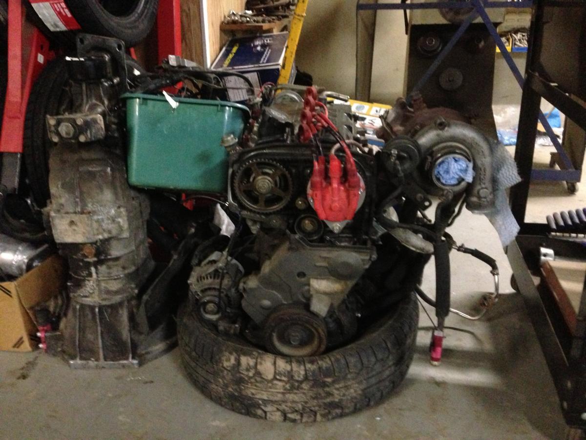

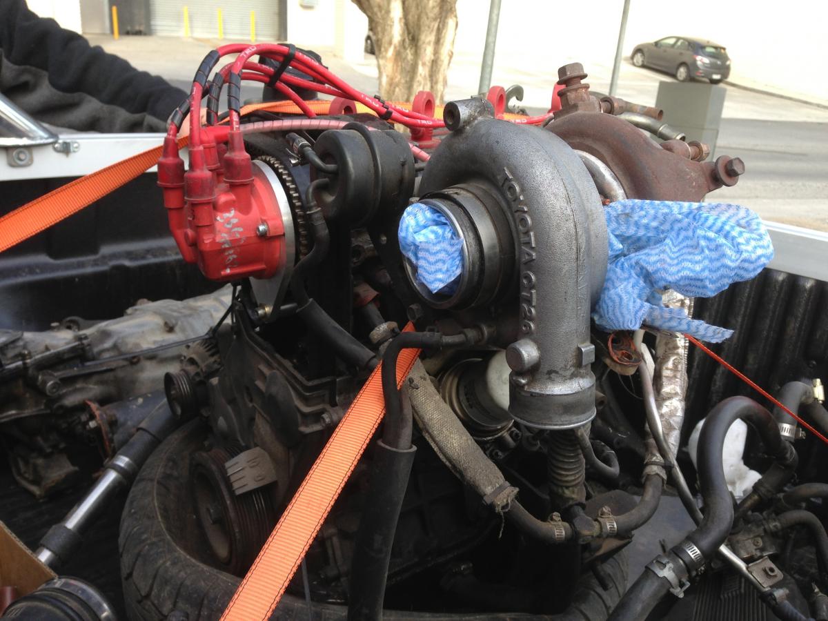

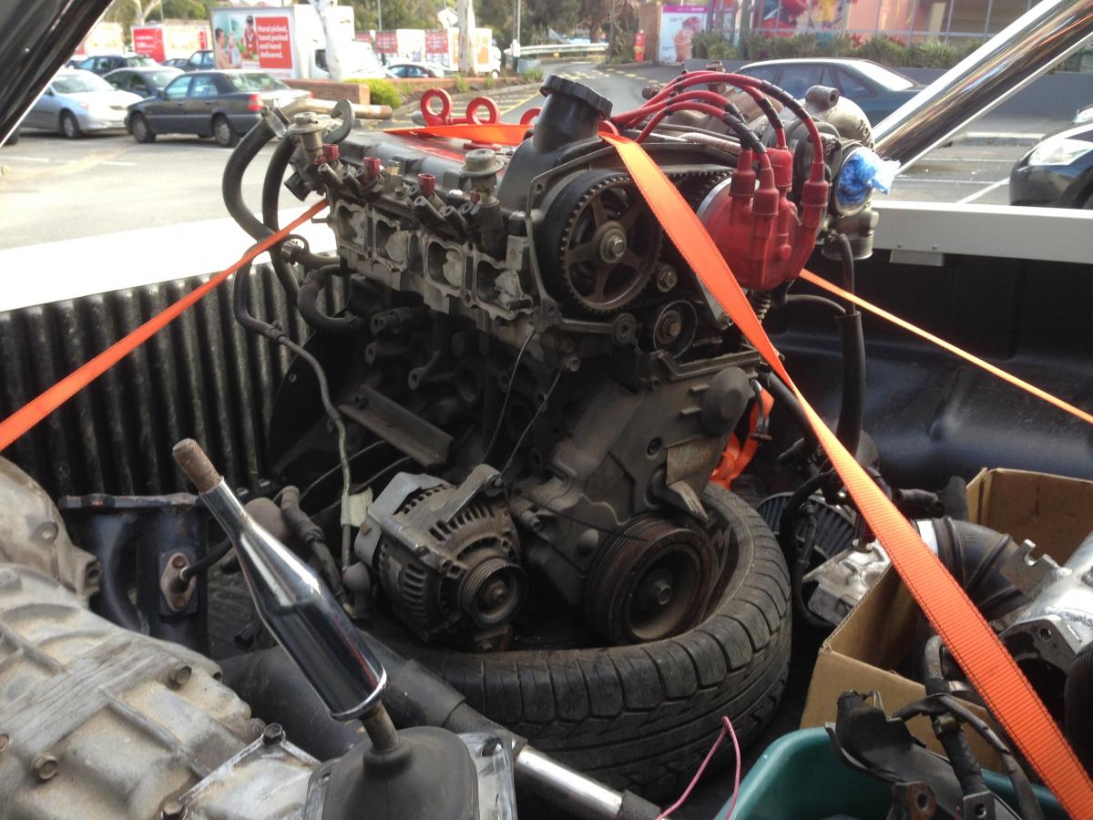

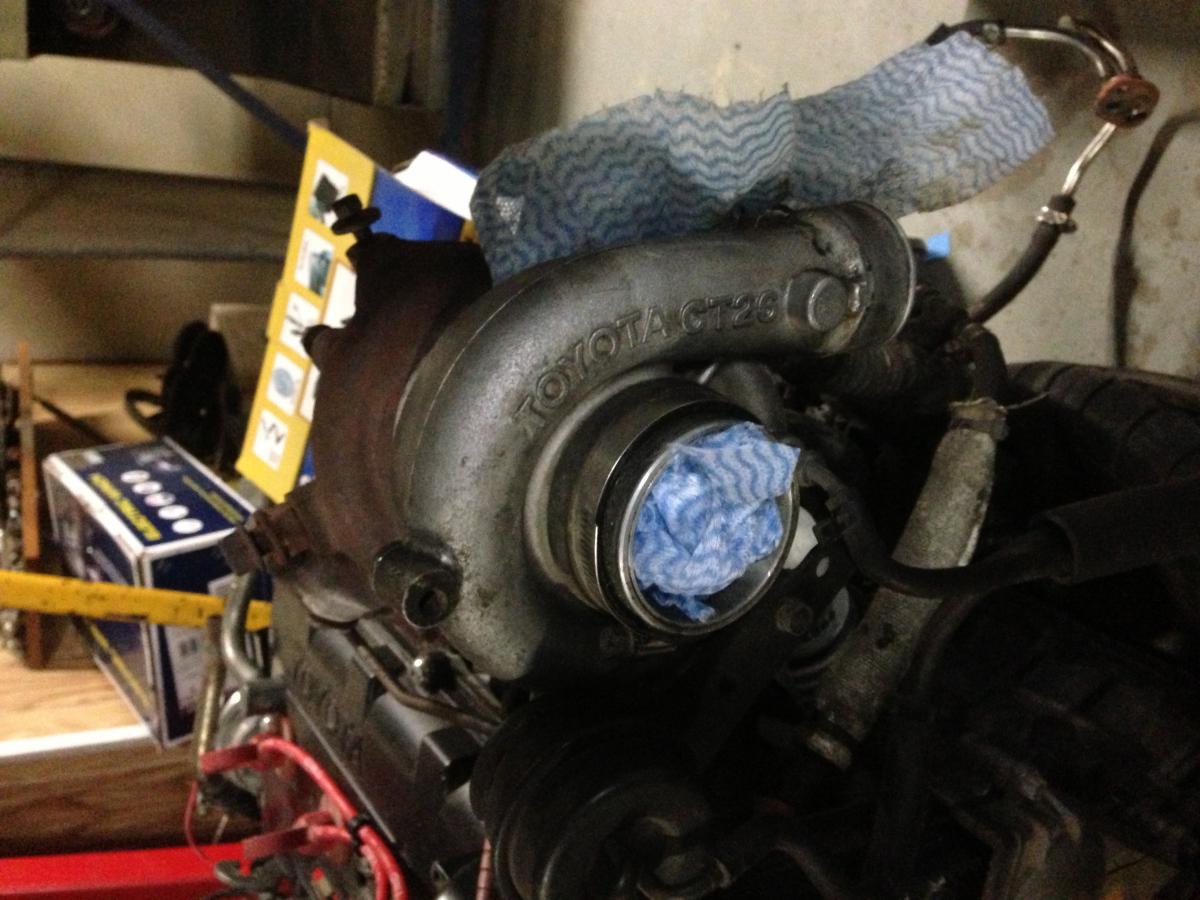

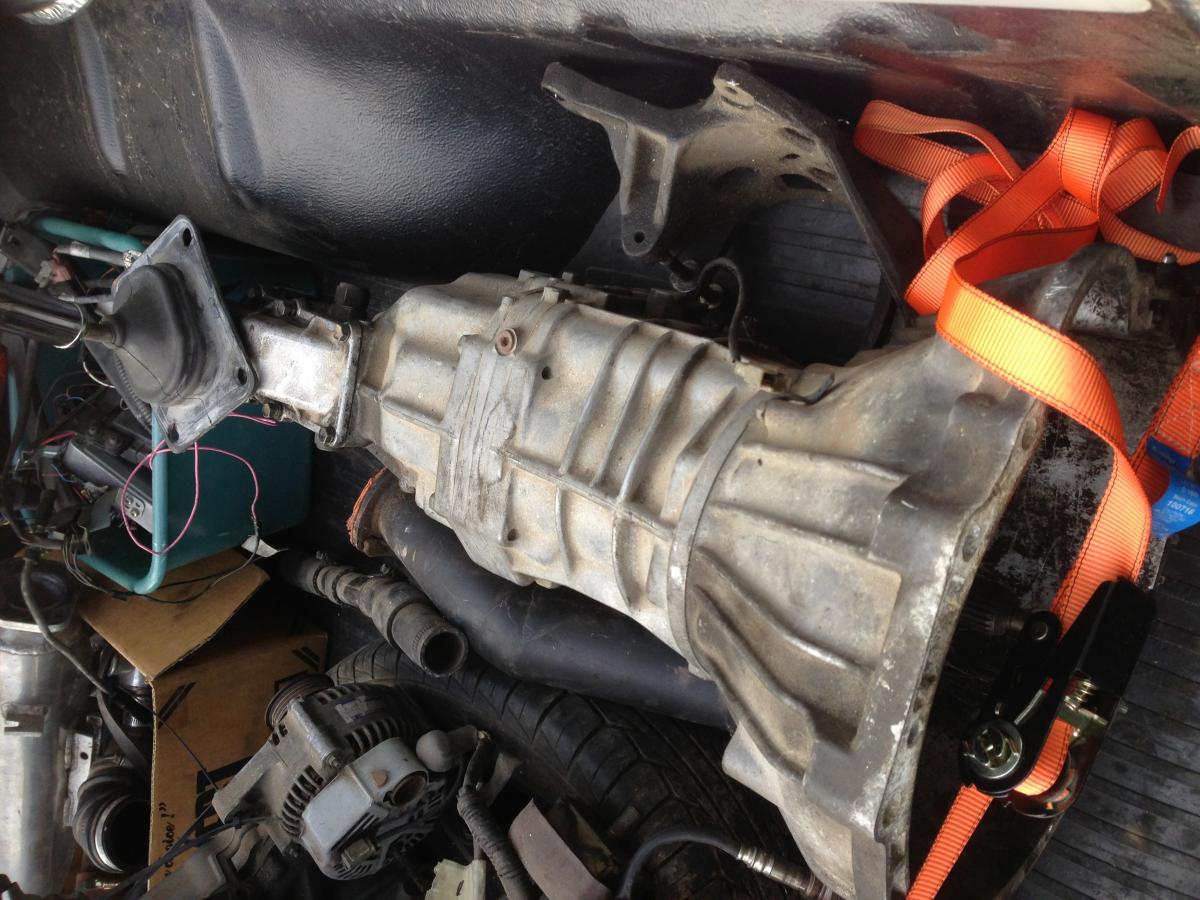

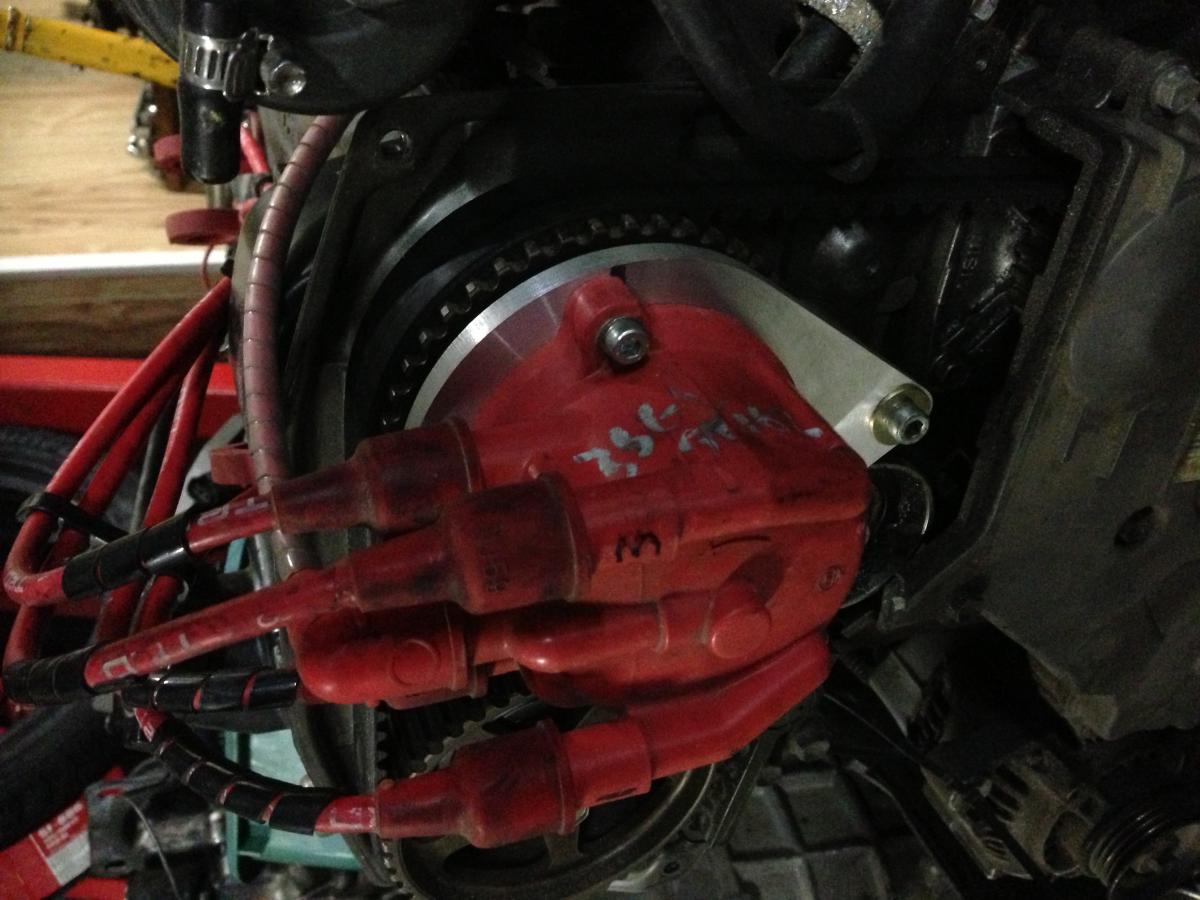

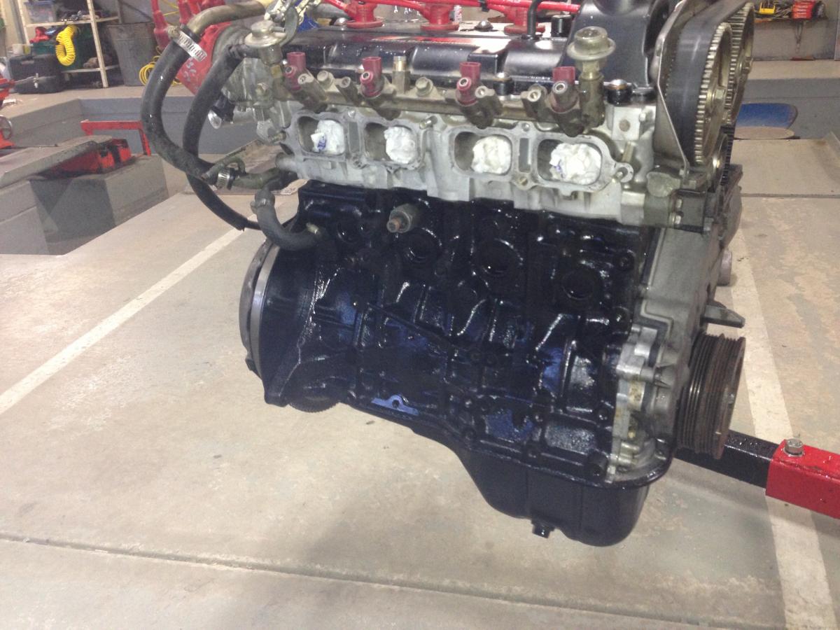

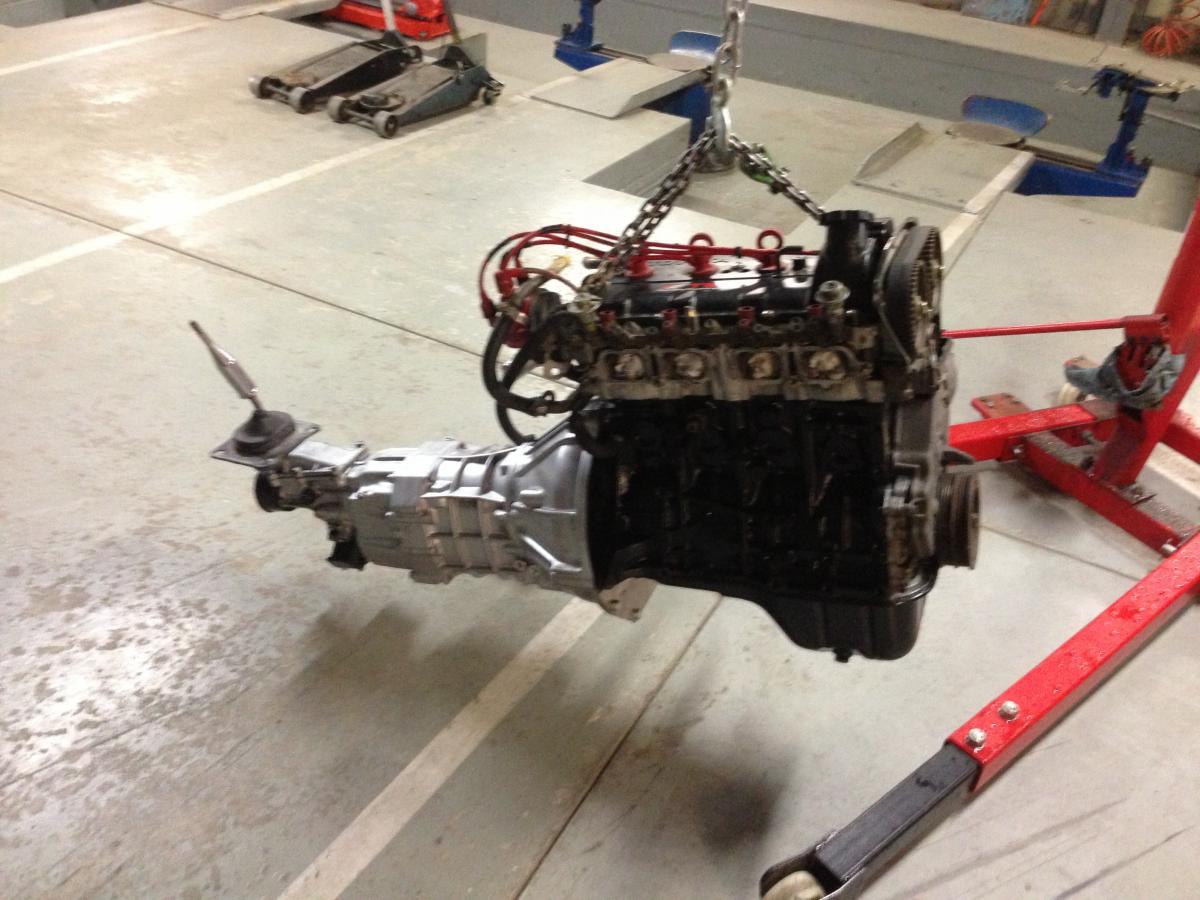

Bought my engine yesterday, 2nd gen 3sgte rebuilt with low k's, gen 3 ecu and loom, loom has been modified to remove all the useless bits and keep it simple, custom flywheel, gear reduction starter motor, 2s sump and bell housing, supra 5 speed and a custom distributor relocation kit. All that for $3,200. Now to get a tig and mount it

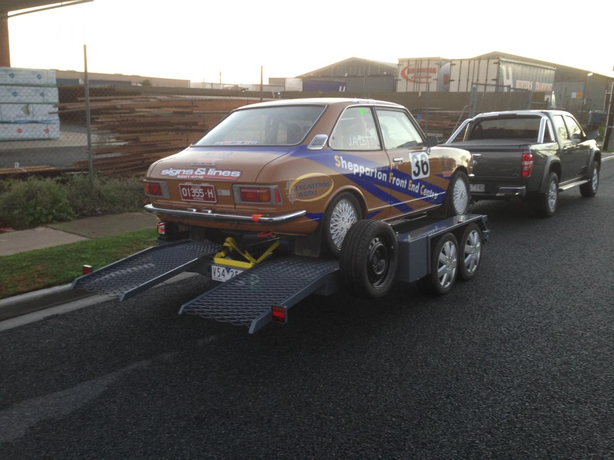

that looks pretty cool, should be a fun little thing when its done, i like the look of the finished car you put up, iv'e seen your ke20 at winton, i race at the sprints in my grey vt racecar, i love your ke20 it looks awesome!
Thanks mate good to hear more people liking it rather than complaining about it being "poo brown", I'm expecting good things from this ke30 when it's done, you'll probably see it when it's done, maybe late next year

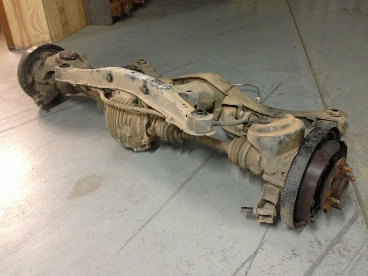

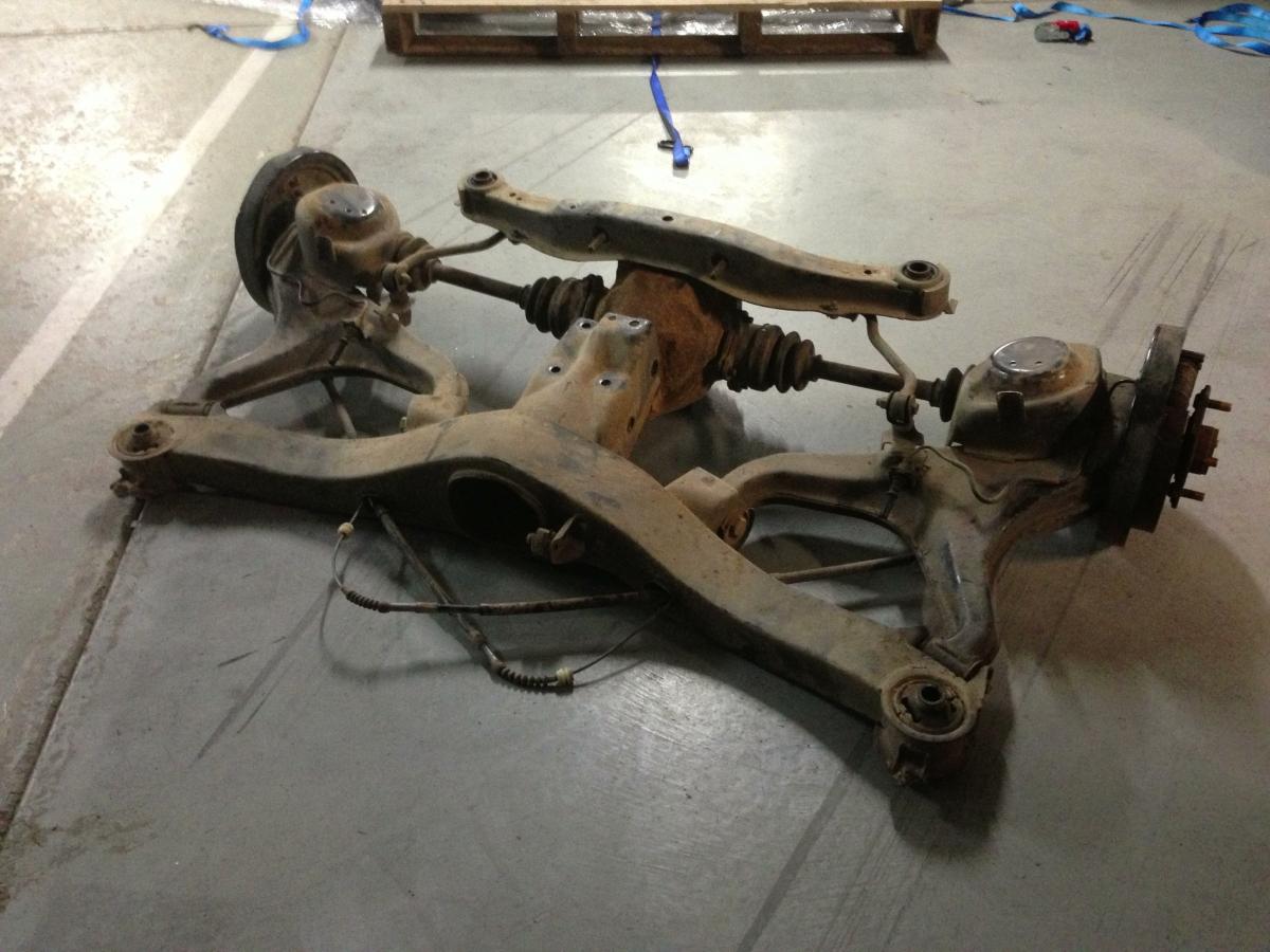

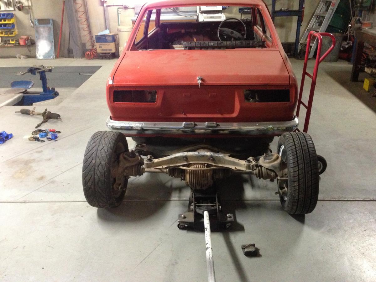

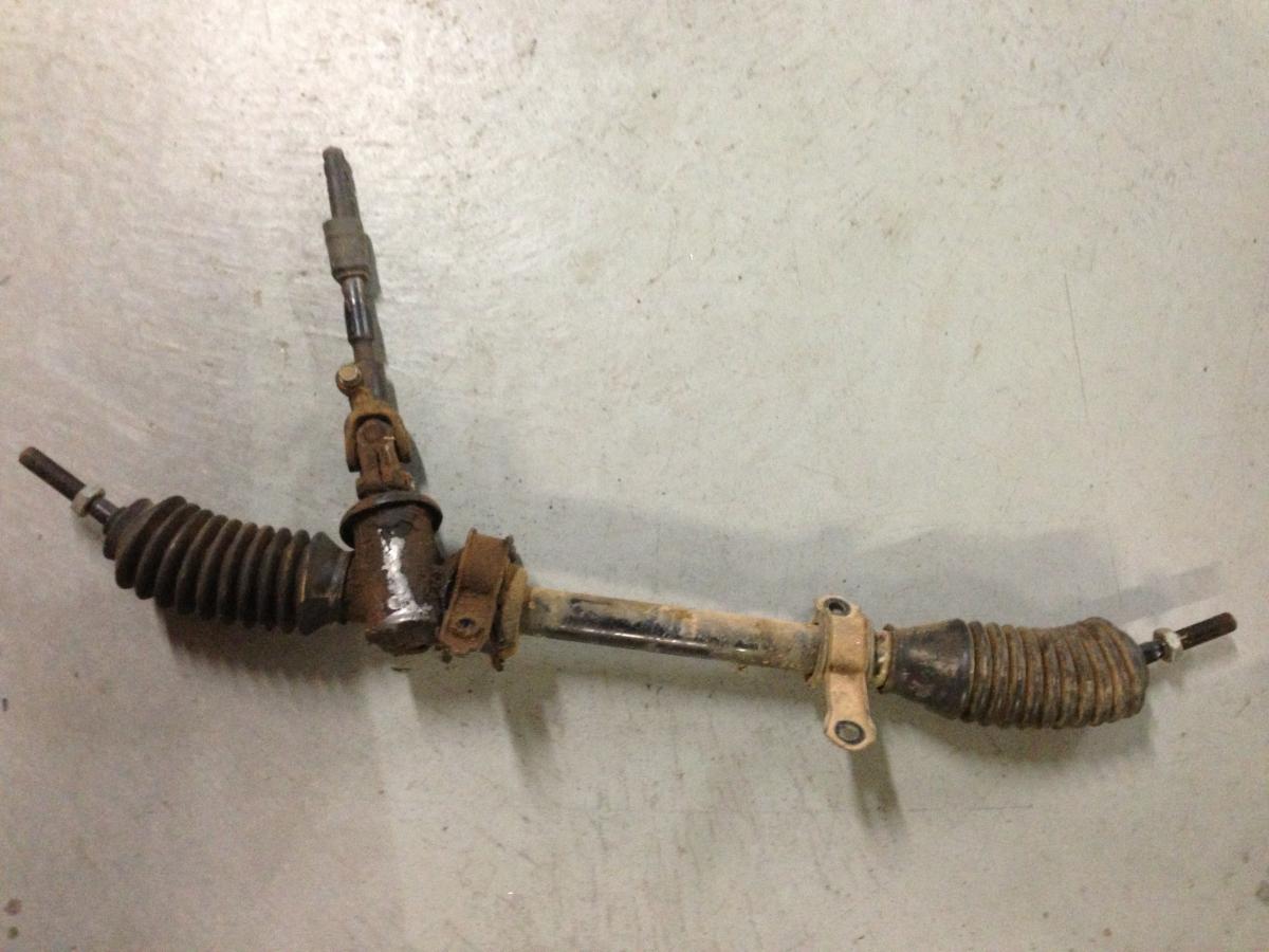

Got a ke70 steering rack last week for the car and yesterday the rear end turned up. I changed my mind on the 4 link commodore rear and got a complete independent rear from an ra65 celica. Now I can have a bit of rear stance haha. Thinking about mounting the motor this weekend and get onto seem welding the car over the next month and tackle the rear end. Should be fun

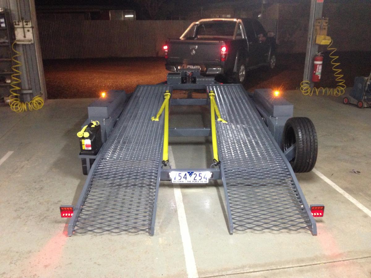

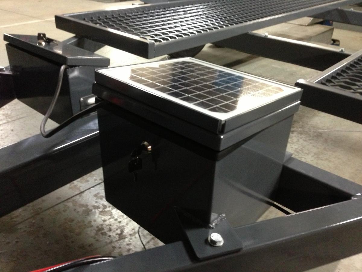

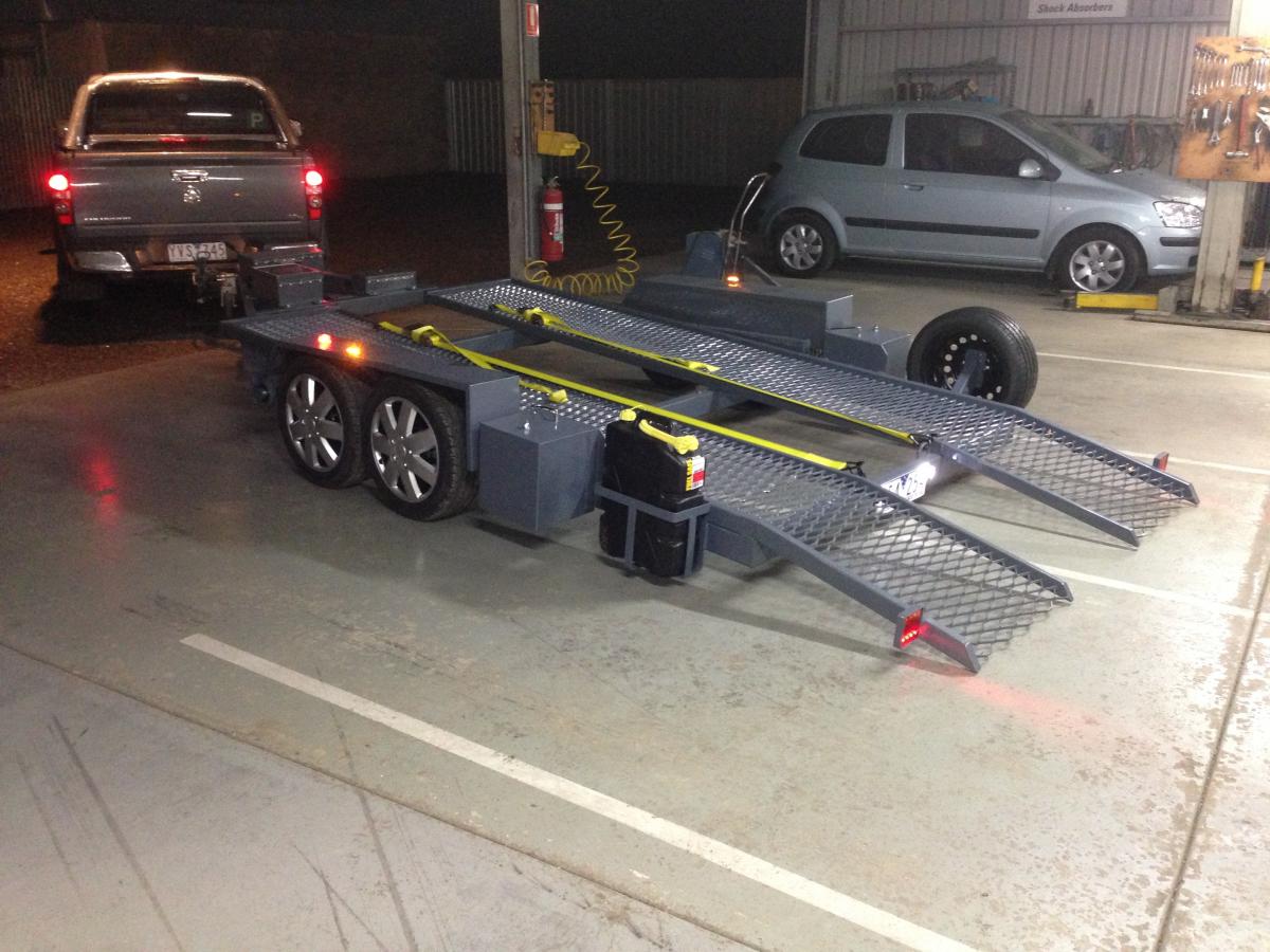

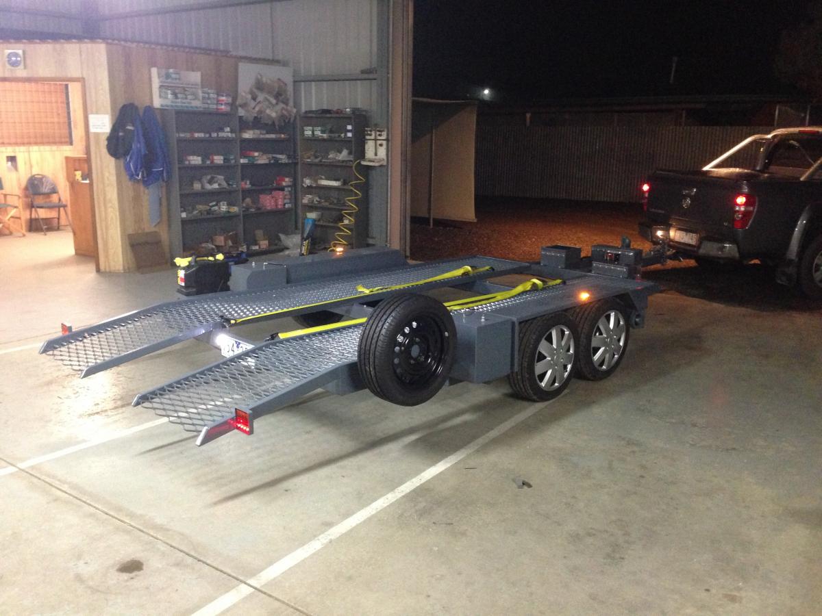

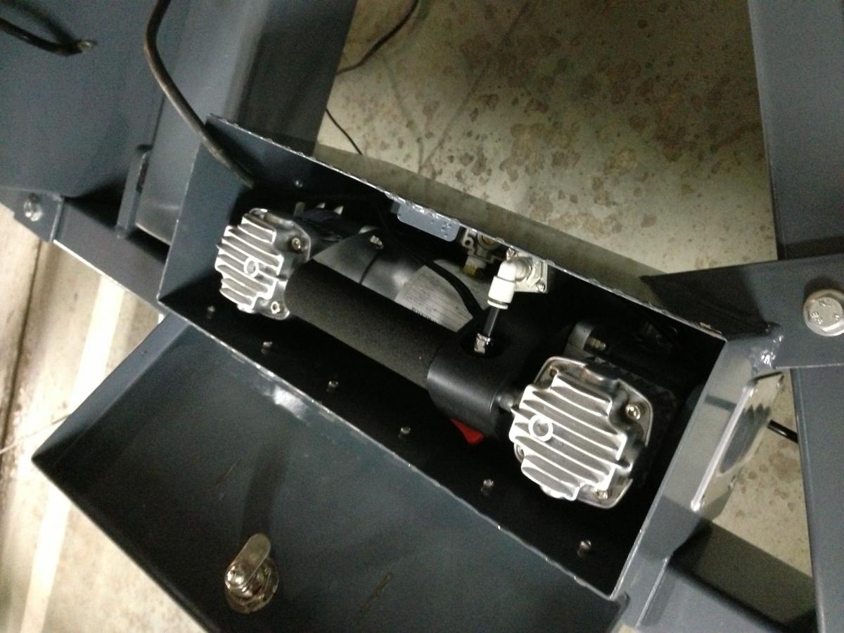

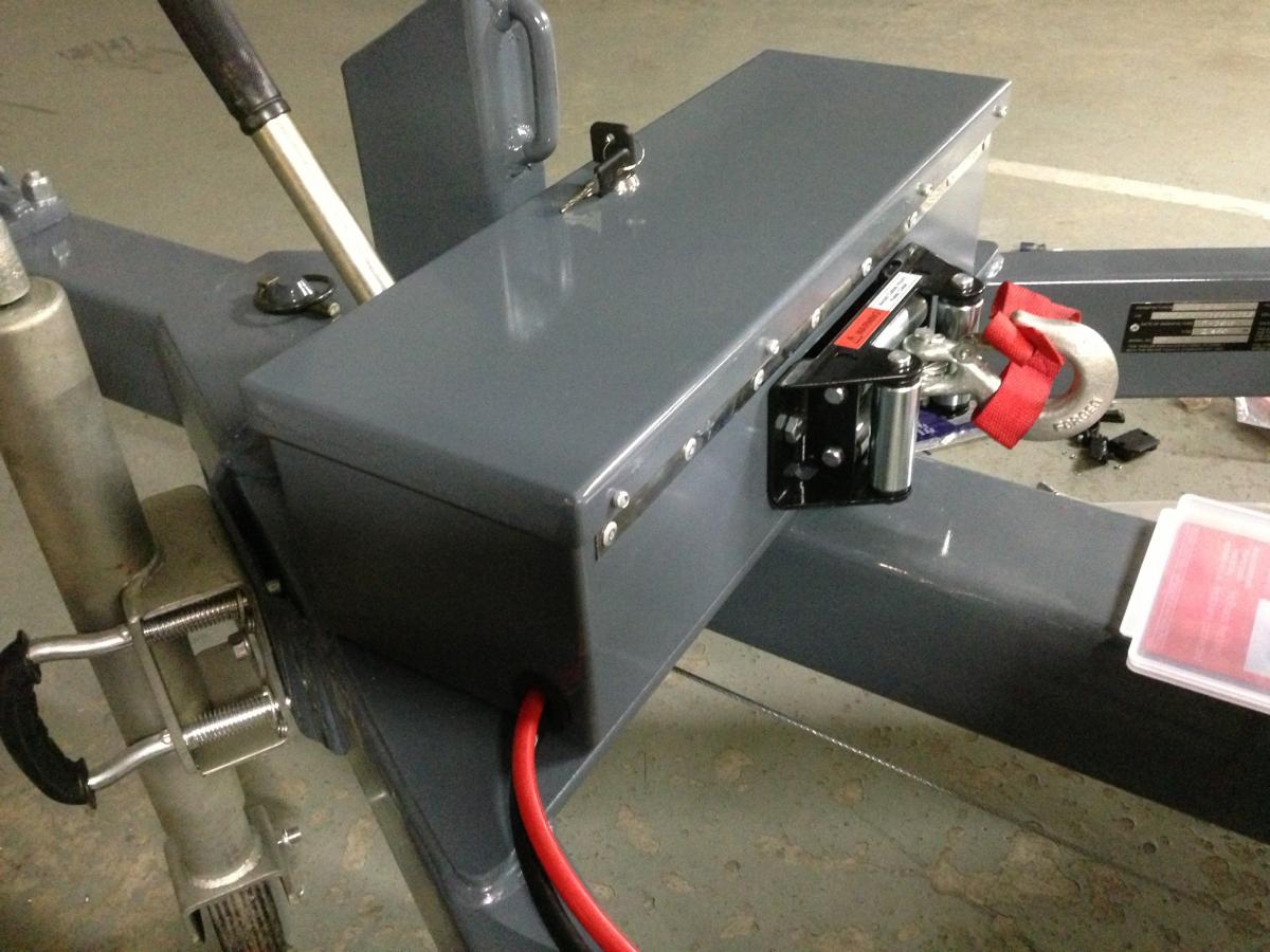

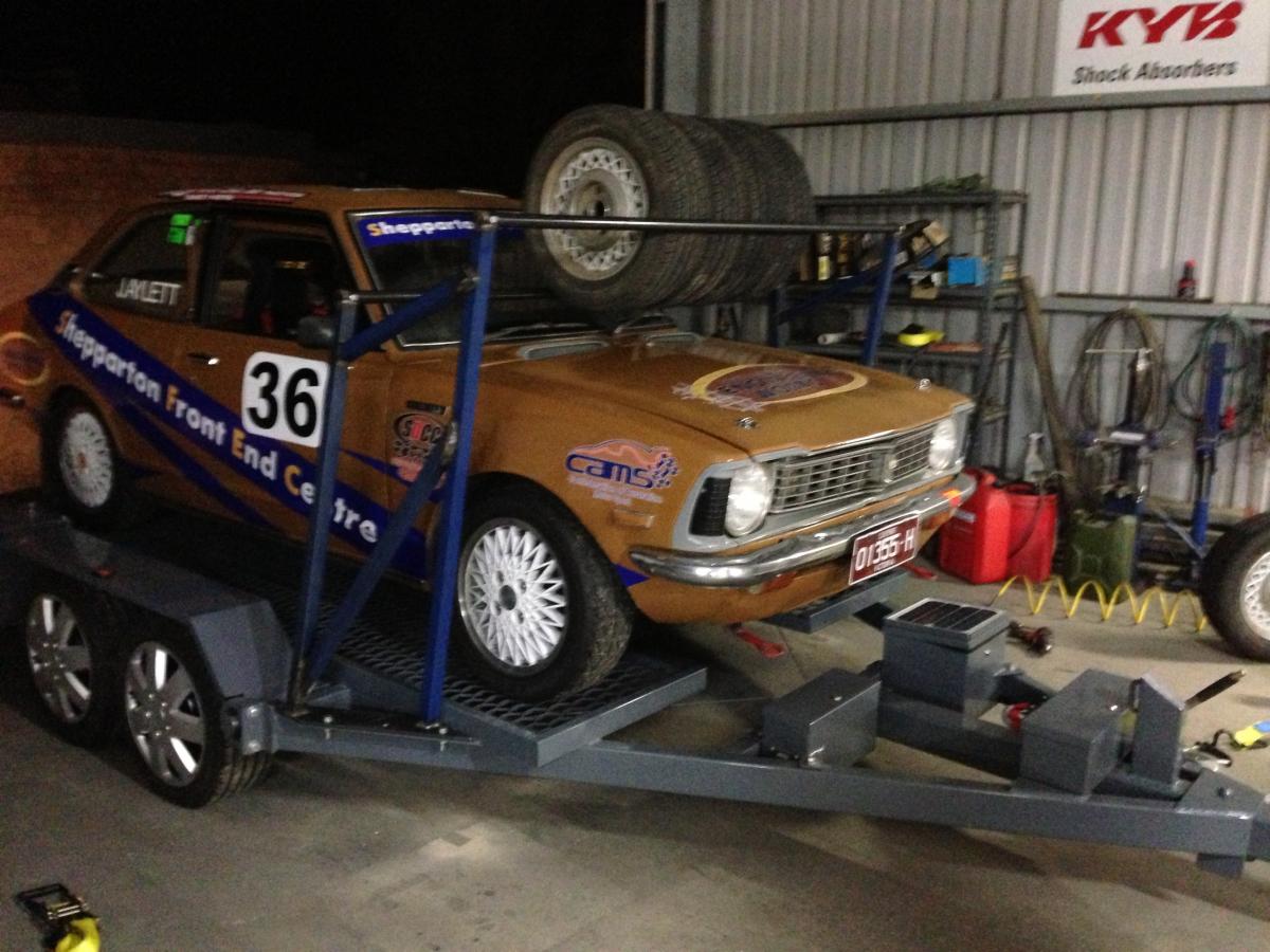

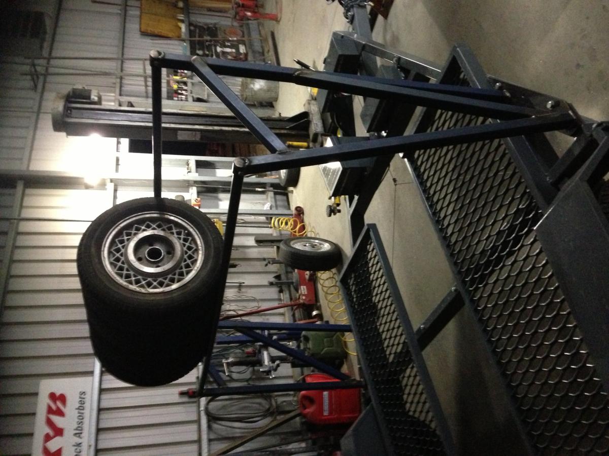

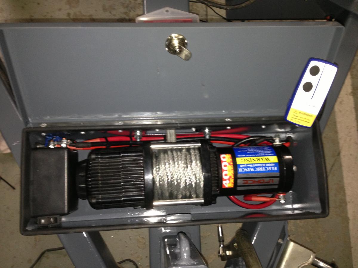

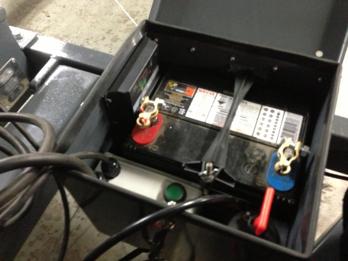

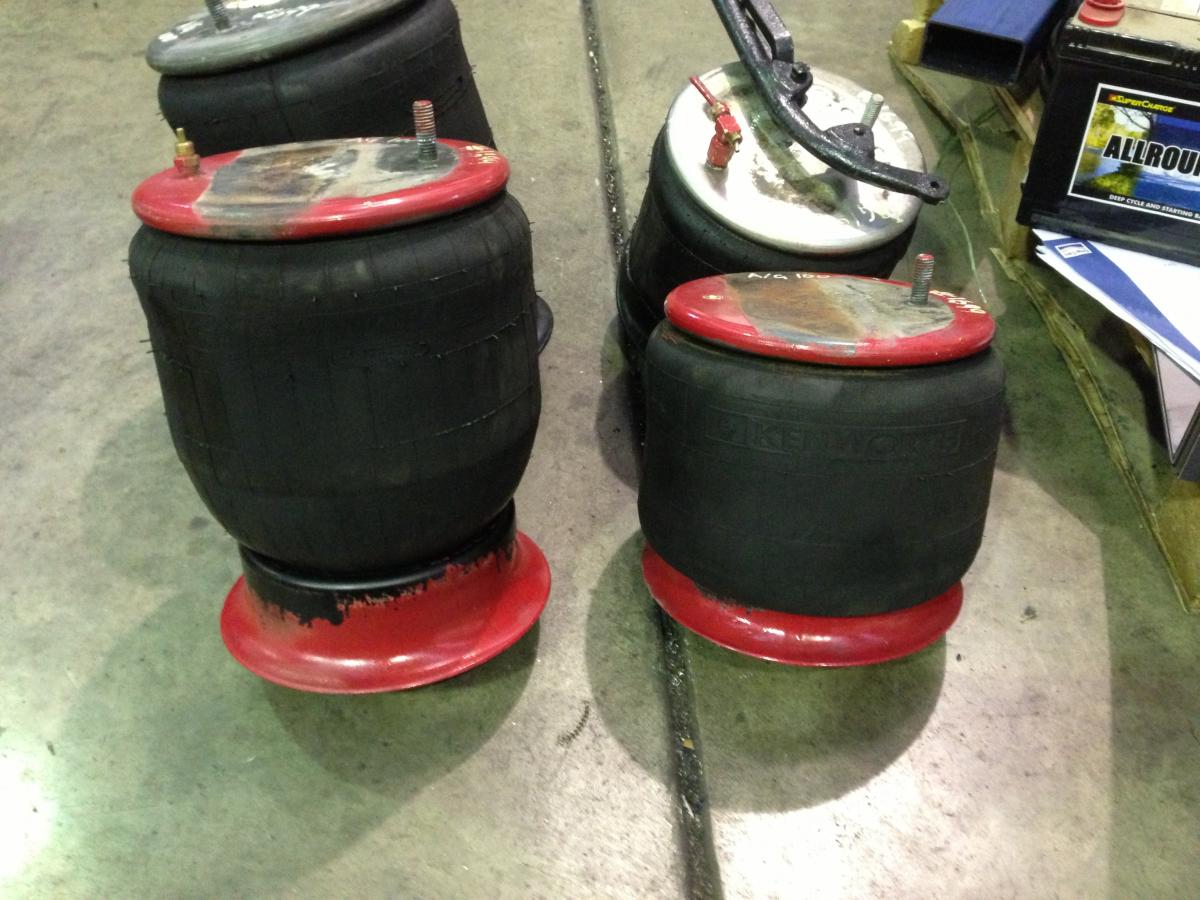

Just finished building myself a new trailer 3 weeks ago too to haul the cars around on, I copied the tilta trailer idea but made everything bigger, 3 and 4mm box for the framing, Firestone airbags from a kenworth prime mover, twin cylinder compressor, 4000lb 4x4 remote controlled winch, full size super charge car battery, marine solar panel, remote control for up and down controls and a tire rack for only $2,789.31 including paint, rego, everything even the way bridge fee where it came in at 600kg

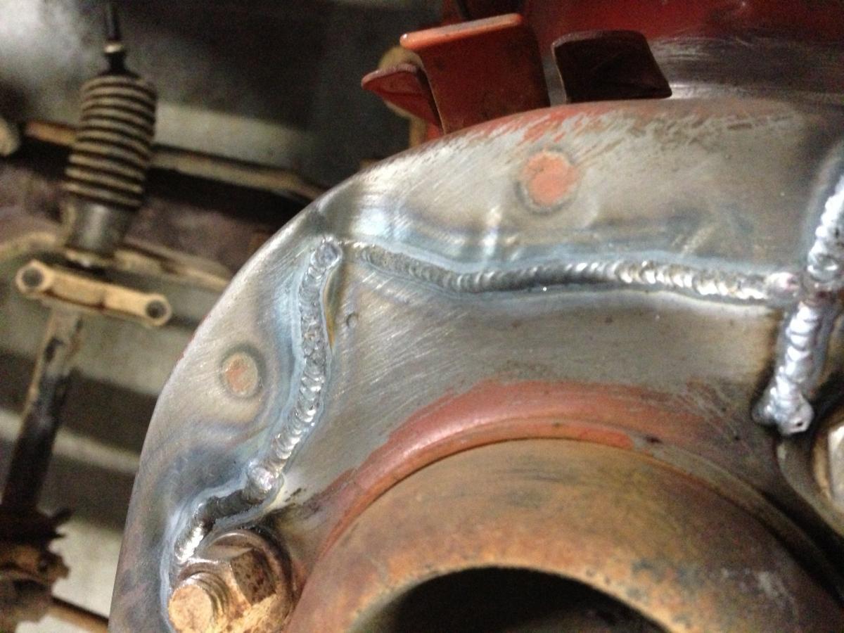

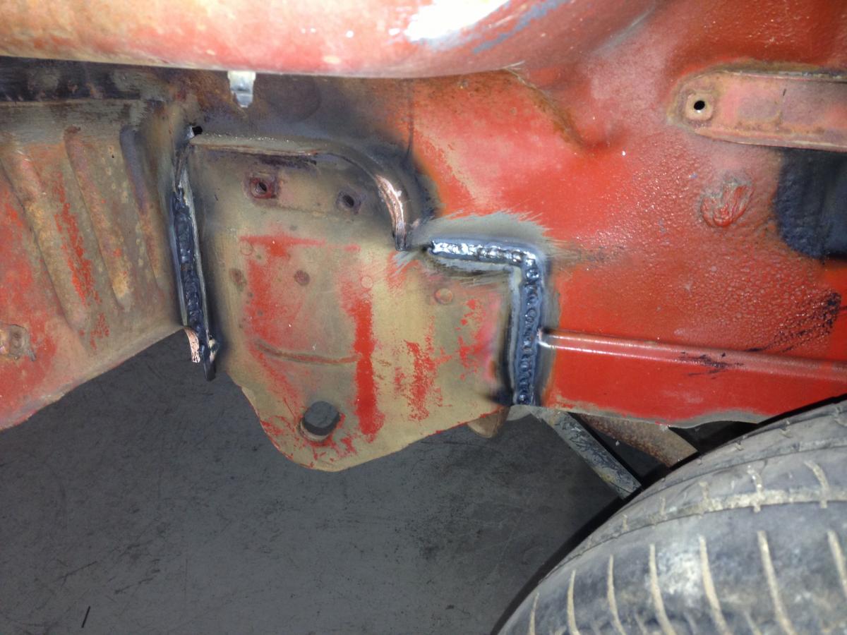

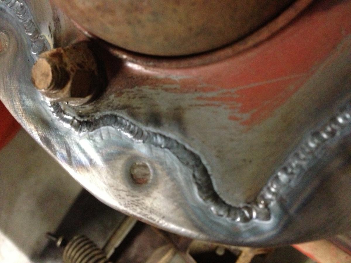

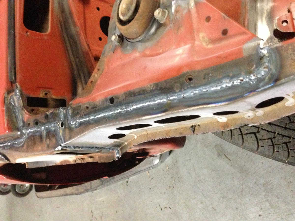

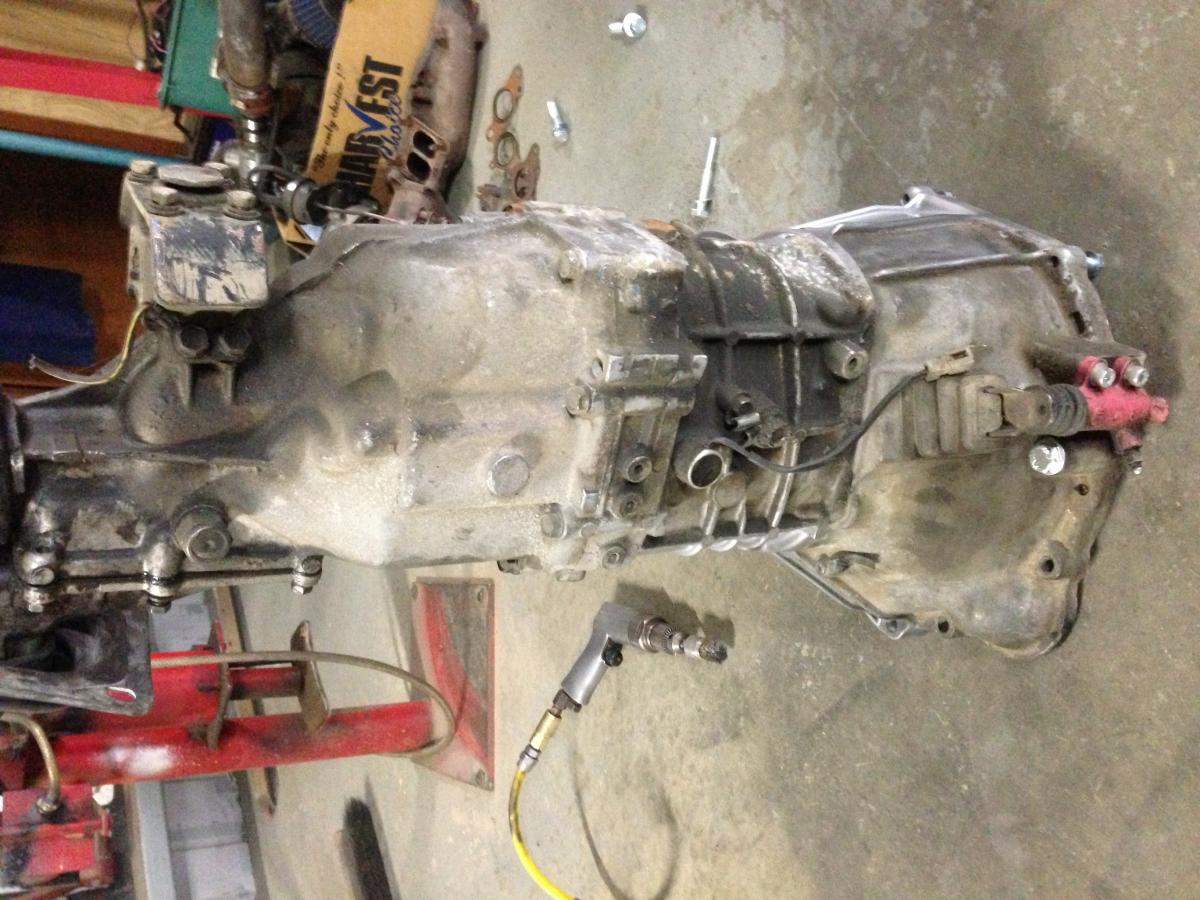

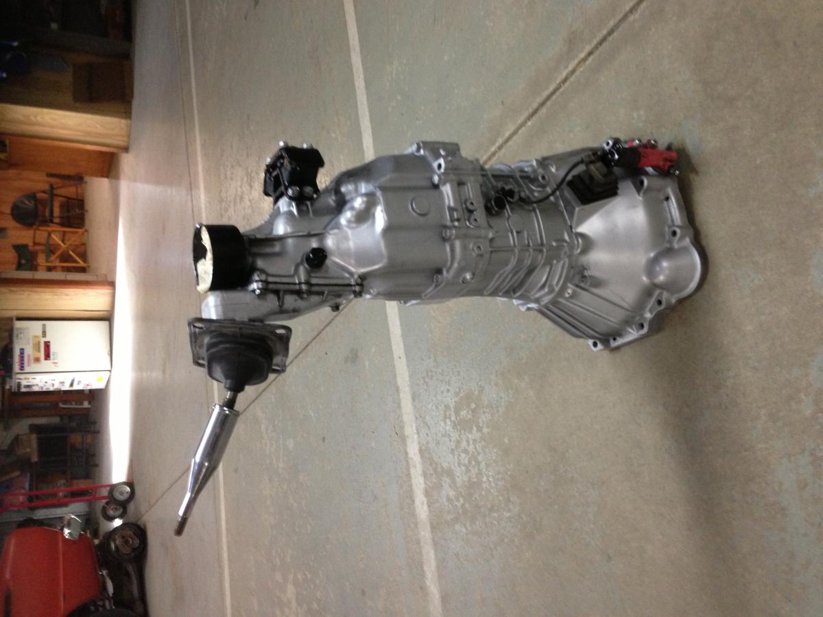

Did some seam welding on the front of the car last weekend but my tig skills aren't real flash so my brother is doing all the bay (all the visible welds). Today I cleaned the motor and gearbox, painted them and bolted them together, will mount the engine tomorrow
